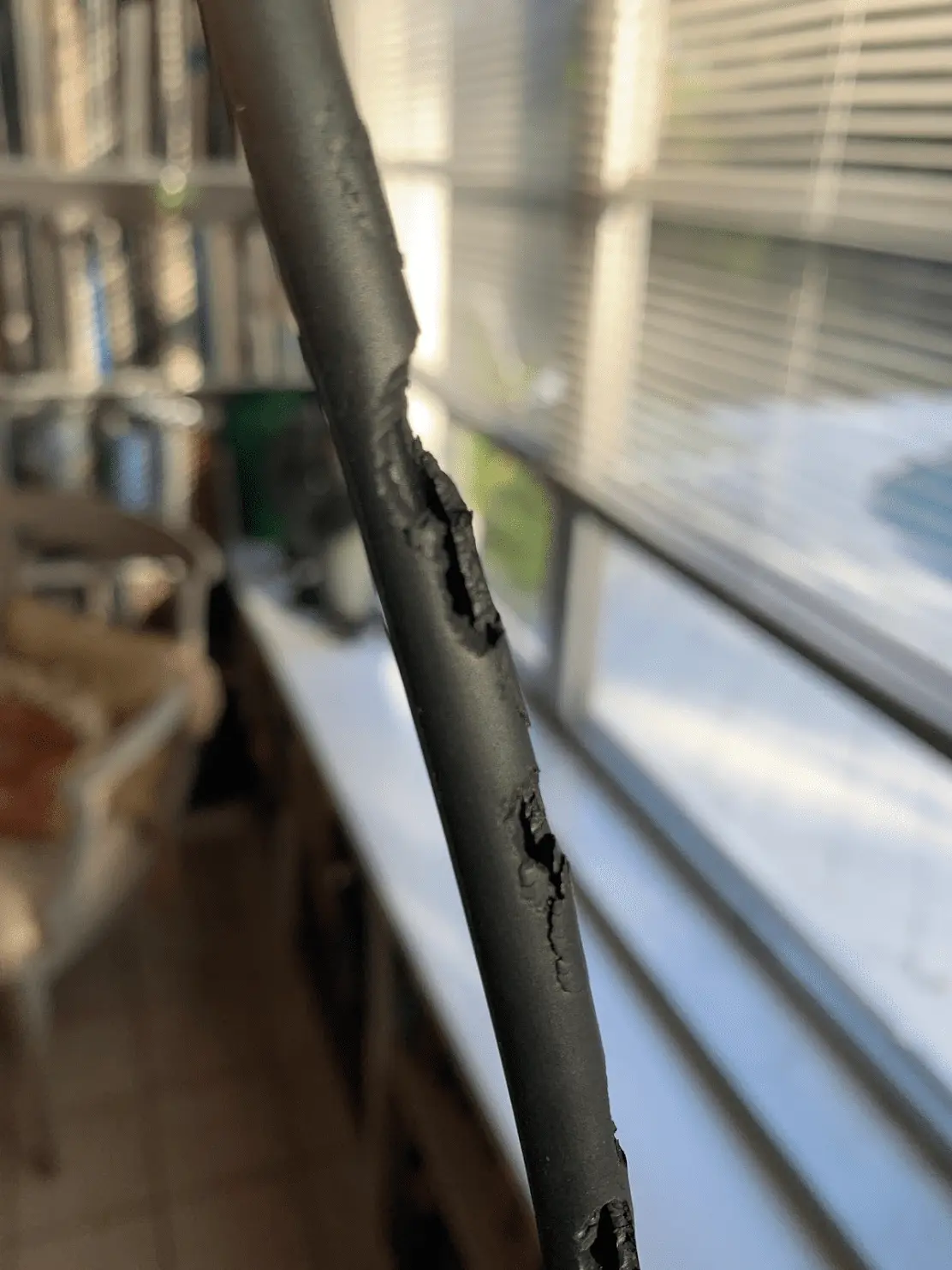

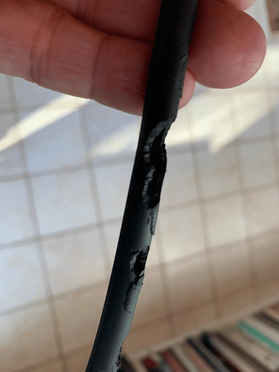

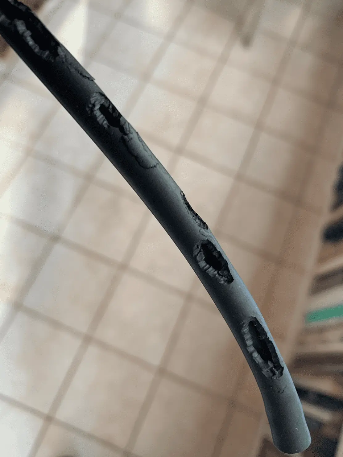

I recently had rodents eat parts of the plastic near the windshield, and caused major damage to water tubing for the windshield washer system to the point that I have to replace all of it… expensive repairs. Today I sprayed a mix of peppermint oil and water around the engine area and will wait for it to dry. I understand there are spray products made specifically to mitigate rodent issues in cars, and they're based on peppermint.

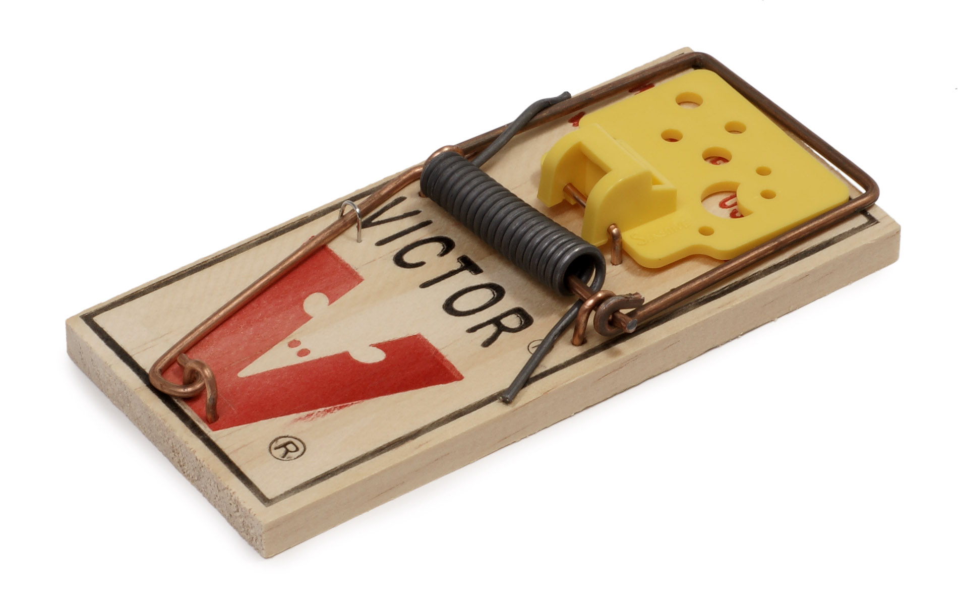

You gotta put out the original old-fashioned snap traps, placed pointing at the walls like this:
Mice always run next to the walls for cover, rarely out in the open unless they're making a dash for their next cover or target destination.
I would also place these traps under the car pointed to the inside of the front tires (one for each front tire), just as the above is pointed to the wall. Mice are likely climbing up the inside of the tire to get under the hood.
Do not get this type of snap trap:
See how close the trip paddle is to the edges? A mouse can trip the trap and only have the tip of its snout crushed and caught. It's messy, painful, cruel...and not lethal. That's not good for either of you.

I got my CX-5 back from repairs. $150 later and they replaced the windshield washer hoses that had been eaten by rodents.

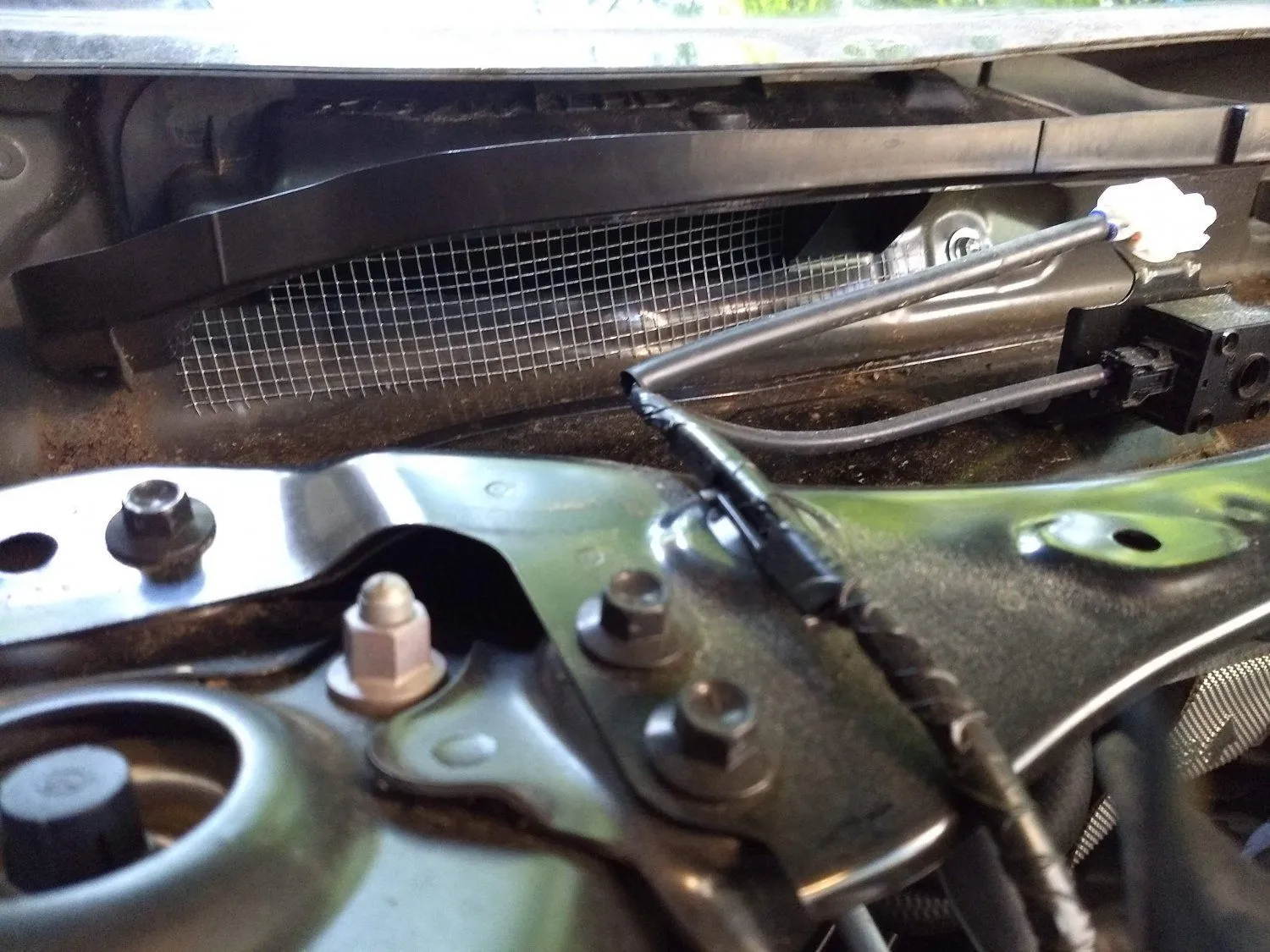

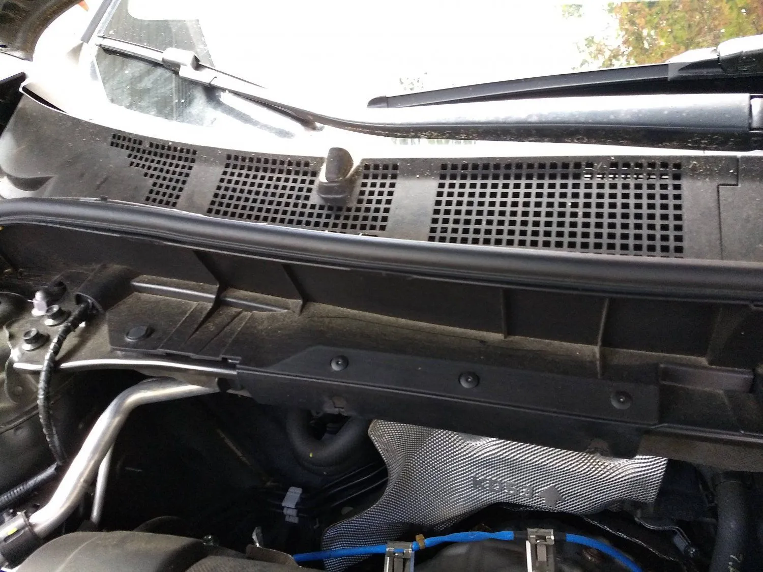

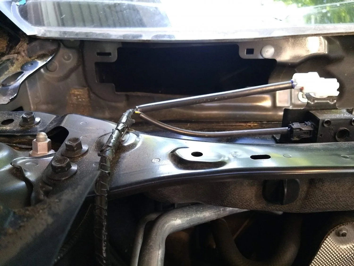

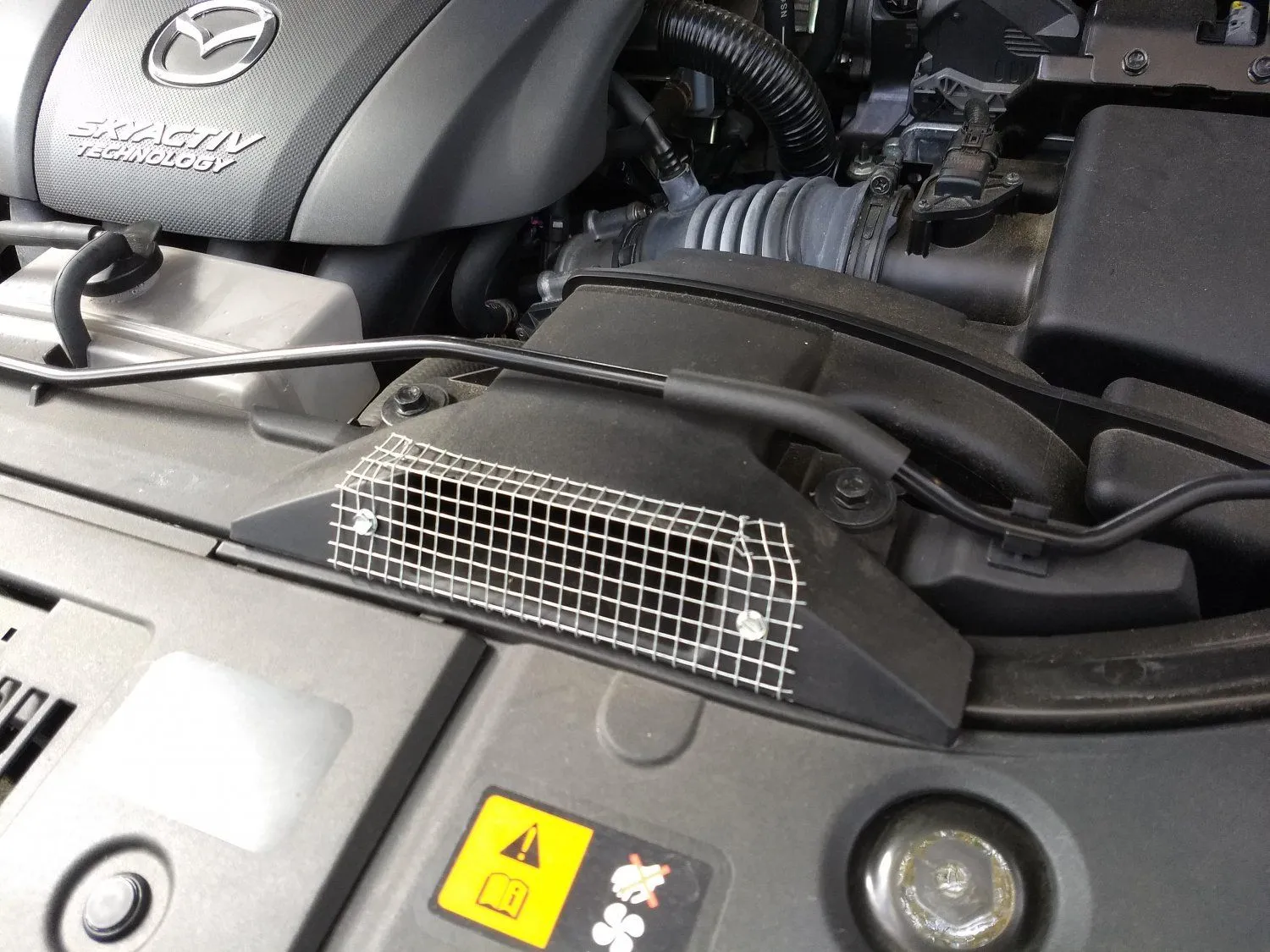

If you suspect you have mice, check the cabin air filter. They love to hang out there. I recently screened the firewall opening that leads to the cabin air filter. It is a relatively easy job because the windshield cowl is split so you just need to remove the passenger side of the cowl. There is no need to remove the windshield wiper arms. The pics show: passenger side cowl, opening to cabin filter air shaft, and the same opening with 1/4 inch grid metal screening. I also screened the engine air filter intake. I've had mice build nests in the intake of our Toyota so I wanted to protect the intake of the CX-5.
Mice were getting into my 2016 CX5 cabin air filter housing through a gap in the plastic housing for the windshield wipers. The gaps were near the hood hinges on both sides. I closed the gaps with crumpled aluminum foil held in place with acrylic caulk. That seems to have stopped them.
I also keep snap traps under the hood when I am not driving for a while to kill mice that might cause other types of damage. I put 1/4 inch hardware cloth over the air intake to the engine.
Mazda and other manufacturers need to address this problem. There is no good excuse for not making the two air filter housings (cabin and engine) mouse proof.
