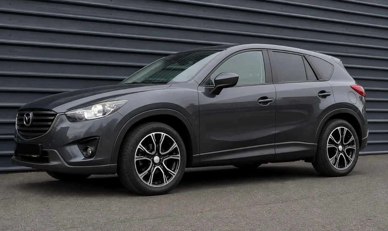

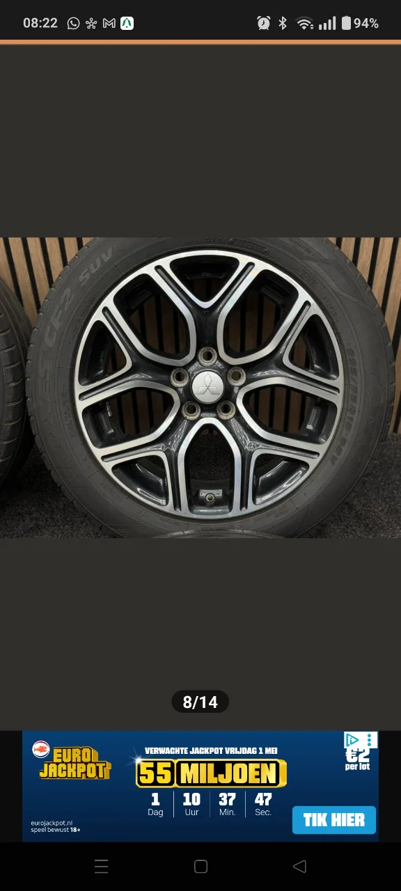

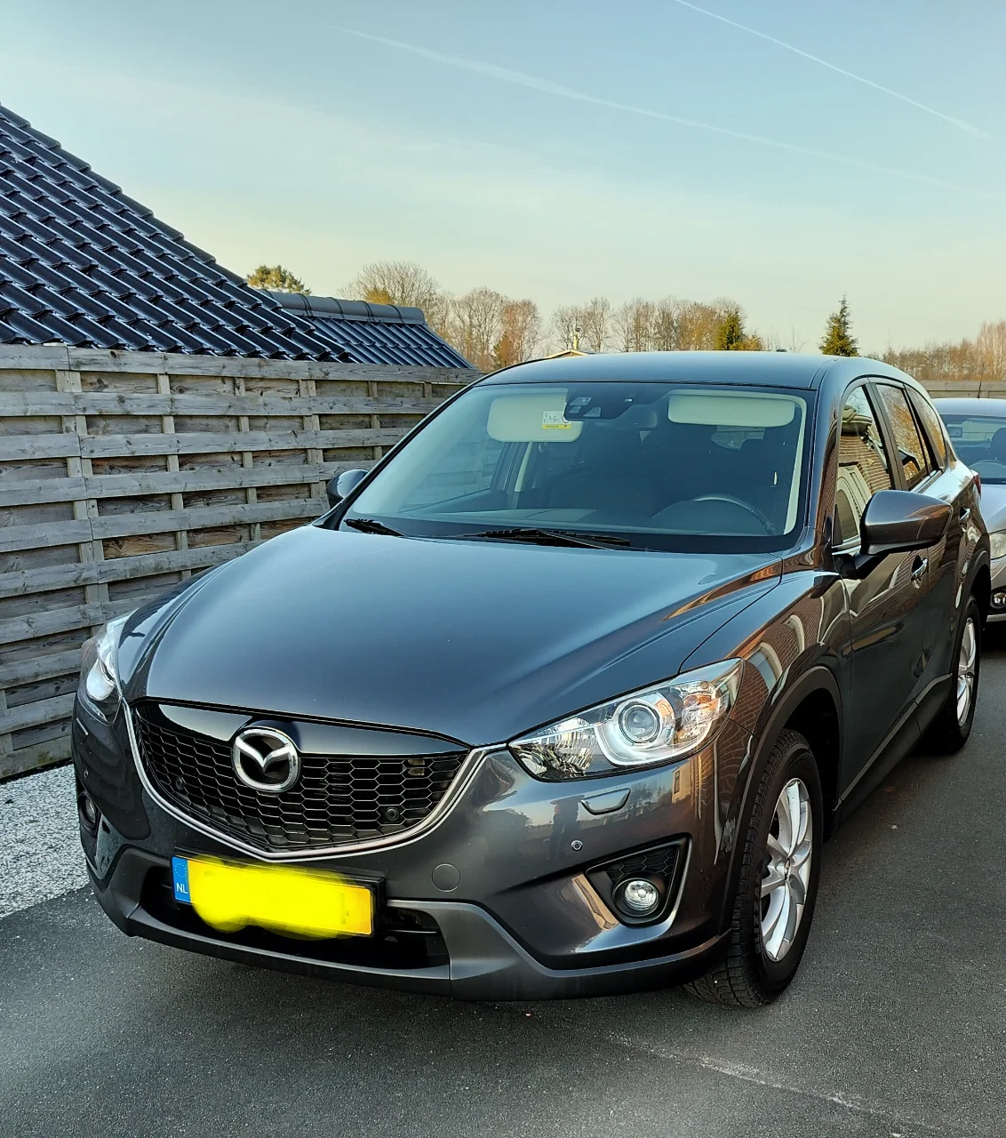

Do you have a picture?
Hereby the photos. Vehicle wheels combo is AI generated, but looks nearly similar to what it will looks like in real life.
I think it looks great.
