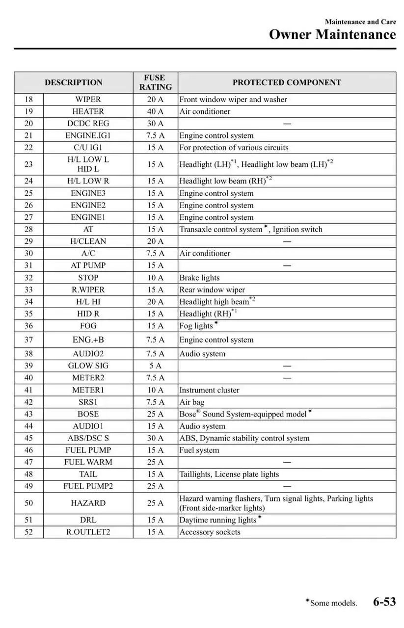

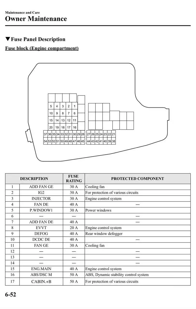

I assume you have manual 3-dial HVAC system on your 2014 Touring. Based on your description you should check the fuse first. This’s from 2014 CX-5 owner’s manual:
Check fuse #19 and #30 on fuse block in the engine compartment. Verify the fuse location listed on the place card on the fuse block.
If you see the AC compressor kicks in while you have the AC on with the engine running but no cold air from the vents, it can be blower itself, or the blower resistor pack blown. If the fan can be on ONLY at the maximum speed, the resistor pack is the culprit. My guess is the blower itself but you may have to remove the glove compartment and test the blower fan and resistof pack with multimeter. Both are fairly easy job to replace.

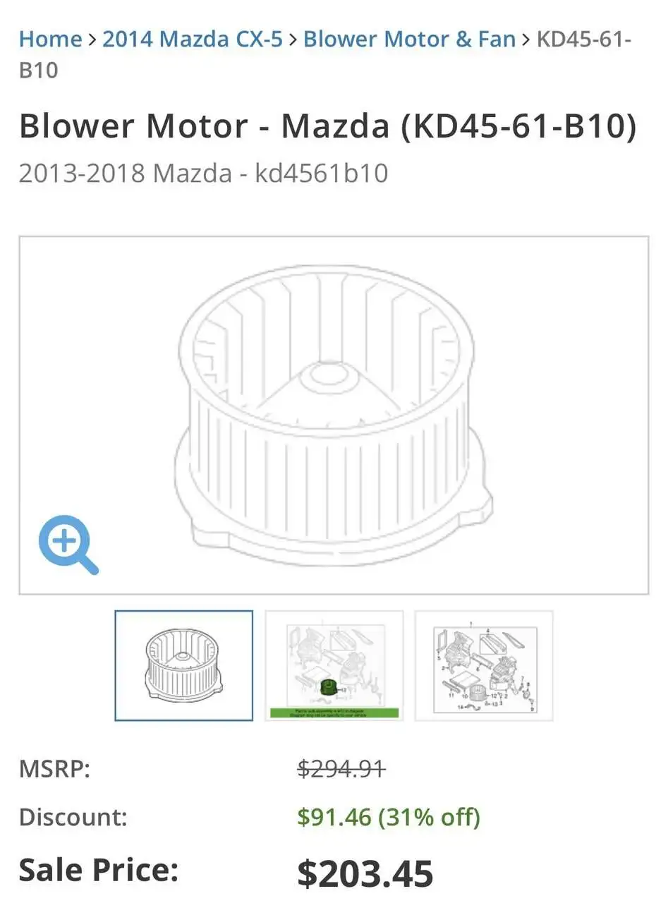

At least you’ve confirmed that the problem is your fan motor. Since your 2014 CX-5 has some age now, don’t pay $203.45 for an OEM blower motor KD45-61-B10, but get one from Amazon or some other places for only $37. Return the one you don’t like from NAPA. it’s easy to replace anyway.

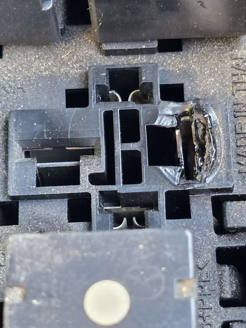

My ac stopped blowing today too and I checked the big 40 amp fuse and one of the posts was a little melted and where it plugged in the harness was too. Can I just replace the fuse and it be ok? Pic attached of melted harness.
Must be a reason why it got hot and melty. If you don't figure out why, stands to reason it'll happen again.
Is that where a relay was plugged in?
I just bought the car and it seems like the air didn't blow very much even on max. So could the blower motor have caused it to do that?
Hard to say if that's the cause or the effect, but a faulty motor could have different current draw characteristics and could have overloaded the fuse.
