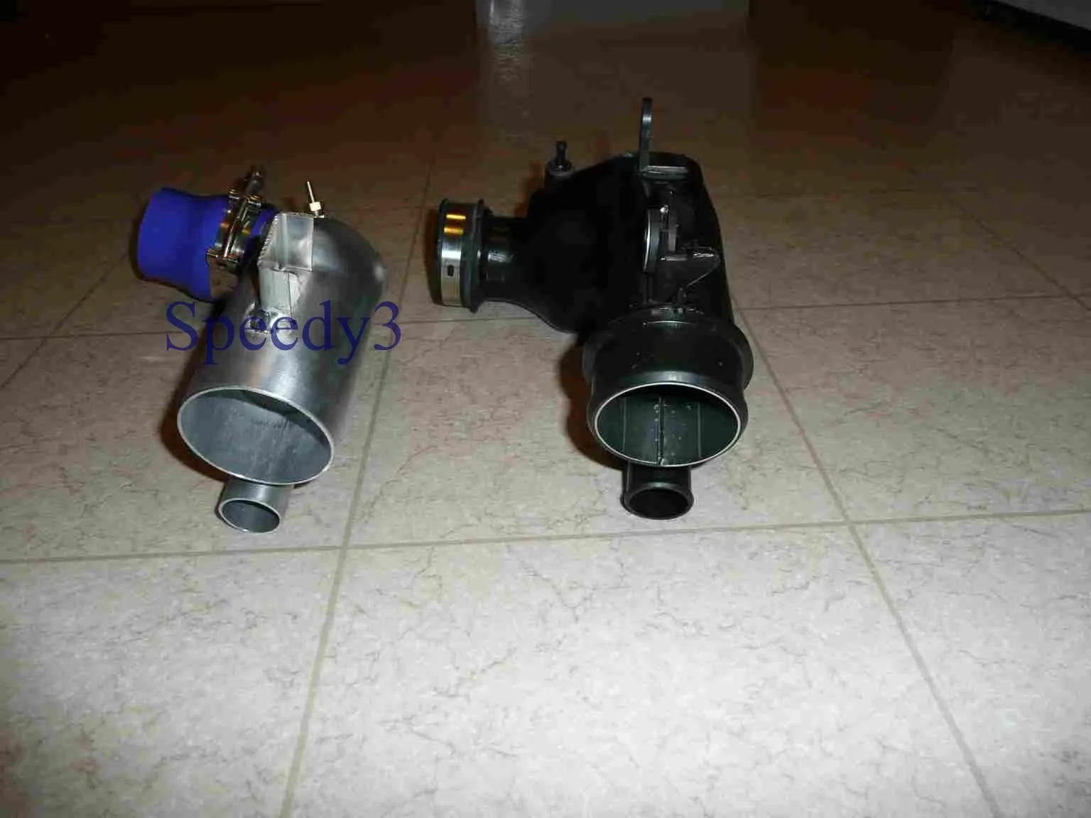

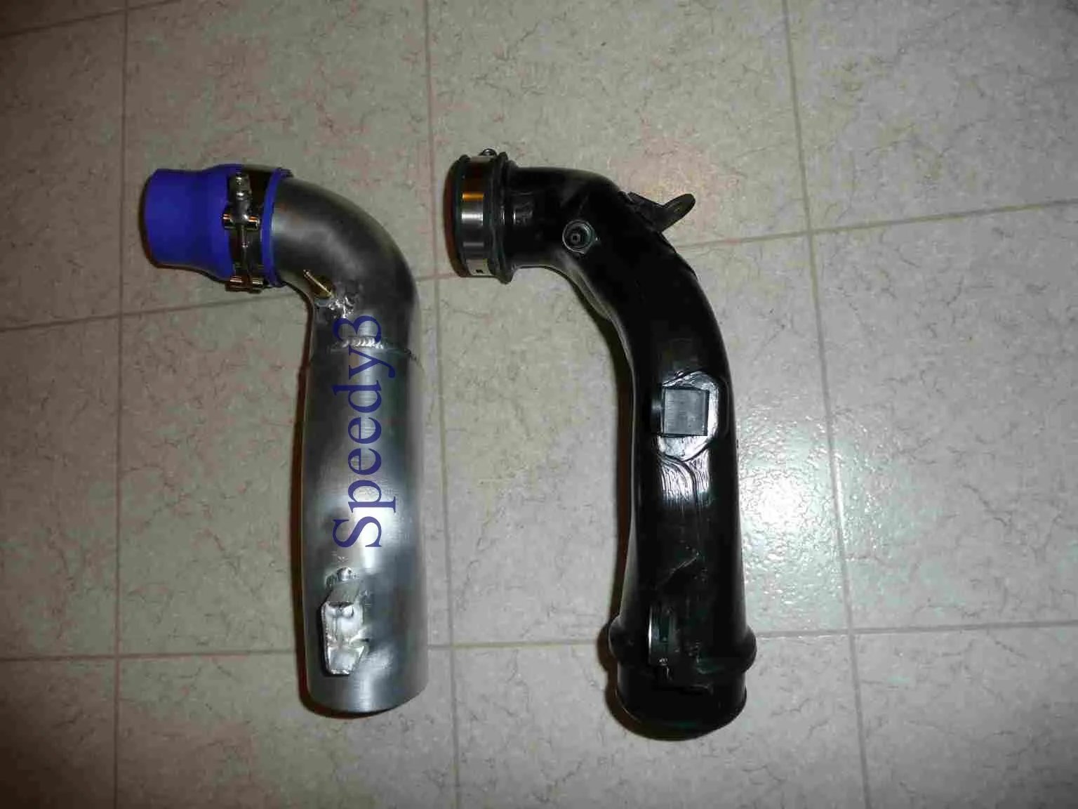

The accordian piece will fit on this inlet design. I'm not sure I am understanding you. This will work with the stock airbox too. Maybe these picture will help.

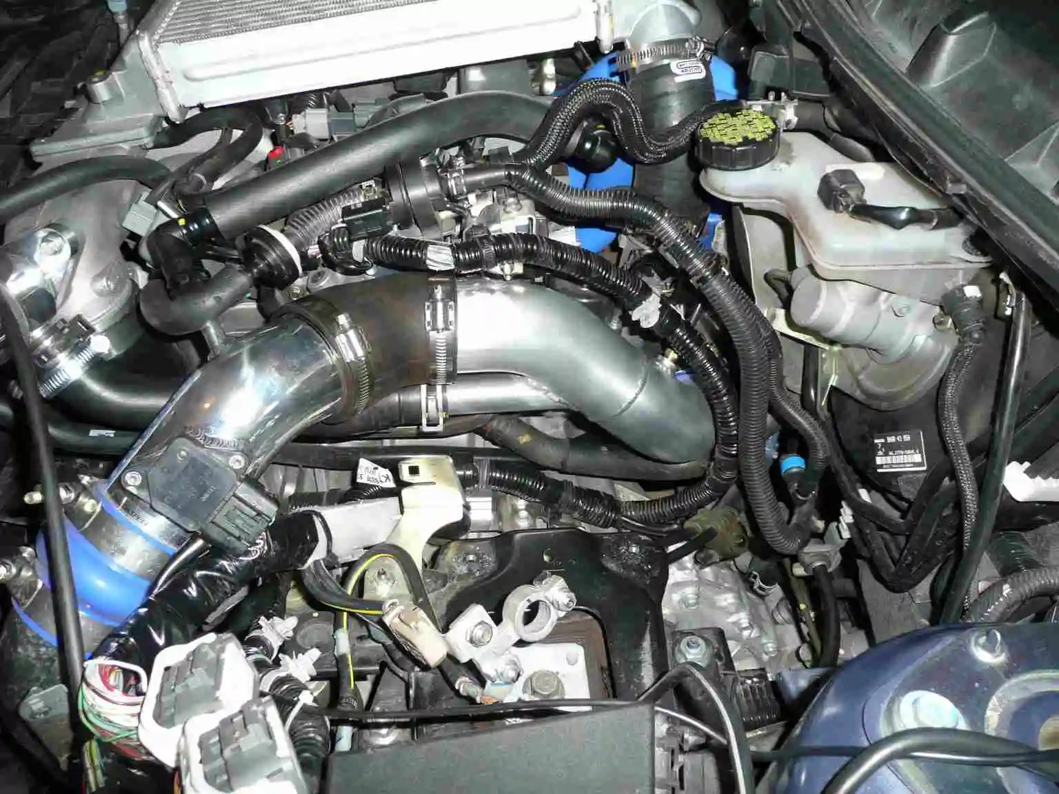

Here's an initial install pic. I had to remove the mounting flange to locate the optimum spot to weld it down. FITS AWESOME!!!! I'm going for a ride now, but the ECU is reset, so I will need to run it about an hour, recycling the ignition every 5 min.

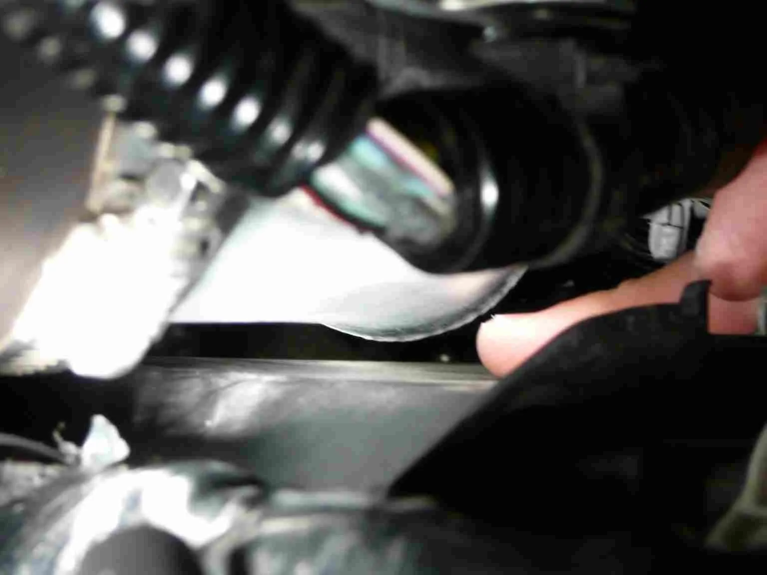

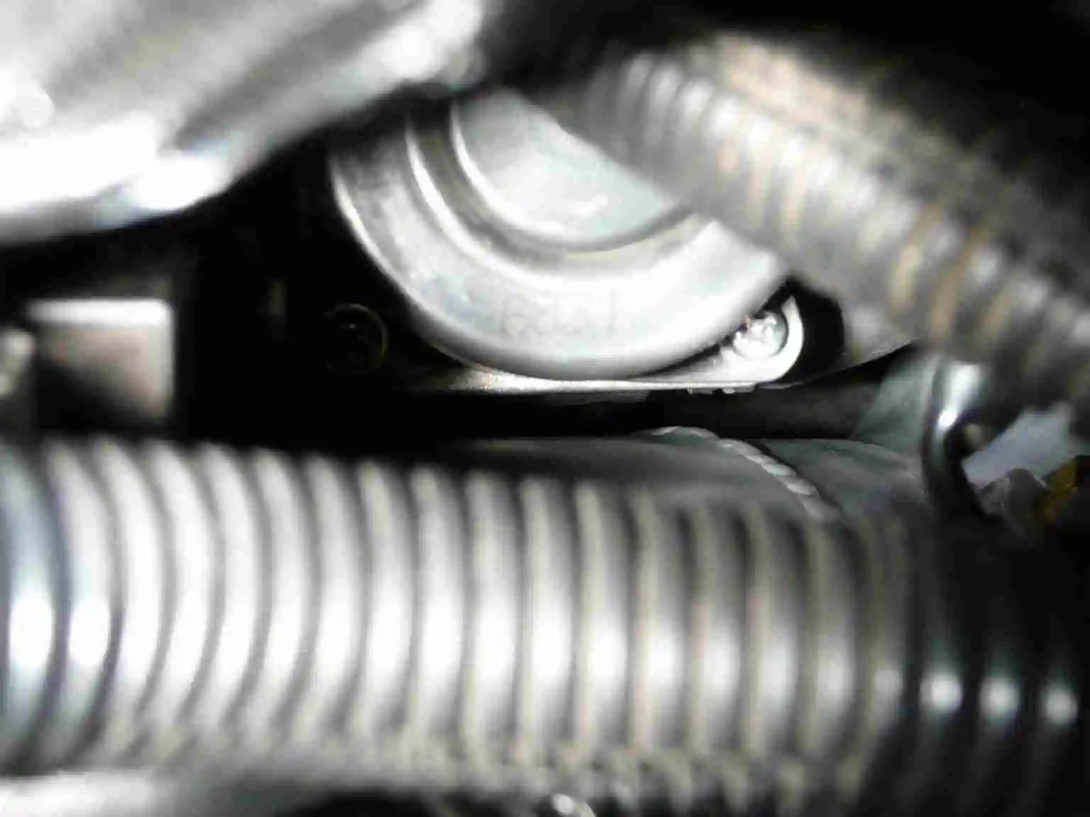

Here are top-down pictures of both sides of the installed inlet tube.
