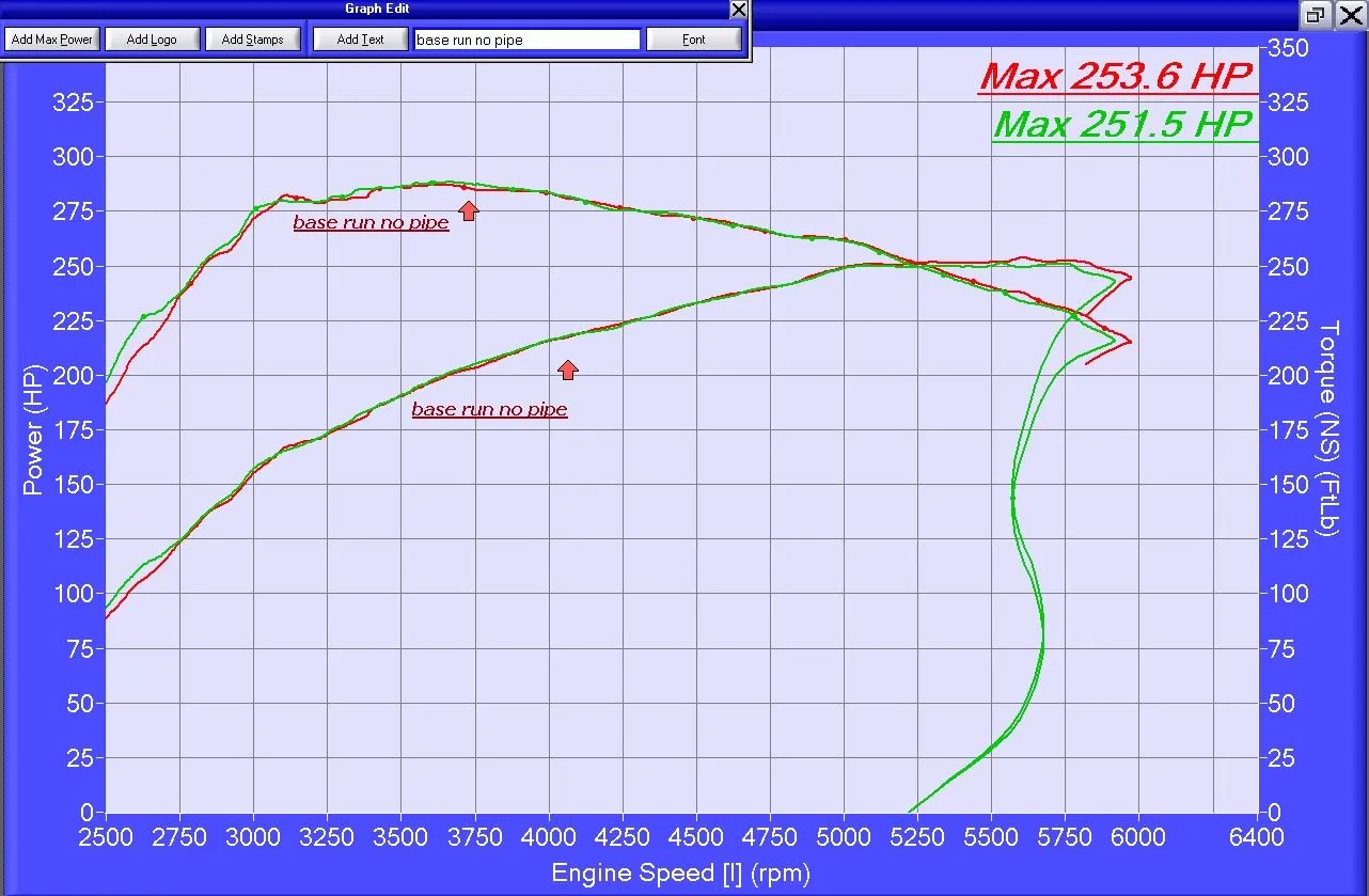

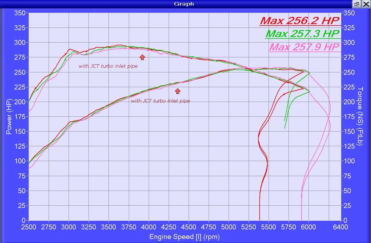

Sorry it took so long, but here are the dyno images from last weekend. My wife has been getting progressivly upset with me spending too much time on this project. I was trying to put both graphs on one graph, but gave up. It is just too time consuming. Also, I was hoping to get the data logs from the Dyno Dynamics computer, but datalogging was inadvertantly left off after a re-boot of the dyno computer. These dynos are not final, cause we had a bunch of problems with the machine's weather station. I did do datalogs during all dynos on my laptop, but they are OBDII data. They are attached to the next post. This dyno reads much lower than most dyno machines.
Stock Turbo Inlet Runs:
Stock turbo inlet, MS CAI, MS CBE, cp-e DP w/cat, Forge BPV w/green spring, PG Turbo Manifold, Cobb AP 2+, 92 octane.
JCT Turbo Inlet Runs:
JCT Turbo inlet, MS CAI, MS CBE, cp-e DP w/cat, Forge BPV w/green spring, PG Turbo Manifold, Cobb AP 2+, 92 octane.

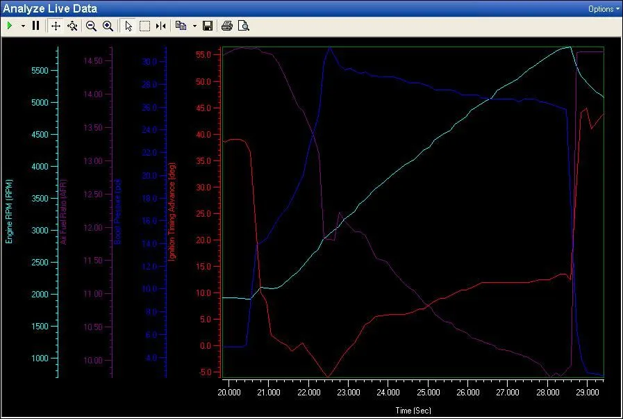

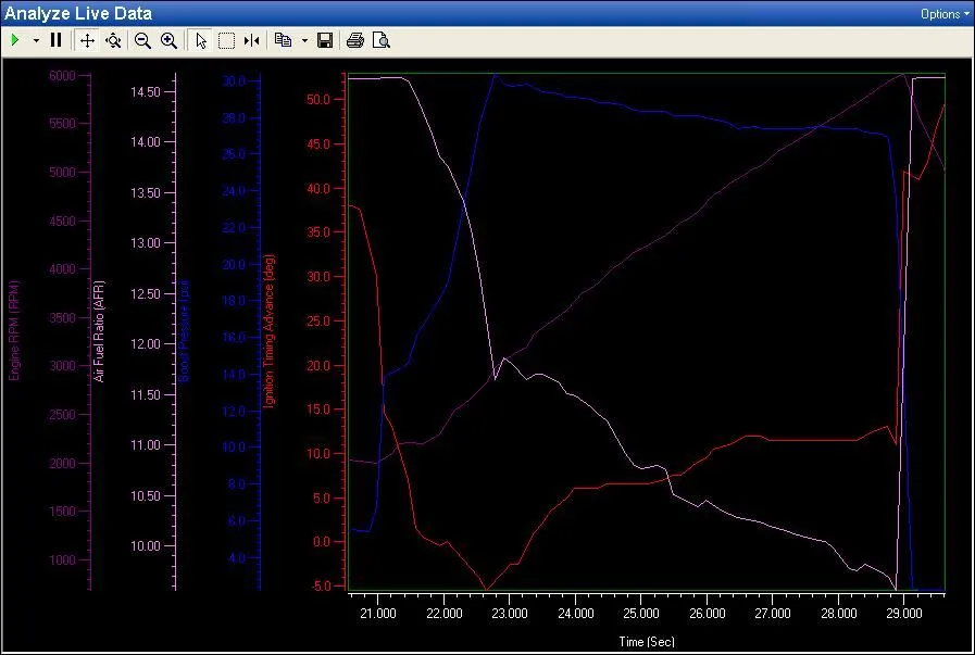

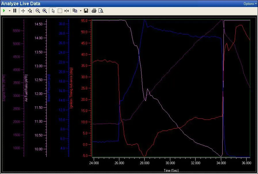

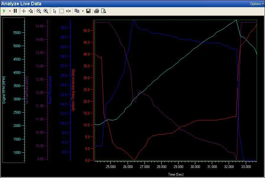

Here are the 5 OBDII datalogs that go with the above dynos.
