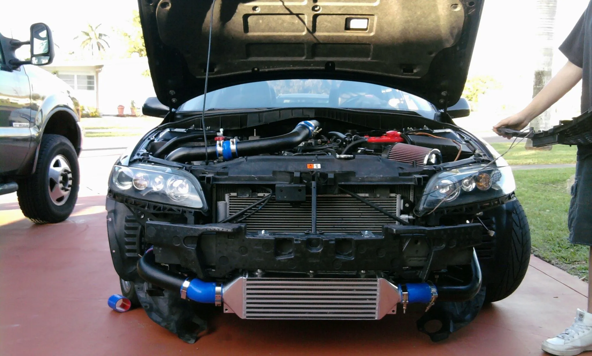

So i finished installing the custom fmic kit from altered customs and i couldnt get the bumper to fit right. I had to take the bottom fin piece off and cut pieces of the fog light housing to get it on. I've seen others with the same setup and it looks like the intercooler fits in the bumper better. Where are you guys mounting the intercooler is what i would like to know. Are you guys putting it right under the crash bar or behind it? Heres a picture of how mine looks

mazda speed are you saying you have to cut the crash bar a little bit to get the fmic to sit higher?
ok i dont have to completely cut it do i just cut about half of it so i can have the intercooler sit up higher correct?

i have the 27x6x3.5 intercooler and looks like i'll be cutting the crash bar. I got a buddy that might be helping me out tonight so hopefully i can get it to fit correctly
Same intercooler I have. You HAVE to cut half of the crashbar. Make sure you have a fresh blade. Took me an hour to cut through this hard steel!

Thanks Qwik 6, i was looking at your pictures trying to figure out how you mounted yours and didnt realise that you had cut the crash bar. What did you use to cut it?

Took me like 30 hours. :( I had my parts list mixed up and was trying to figure out how to make everything line up and work. Also did a lot of cutting to get more air flow to the radiator. You will also find yourself trimming a lot from the fog light area. I used a reciprocating saw to cut the frame. A grinder would probably do much better but would make for a lot of metal flying on your car.

I thought the same thing which is why i got the 6" intercooler, i really dont care about cutting the crash bar but it sucks cause now i have to take the time to cut it. There is some confusion with the kit. I'm wondering how the cp-e and corksport fmic's sit?

They sit behind the crashbar. Half is covered by it which seems odd for air to be able to pass through it.
But you just cut half the crashbar. Dont cut the whole thing!! You could always keep the piece you cut and weld it back on if you sold the car.
