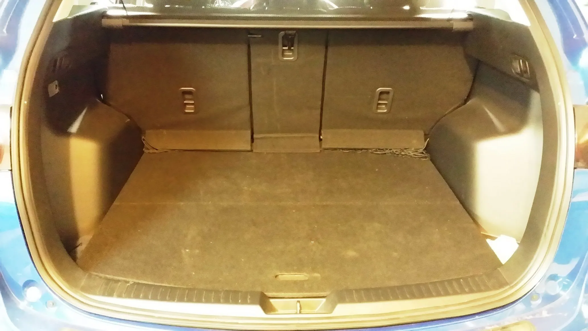

This was done by Audio One in Chesapeake VA. I had some requirements, I needed it to be compact enough that I could still haul my scuba/cycling gear, and I wanted to be able to get to my spare with out having to do anything weird.
With the rebalance, it's just what I was looking for.

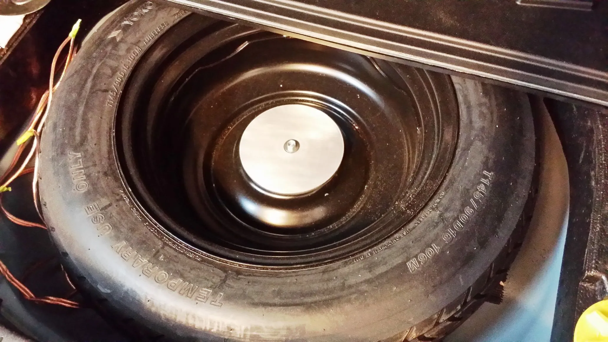

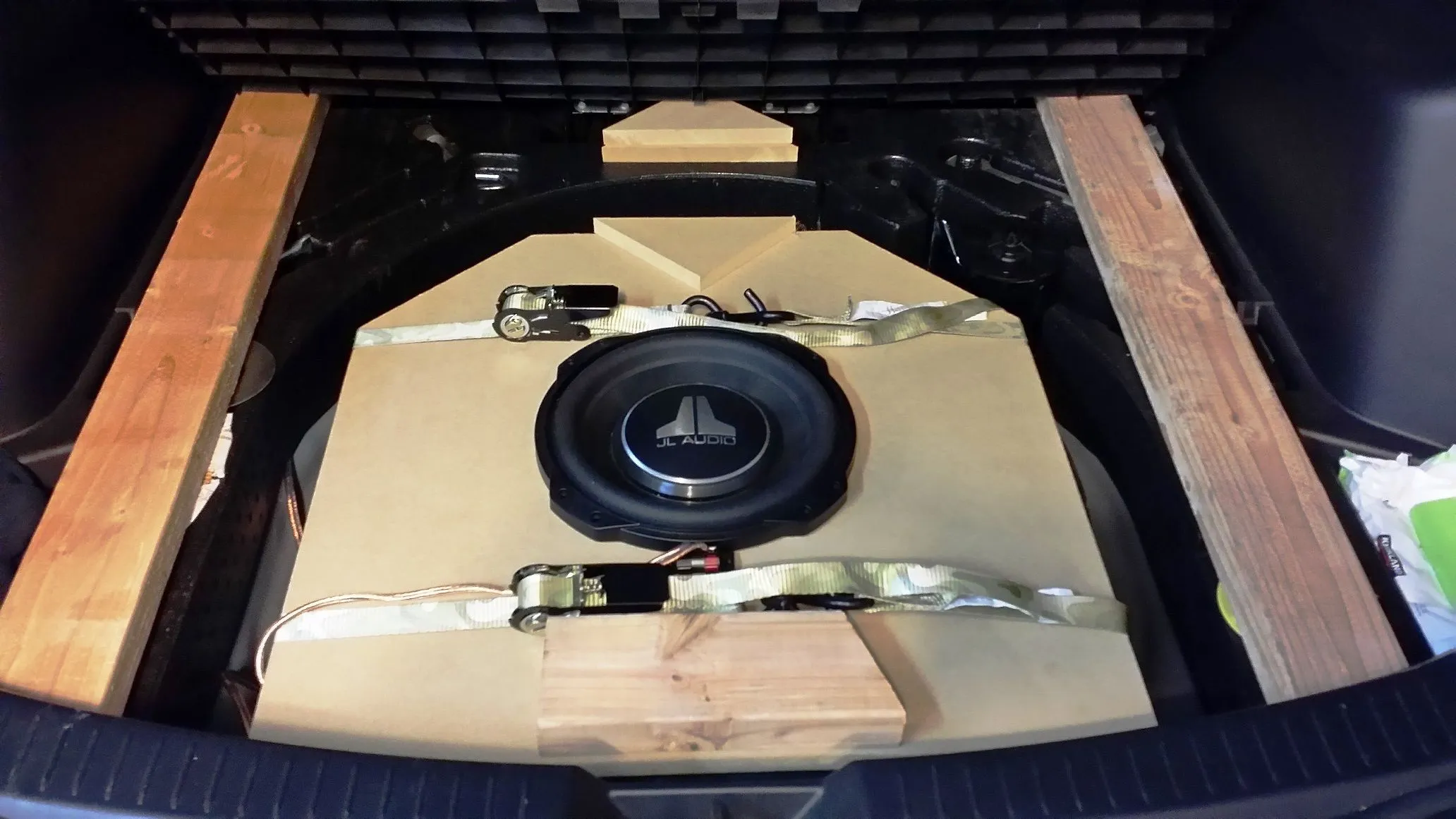

In the spare wheel.
It's not a nice setup, but it works great.

Under that round aluminum, there is a same size( Dia. 6") rubber, to seal the wheel completely.

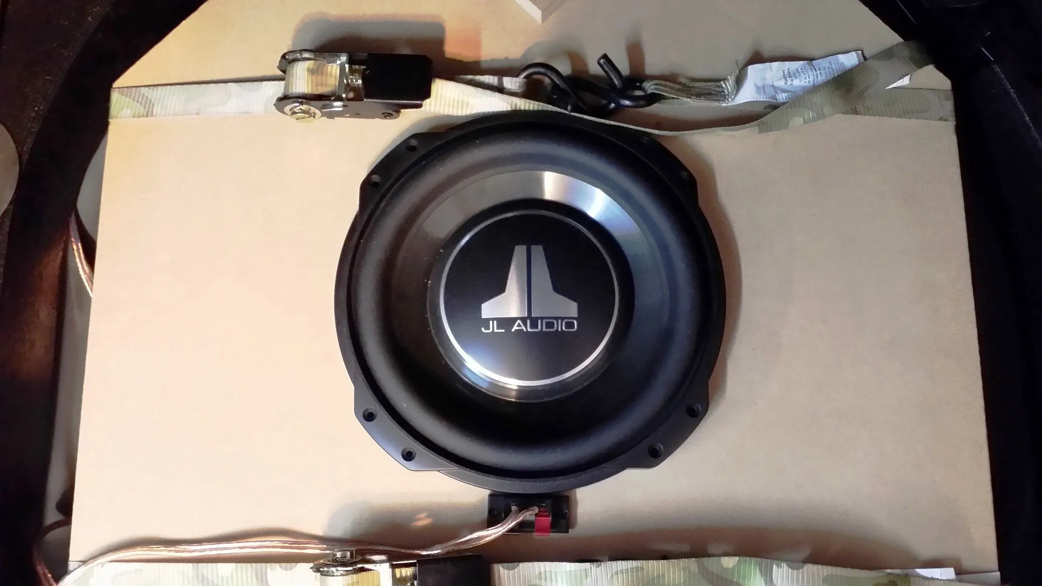

I also have a Polk Audio PA660 amp that powers the door speakers.
Stereo Kenwood DNN991HD
Front and back Infinity Primus components
Dash has Polk 3.5"
Speaker amp Polk Audio 660
Sub amp Polk Audio PA880
Sub JL Audio 10TW3-D4
Mini 0805 dashcam(soon, I will one in the back also)
Escort Redline radar detector
Side mirror camera + factory camera(will have a front one, soon)
Both amps, I have picked up broken from the bay, each $40 and I have repaired them.

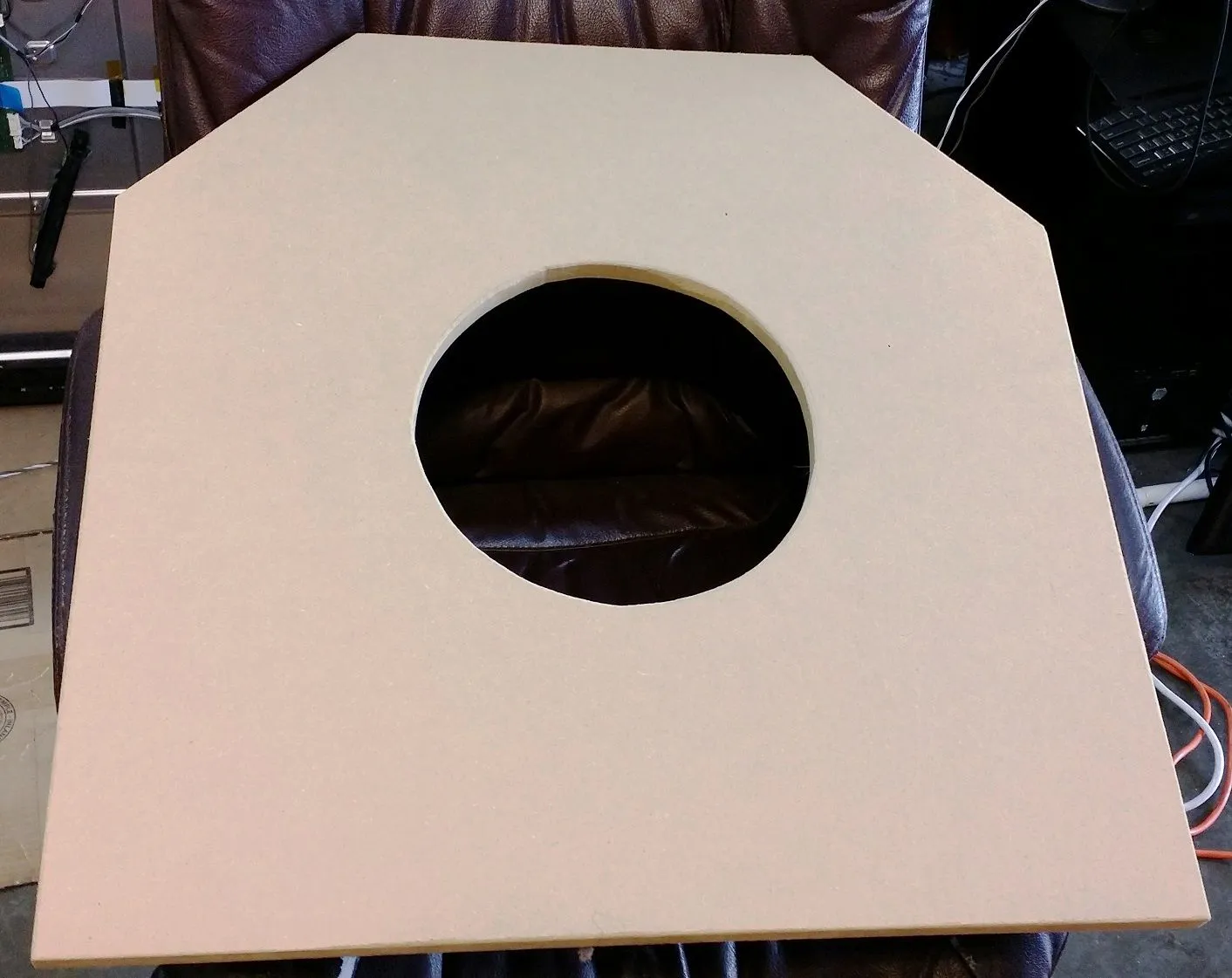

My setup, it was fast and super cheap. MDF it was around $12, Aluminum plate we had it at work, same goes for the rubber seal.
A little cutting, wire running and I have an awesome sounding(not looking) subwoofer. I won't be attending to shows with it, that is for sure.

What's with the ratchet straps? I don't see the purpose of them? And what did you use as a seal against the rim of the spare tire? I could probably do something similar if I could find a way to seal the sub against the spare tire.
The straps are for that, to seal. MDF, against the tire rubber surface. It sounds awesome and I still have the spare, if I need it. I keep a wrench to open the bolt, that holds the spare to the car. Got rid of the big factory knob.
There is no room for the speaker grill though, just a heads up. I needed some spacer(2 x 4) between the speaker and the floor. Speaker grill, is taller then 2". The floor is raised now, ~ 2".
