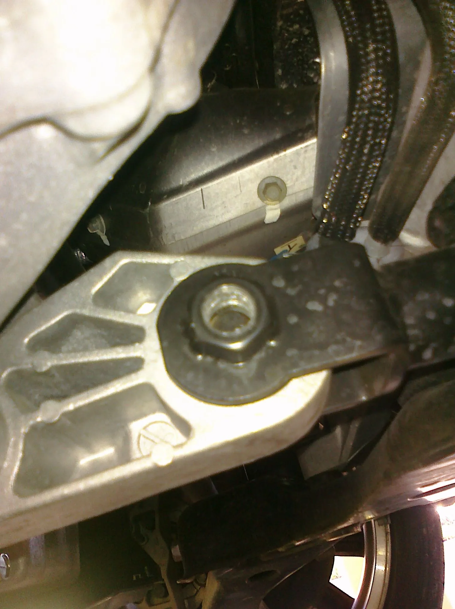

I attempted to uninstall my TRZ dogbone mount to go back to stock for a dealer visit, only to discover the mounts threads on the welded nut were completely shot. Mount has been installed for approx. 8,000 miles.

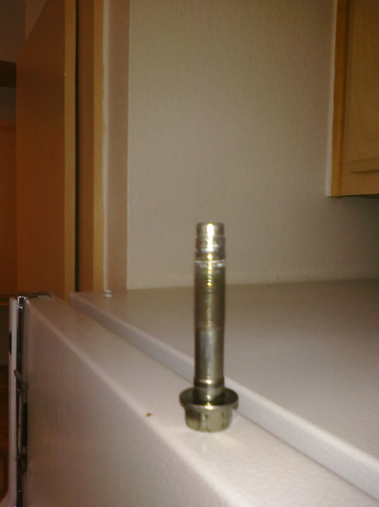

The bolt is completely wrecked, and all of the threads on the welded nut are as well. I can't imagine how I could have cross threaded this thing so badly on the install - as I had no difficulty in putting the unit in. I have tightened the mount one time to remedy some slight squeeks and jitters, but I honestly don't know how this damage was done.
Doubly unfortunate that I tossed the bolt that held the stock mount in place, so going back to stock at this point isn't even an option. Also the bolt and nut have had too much material removed and will not take to a thread cleaning.
Pretty upset at this point, I may go with a CPE mount or something.

Ahahha.. I tried my best not to do what I did.. humor aside I don't know what was done that could have done this. It went in easy enough on install, was discovered this nasty upon removal.
Is that the bolt that came with the mount? Might have sent you the wrong thread pitch or it's just a crappy bolt.
Right... bolt that came with the TRZ. Looks like some nice galvenized steel to me, but it is slaughterhoused at the end.

Is it the nut that is welded to the TRZ mount the one that got screwed up? If so, you have two options to fix it.
1st (best option besides buying a new mount) Carefully cut the welds holding the messed up nut and remove the nut completely. Then you could have someone weld a new nut on or simply use a nut by itself (a locking type nut or at least a locking type washer)
2nd (which is the easiest but not the cleanest). Just drill out the messed up nut so a new correct sized bolt will pass thru it. Then buy a longer bolt and use a nut like in the 1st option.

Well I went back and look at your pics again and it looks like the bolt that is messed up IS the stock bolt. By the looks of the stepped portion near the head and the built in washer that is the OEM bolt. Also I am wrong about only 2 options...........the Helicoil repair would work if you choose to go that way.

Bulldog are you positive that was the stock bolt? Was pretty confident I used the new bolt included in the kit, and threw the old bolt out. Could be the issue if so... used the wrong pitch or something.

Looks like over-torque damage to me. Did you use a torque wrench? Was there grease, oil, water or anti-sieze on the threads?
I'd try to cut the welds with a dremel (carefully) if you have one and weld a new nut on. Drilling through and using a longer bolt with a second nut adds new stresses to the bolt and nut and control of shearing forces is the issue here.
