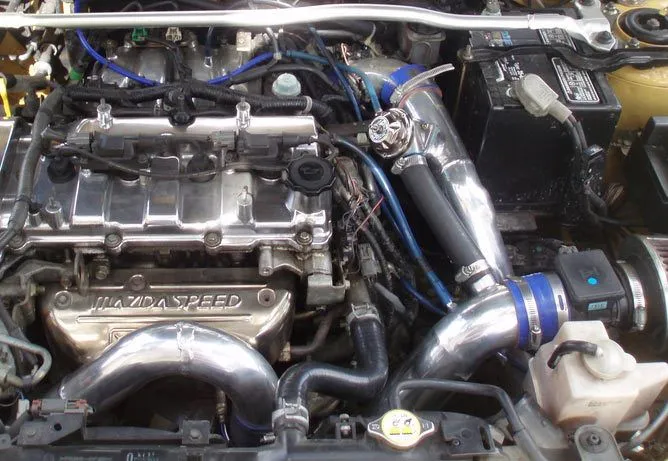

CorkSport FMIC Installed!

the cutting is no big deal. just have the right tools and everything is cool. the piping for the hiboost kit is extra long which means extra lag. the corksport instructions is very detailed and they give you everthing you need for the install. i couldn't be happier. the only kit that rivals the corksport is the might perrin fmic that can be found on Jcell car. Holla Back!
It didn't take much cutting the only downside IMO is that you have to run without tow hooks. I think too me that is a big deal. Specially if you are ever in need of a toe. You have to remove the two towing hooks and cut away some of the sheet metal. We used these plier looking things called snips. Worked good but you need to put some good muscle to cut through the thicker portions. All in all the Kit WORKS great, fits even better and the core itself and piping have 0 and I mean 0 room for vibrating. Everything is bolted down to stock locations.

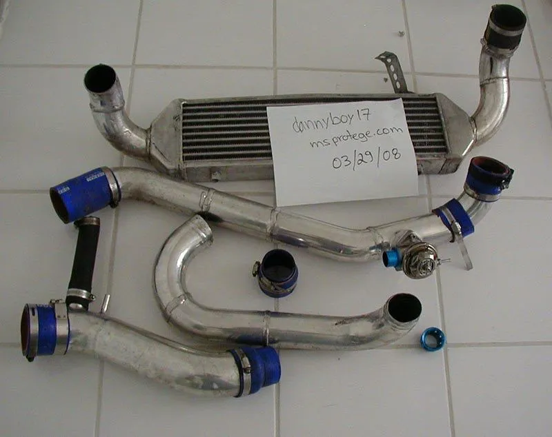

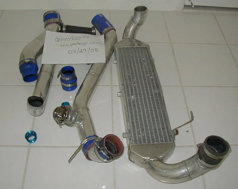

Damm...so the tow hooks need to go eh. Always something...guess I'll just get the core and custom make the pipes to run like the perrin.
you wont be able to. The Perrin core has the end tanks facing the car and not the sides like the Corksport. I say go with the TurboLife kit if you are worried about the tow hooks. But then remember you gotta loose the as I call it " the don't die bar" (re-inforcement bar). So if you get into and accident....say GOODBYE to the car and prolly yourself.
Ya I know but check this out...it was for sale not to long ago and I like the idea. You keep the "don't die bar" and you also keep the tow hooks. The route is shorter aswell.
I wasnt able to keep the "dont die bar" with that kit.. It was either, notch out some of the dont die bar (which I dont have anything that could cut through it) or take it off..
