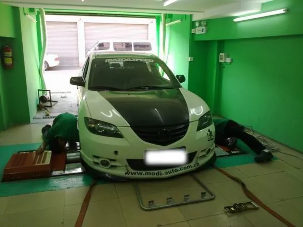

Thanks everybody's instruction, we already succeeded MAZDA3 re-equip MAZDASPEED3, and before already solved the problem. Moreover the part has the operation to be good。

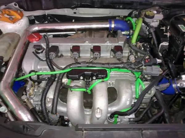

Engine compartment picture。。。
