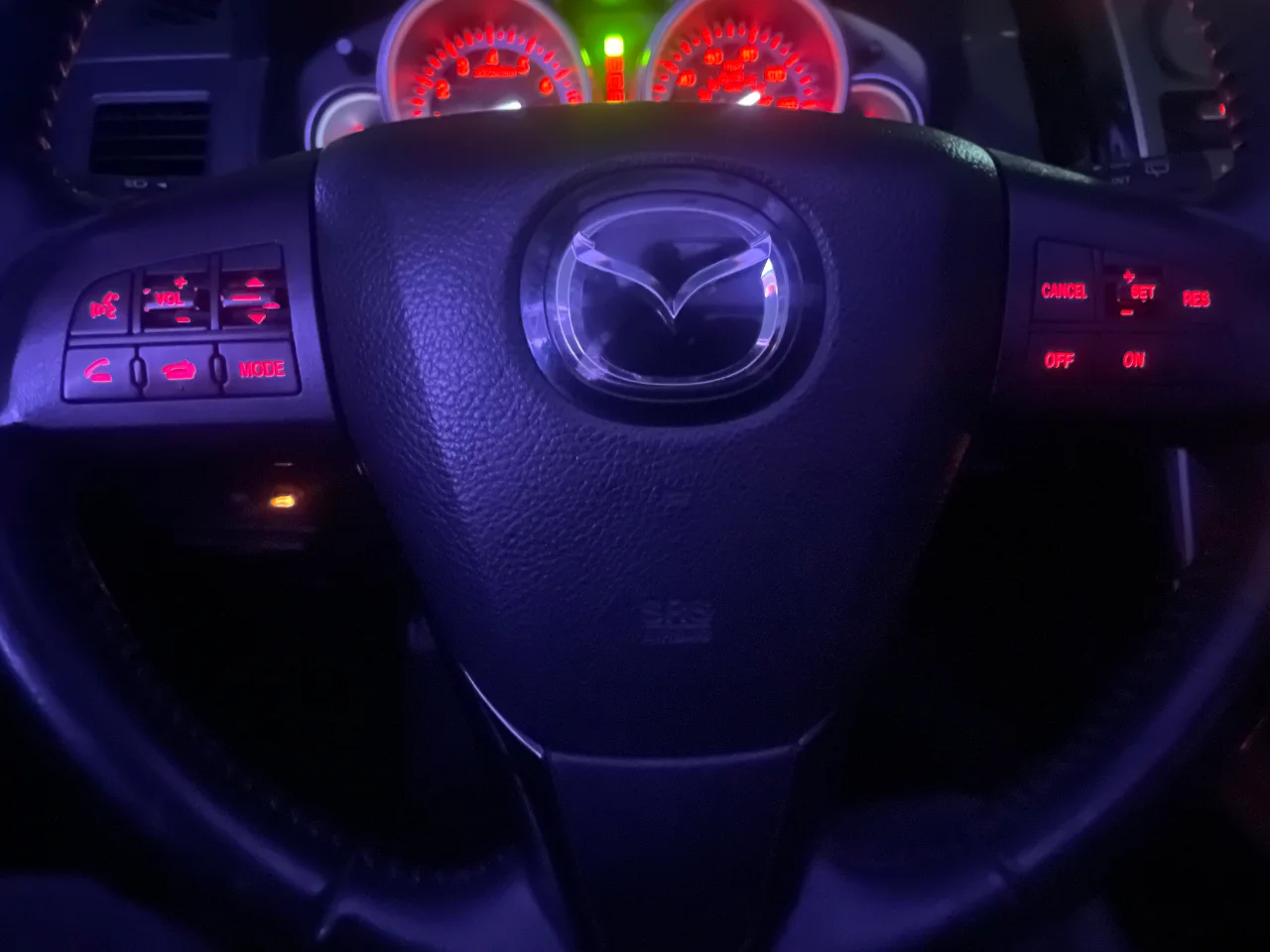

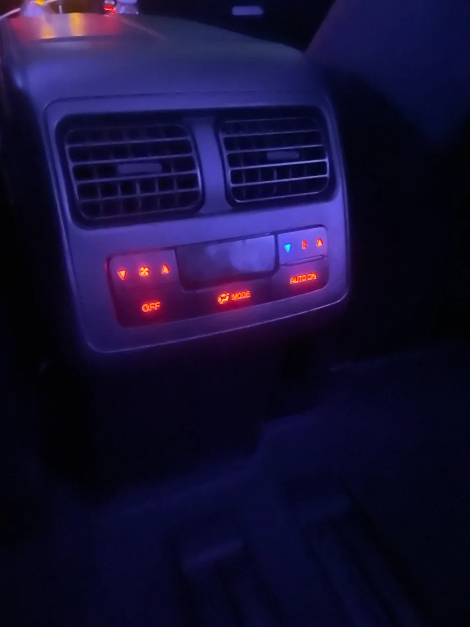

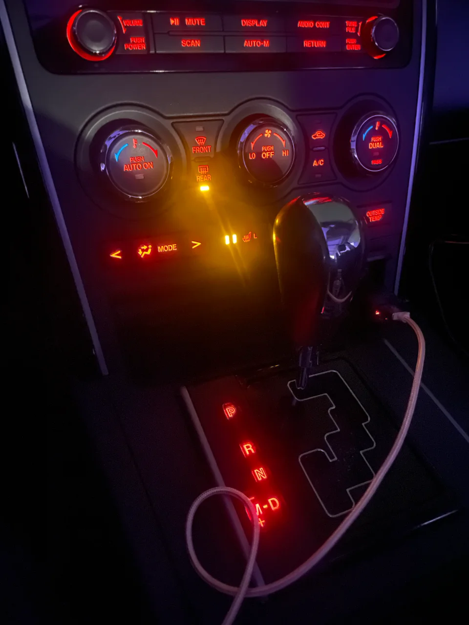

Update: Diagnosis: Missing Ground Wire,rather then tracing,they manually added a ground wire,im ok with this as me and my buddy have the same analysis...just not confident where to tap a ground wire.Overall all climate control ,gear shifter,steering wheel ,2nd row climate control back illimuniation are all fix.
The one item i observed is the hazard switch has no back light illumination...minor may replace the switch later on. Cost $203.44
