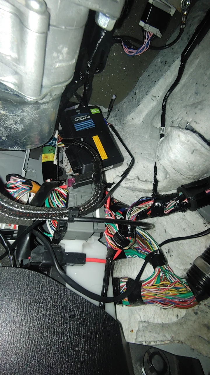

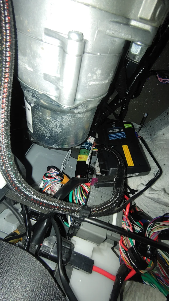

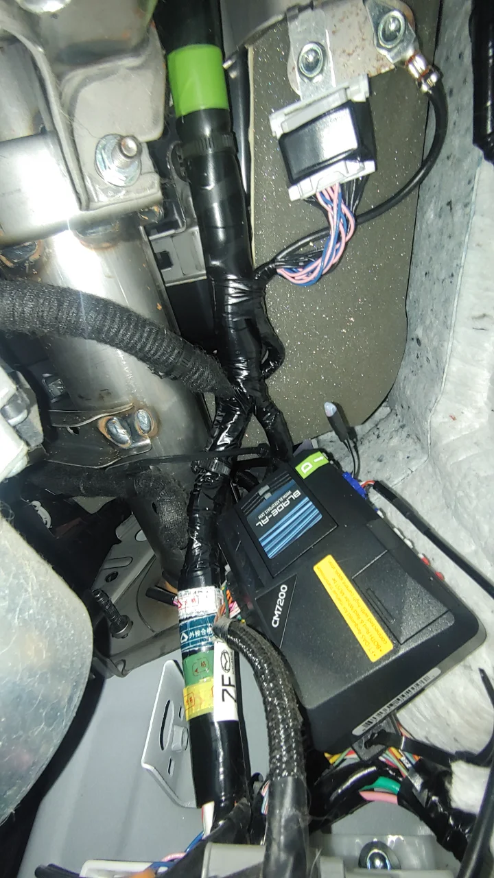

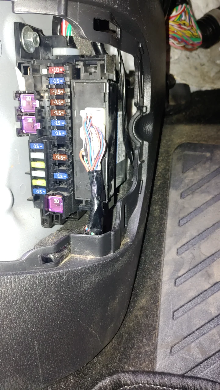

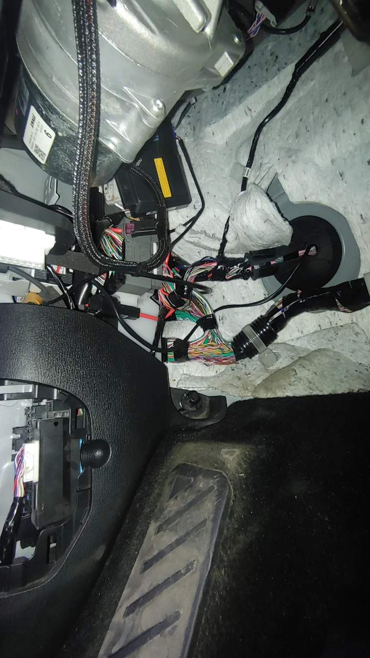

I checked and there is no fuse box named Panel. Regarding the G10 wire, I have absolutely no idea which one it could be. There are a lot of cables under the dashboard and for a layman, I don't know which one it is G10
Ok. I see two other fuses that may be linked to it: INTERIOR and C/U 1G1.
Sorry i can’t help much more, it could be as simple as a wire connector that is not fully seated somewhere. I also noticed that you have an aftermarket remote starter installed, sometime a bad wire spliced in those installation can be the culprit, but i don’t know if they used the climate control light wiring or not for it.
