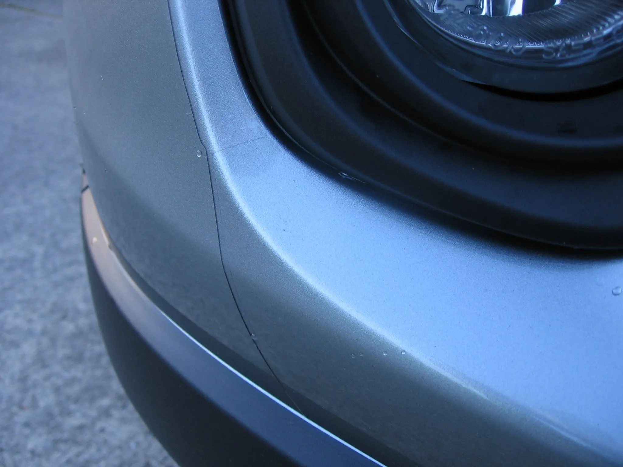

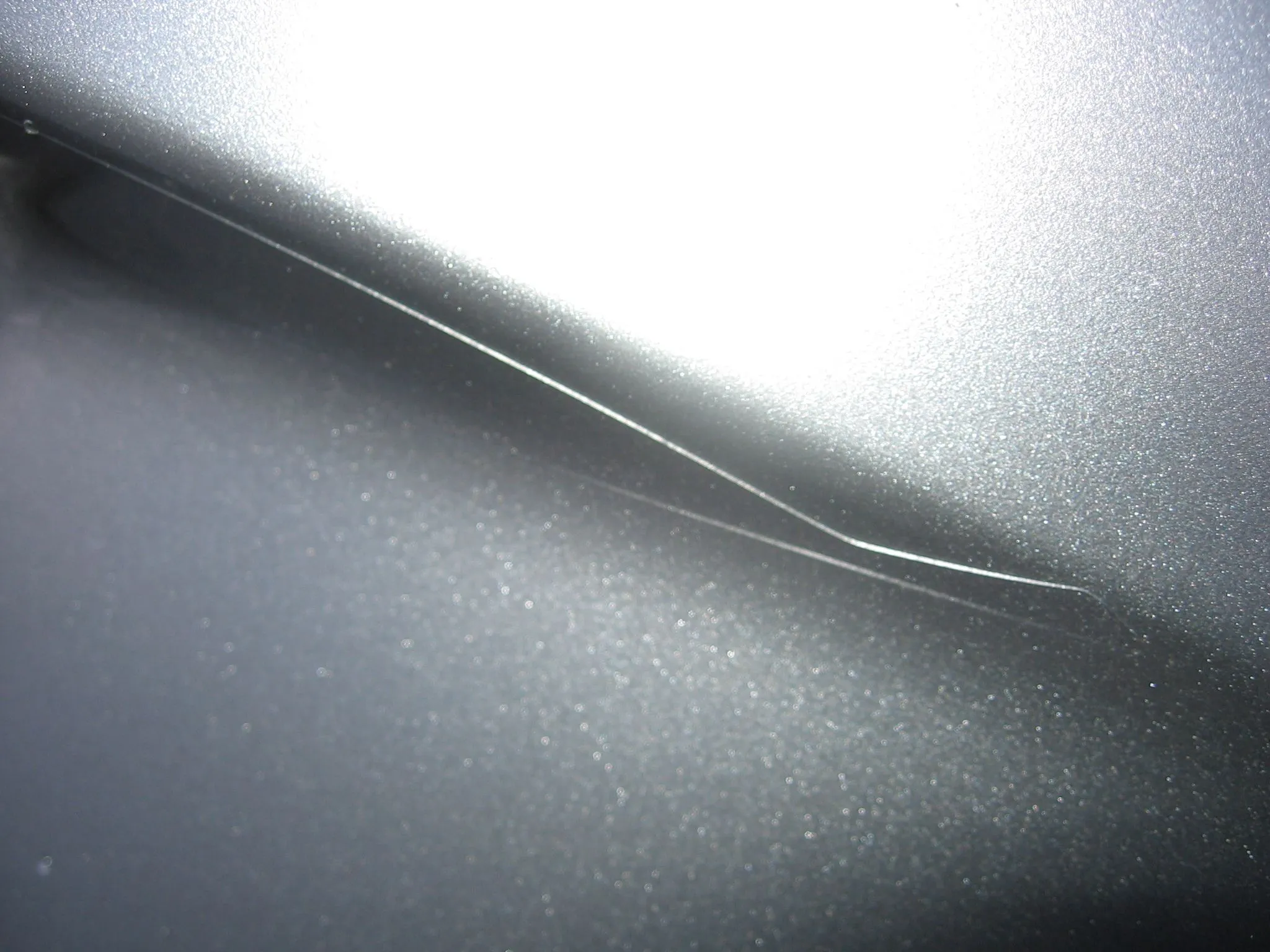

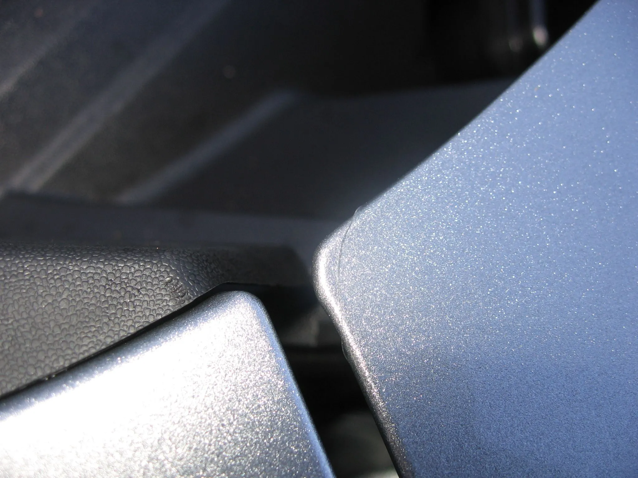

hood is best only the tips are not done.
the front bumper with template is ok but not super it does have nice cutouts around the front parking sensors but misses a bit too much around the fog light surround, this is super close though with camera on macro. You can't normally see it.
