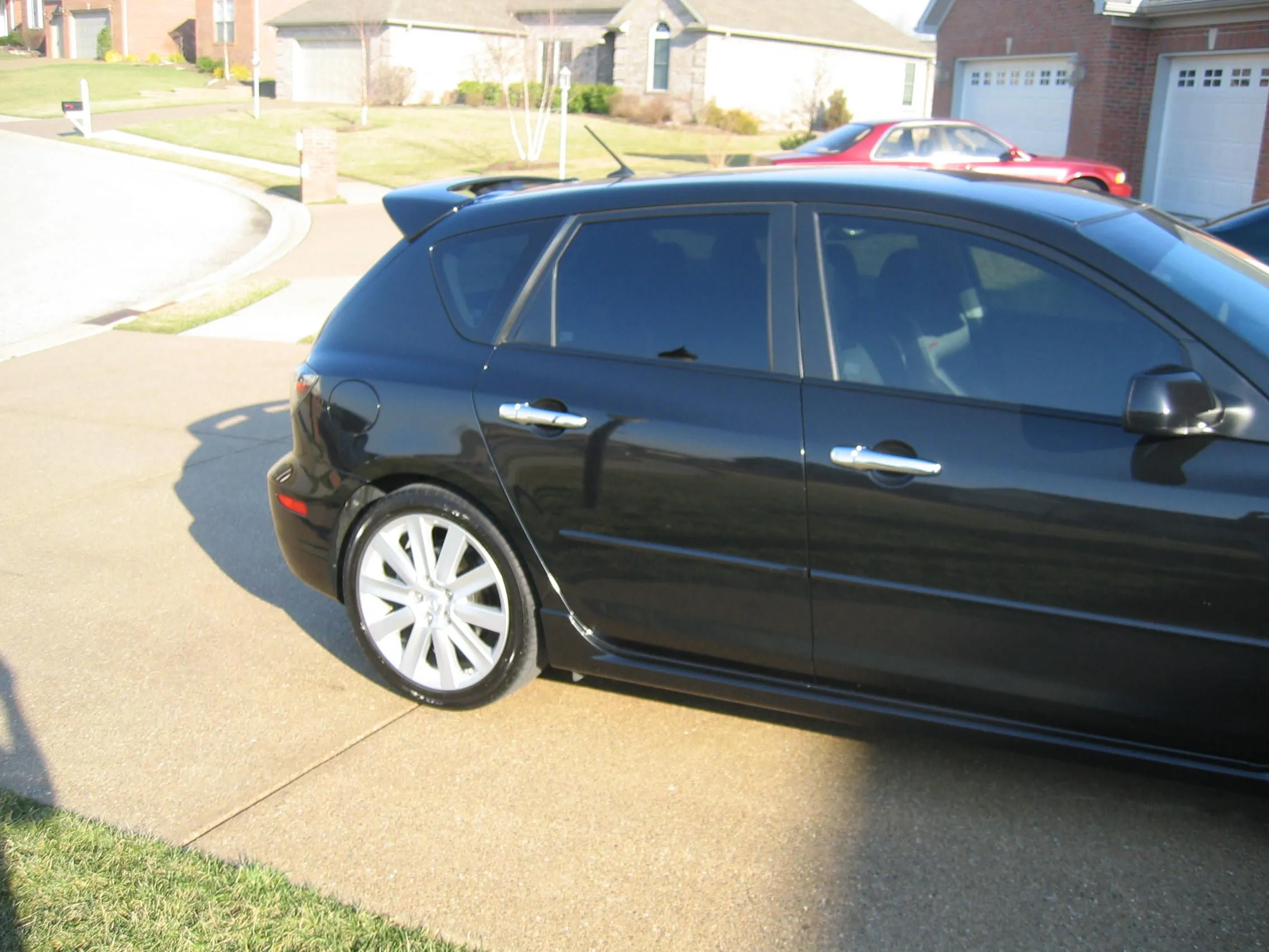

I bought my MS3 used and it came with chrome door handle covers. Has anyone else seen these? And does anyone know how to remove them? I about to start the process of 'blacking' or 'murdering' out my car. any adivce would be greatly apprecitated
see pic

Most removal of any adhesive includes the use of heat and goo-gone or some time of adhesive solvent

3M general adhesive remover should do it. Soak it a bunch of times before gently prying them off.
shouldn't, as long as you dont scratch them when you pull em off, if they are just overlays that are glued on you should be ok. use heat and they will come right off no adhesive remover needed if you don't wanna use it because it will take the wax off your car too so you'll have to wax your ride again. any extra adhesive you can rub off with your thumb into a ball

The adhesive remover wont take any paint or anything off your car but like the other guy said you would just have to wax over that area again. The 3M stuff is really good and what us P5 and I'm sure other people use to take off the side moldings.
