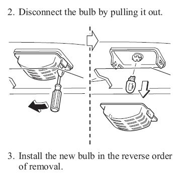

you just need to change the light bulb, see SECTION 3 in this link :
http://www.paulstravelpictures.com/Articles/Mazda-CX-9-SUV-Repair-Maintenance-Guides.htm
if you're talking about the license plate light, you just need to change the light bulb also,
no need to replace the whole part, the clear plastic pops out with a flathead screwdriver,
instructions should be in the manual.

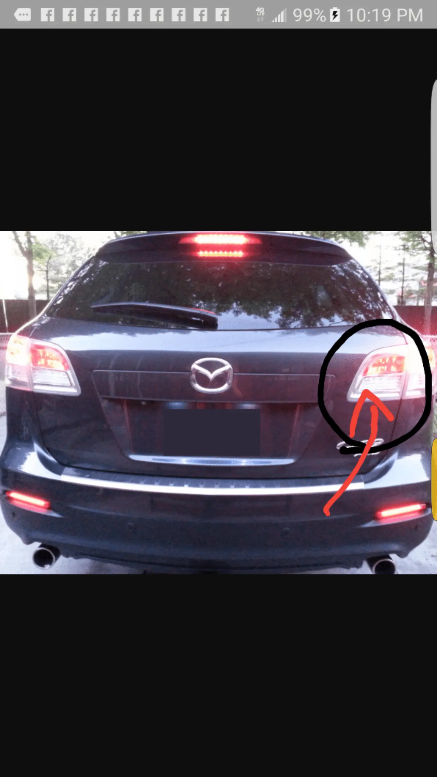

See the arrow. I'm talking about that light

I'm going to guess either a 194 or a 7440, as is customary for Mazda. The Sylvania guide offered no help.

yep, it's just a tiny 194 bulb, it's not a brake light per se, more like a marker light at night for rear drivers to see you.....
it's not a two stage light i.e. it doesn;t shine brighter when you hit the brakes
2010-2012 CX-9's don;t even have them

makan dan, where the heck did you get that pic from, are those LEDS in the bumper (green arrows) ?????
SWEET !! I've never seen a CX-9 with LEDS IN THE BUMPERS, can't miss those, less chance of getting rear ended
I've seen Infiniti EX35 have those light up when they make turns (looks weird though to have turn signals flashing from the bumpers)
also the old Lexus RX bumper lights also lit up
