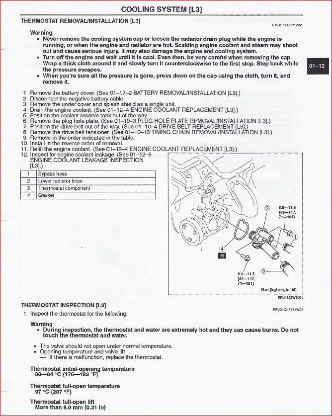

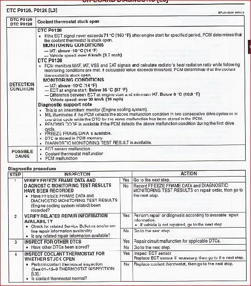

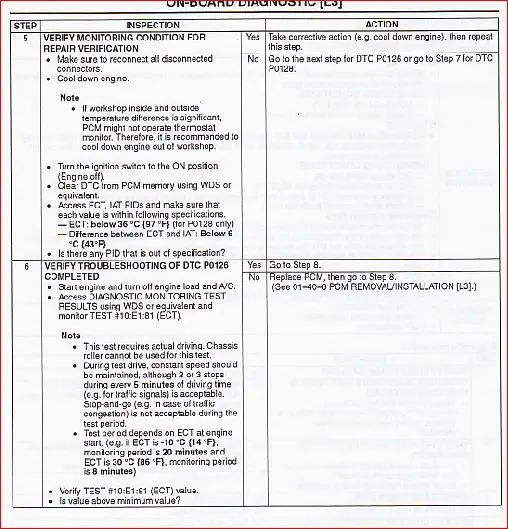

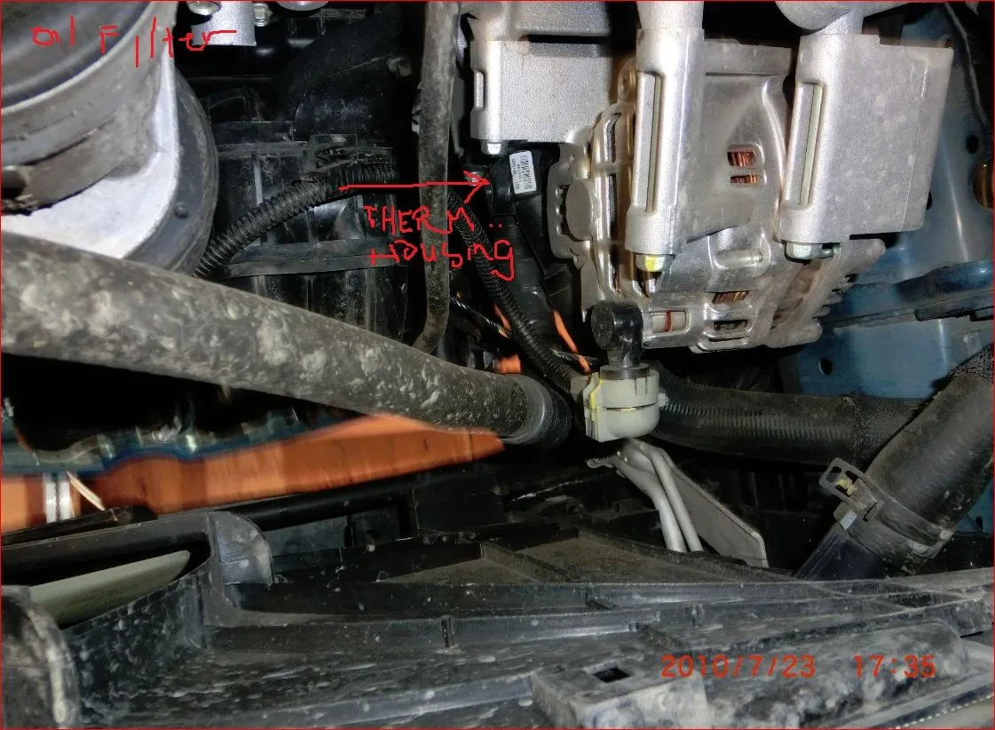

Ok, I spent 50 bucks on a code reader. I pulled one code - P0126 Coolant Temp Insufficient Stable Operation. I've been reading around on the forum and it looks like a bad thermostat? I guess that is better than a bad O2 sensor or PCM. Is there a DIY posted here on how to replace the thermostat on a Mazda5?
I'm off work today. Might as well test my scanner.
These ones are from a 2006 Workshop manual. The last pic, I took last time I changed the oil.
