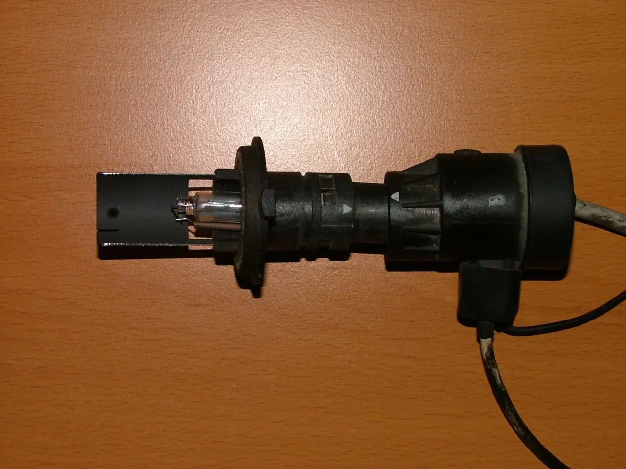

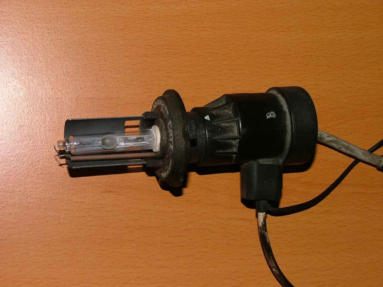

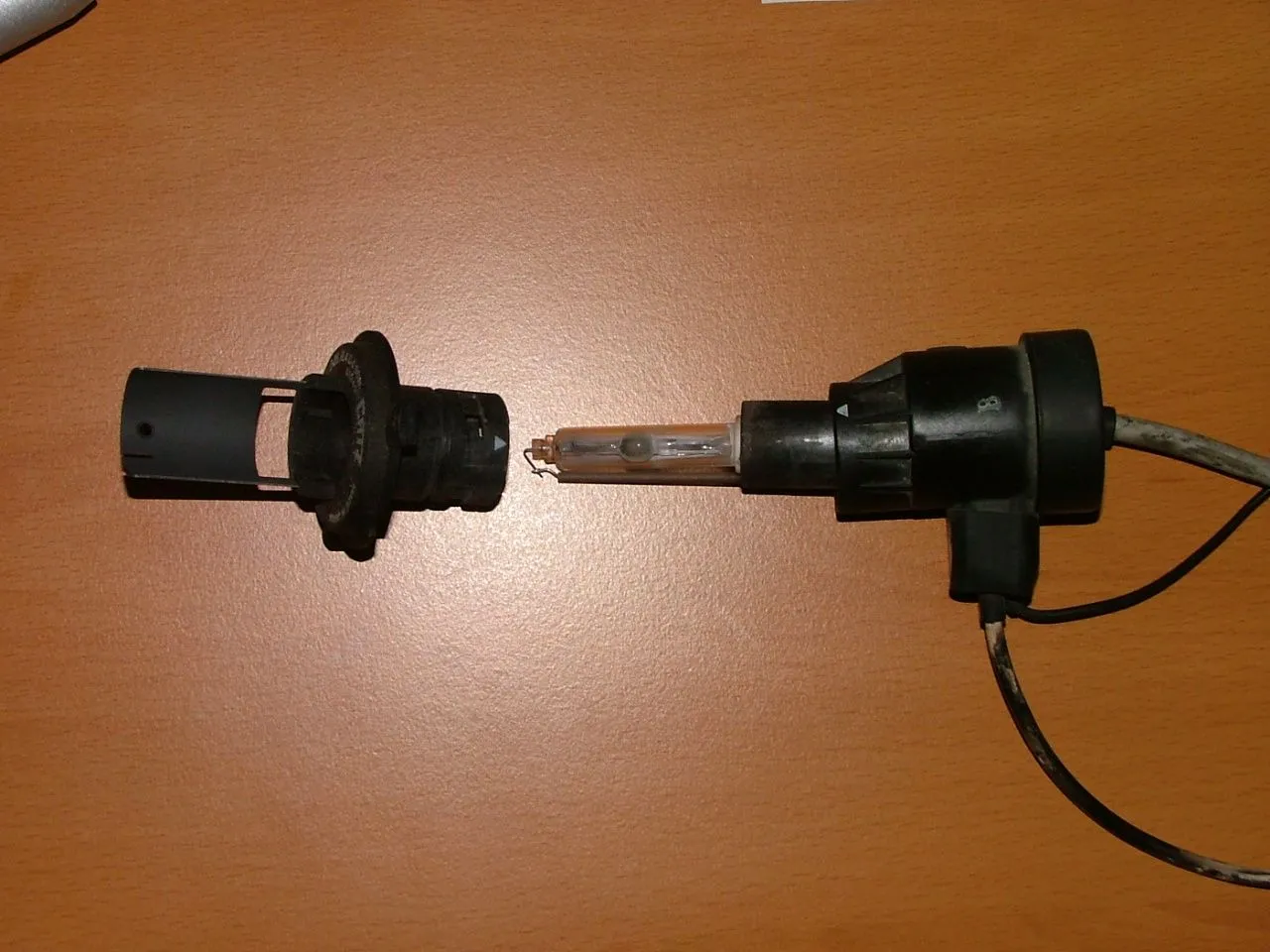

You can actually twist off the bulb at the top and slide the boot over the shaft from what I can remember.

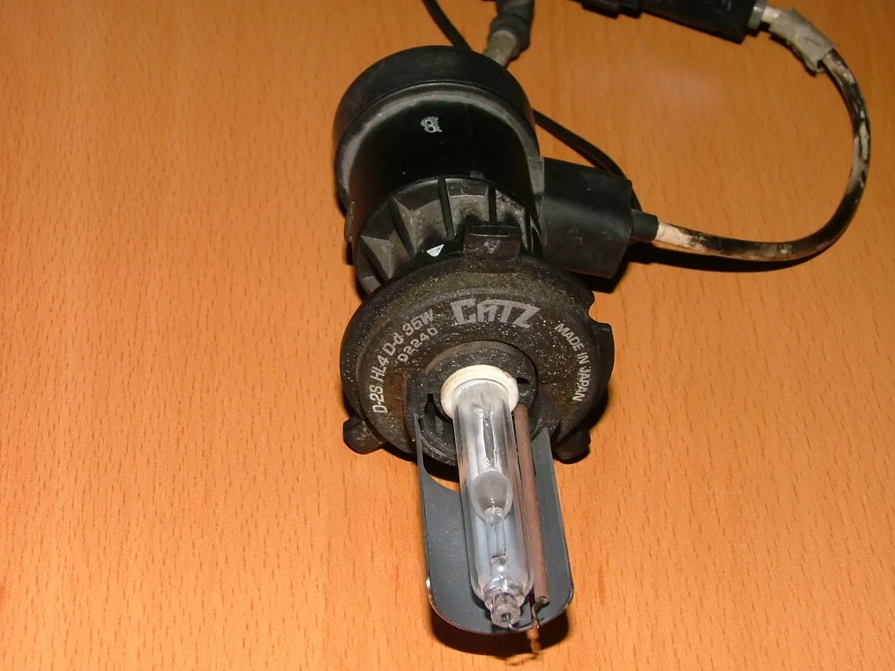

No, cutting is NOT the best way in the case of the Catz bulbs. You can twist the bulb assymbly off at the top and just slide the boot over the shaft, and then twist the bulb back on. Remember, you want to keep moisture OUT of the headlight housing.

The original question was concerning the CATZ bulb. I just wanted to make sure that future folks who may read this realize that they do not have to cut the boot with those.
I removed my old CATZ kit, and figured I may as well post illistrations to show what I am talking about:
