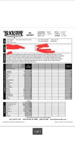

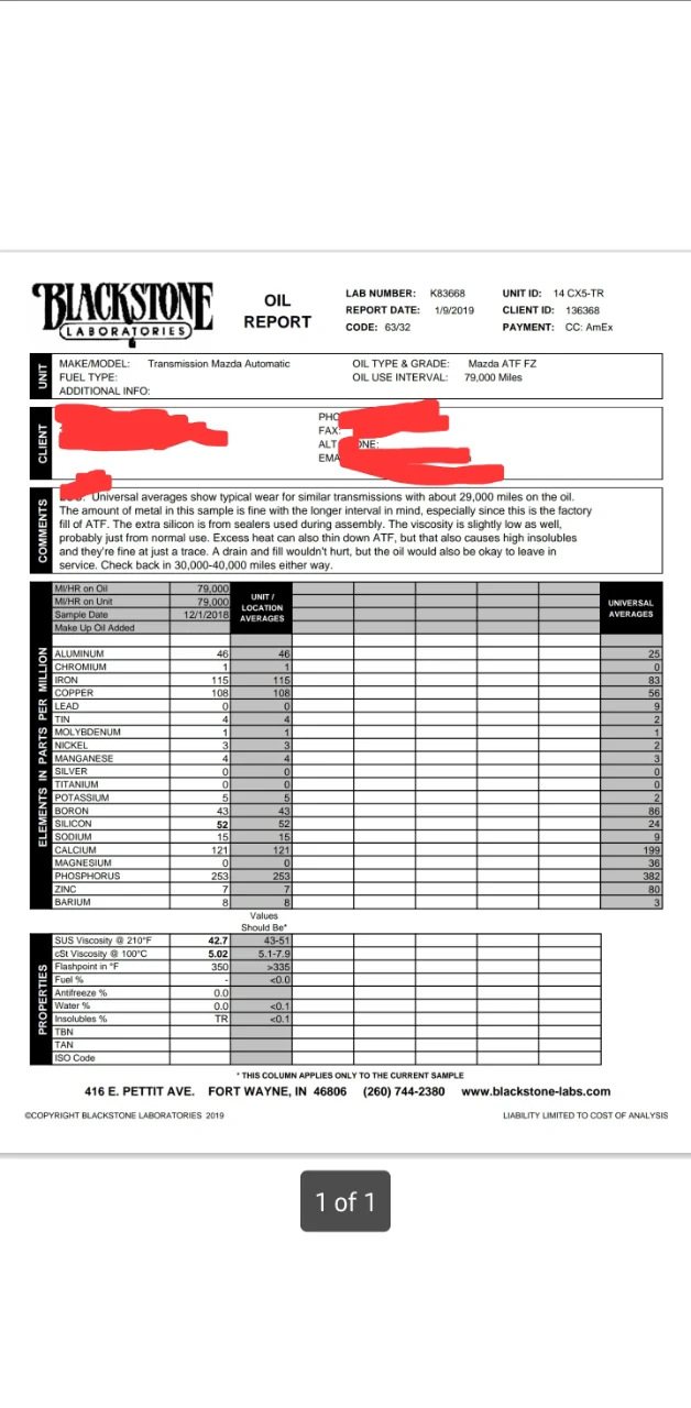

Dead post but if someone looks at it. Here is a oil test for the Mazda FZ. Clearly it hold well enough. This isn't the crap CVT Nissan /Honda that require you to change every 40-60k. Can probably hit 100k with their "Lifetime" without issue. I use that as part of my justification on buying Oem or at least Idemitsu brand.
