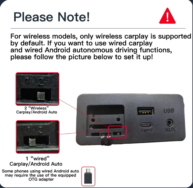

Sup, sorry for the late reply, some modules come with different toggles at the bottom of the SD card slot. Try changing the positions of those switches
