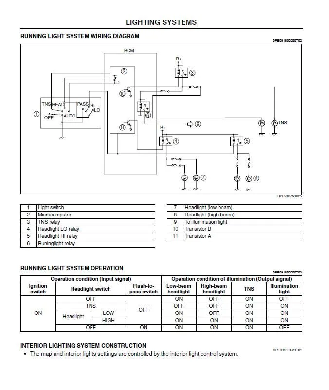

I'm not one to just ask but I've done a ton of searching on the subject and I'm unable to find a how-to. I am trying to disable my low beams as my drls and want to use my fogs. Where I live in Canada DRL's are law so I would like my fogs to come on when I start my 5. Any help would be great.

Do the lights go off when you apply the parking brake? I was sorting through some wiring diagrams. I did post a link to the Shop Manual as well.

From the diagram that you posted, I think the DRL module is missing because it just show the lo-beam connected to a relay getting power directly from the battery. This might be a US model diagram.
It would not be hard to come up with a circuit to turn the fog lights on to run them as DRL instead of the lo-beams. The hardest part is doing a nice wiring harness with the proper connectors to avoid cutting up the original factory harness.
We need an electronics person.
I don't have the wiring diagram for the Canadian Mazda5.
It is possible the Canadian MZ5 DRL is only a routine in the computer programming itself.

I spent a couple of hours yesterday coming up with a circuit to get the fog lights to go on as DRL instead of the using the lo-beam lights. From my experience with my HID conversion, I believe the lo-beam lights runs at reduce power when in DRL mode. This is accomplished by sending a Pulse Width Modulated (PWM) signal to the lo-beam lights. The ratio between the on and off time of the PWM signal determines the power (or brightness) of the lo-beam lights.
Based on this assumption I when ahead and designed a circuit, here is what I have come up with. I have tested it on a test bench and it works like this:
DRL off ----> Fog lights off, lo-beams off
DRL on ----> Fog lights on, lo-beams off
Lo-beams on ----> Fog lights off
With the lo-beams on, the circuit still allows you to turn the fog lights on. You can still manually switch the lo-beams and fog lights on and off using the factory switch next to the steering wheel.
As I have mentioned before the hardest part is to locate a source for the proper H11 and H7 connectors to build a wiring harness so one does not have to cut in to the original factory harness to do this mod. Here is the schematic, anyone with suggestions are welcome.
