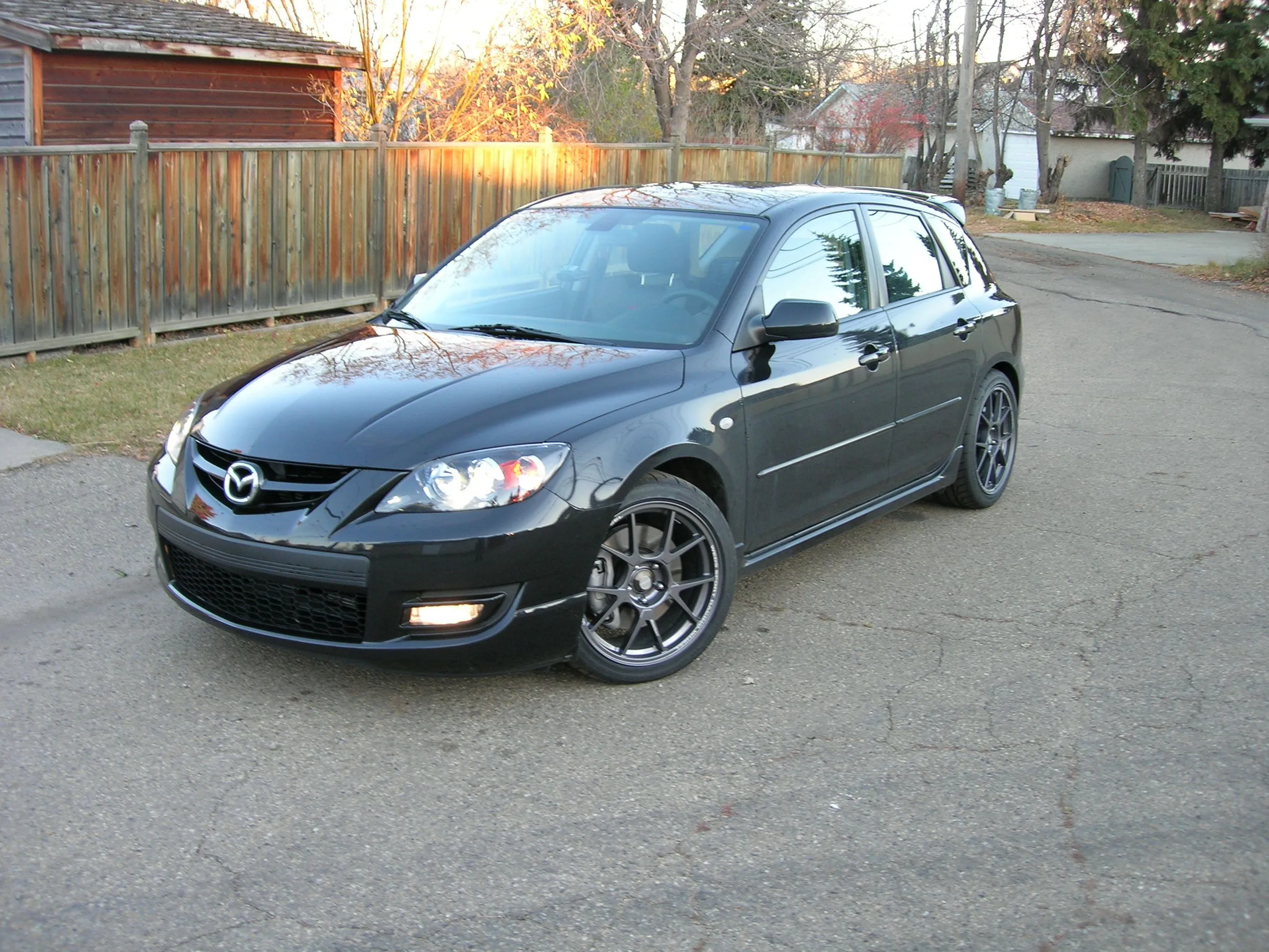

This is pretty "definitve" at least for the right offset: 18/8.5 53mm

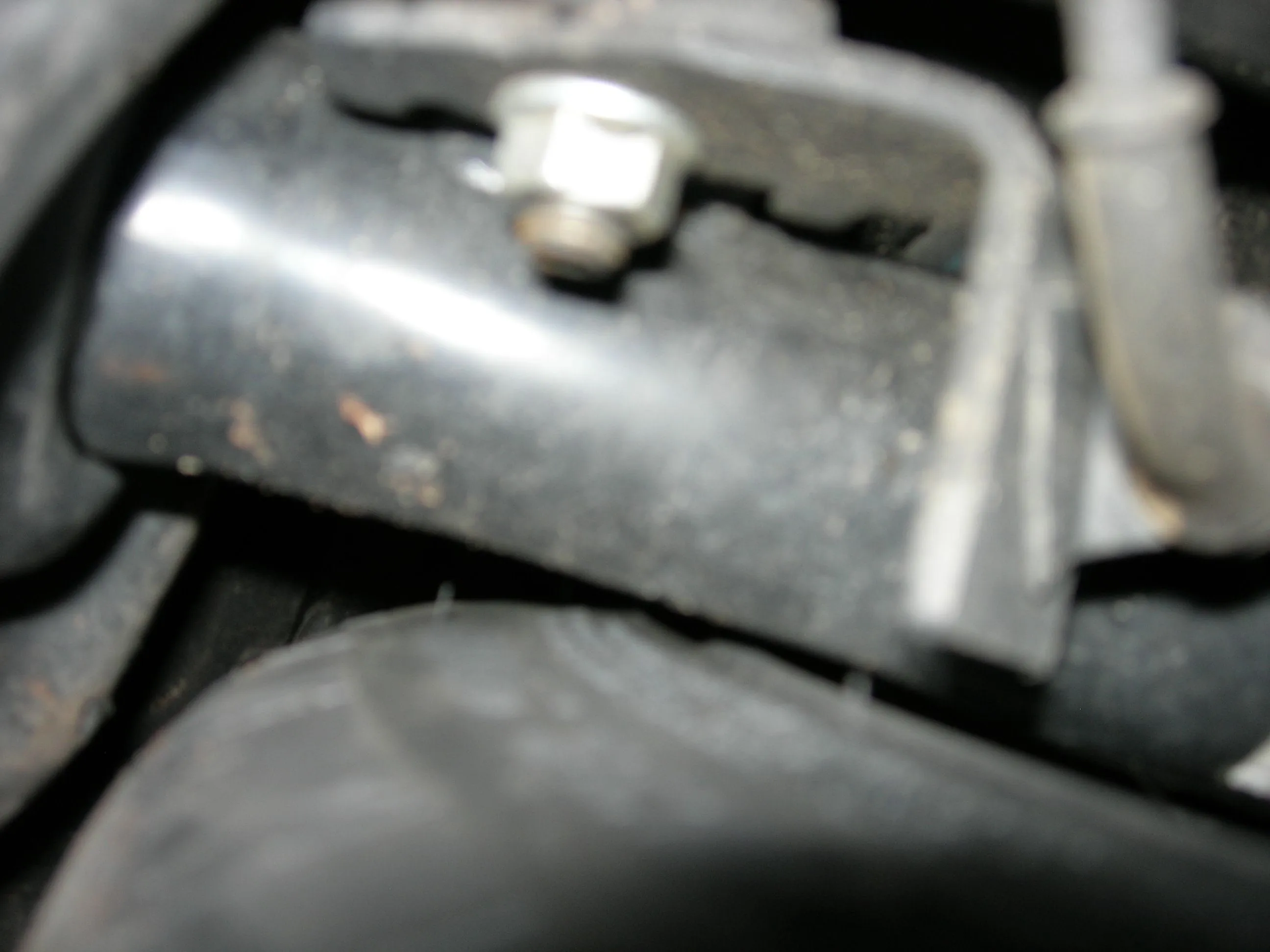

Anybody running wider wheels than this?

Looks like you cut that one extremely close. I will be installing a set of Mazdaspeed drop springs with a camber kit rights after the snow melts. It is after this that I intend to purchase new wheels and tires. I assume I should expect the same results as have been seen with the COBB kit. Why did you go with 8.5" instead of 8"? You should be able to mount 235mm either way, right? Do you think this would provide more clearance for the tire or just cause a balloon affect?
I think that wheel doesn't come in an 8 with the right offset. Personally, I LOVE his WEDSPORT (or are those Work?) wheels. Yes, it is extremely close, but if everything stays aligned right (no bent strut, no worn bearings) it should stay that tight without trouble. It is so close it just makes you cringe, but man the look on the outside is stellar.

I'm a big fan of 18's or 19's on this car. 18's seems nearly ideal given all the variables. A 48mm offset on an 18x8 or 17x8 will likely rub on a 245, but not a 235 (without rolling fenders, naturally.) Its SO close even with a 235. A slightly higher offset should work (say 51mm+), I know it seems like so trivial, but the tolerances are very close.
I went 8.5" for the crisp feel; 235 or 245 feels better at this width. I hate the sloppy feeling that you get when your tire is to wide for the rim. 235 is the highest you can go with an 8", 245 is really pushing it.

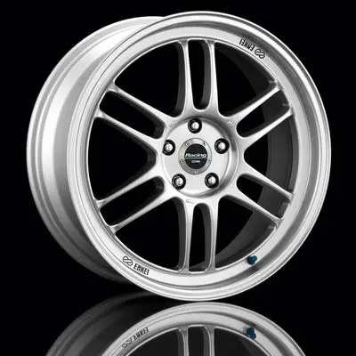

For me personally I am thinking about doing a 235/35/19 with the enkei rpf1 at 19"x8" with a 48 offset(wheel pictured below)

It might be awhile before I have the money saved up for that setup, but that will be what I am gonna go with. So figure when my stck bridgestones need replacement I will get my enkeis(the car is brand new right now with 200 miles).
