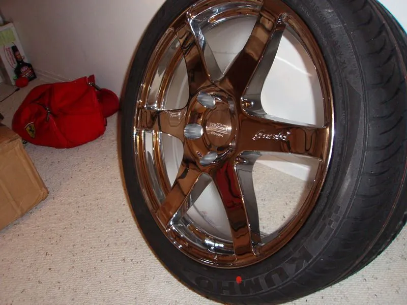

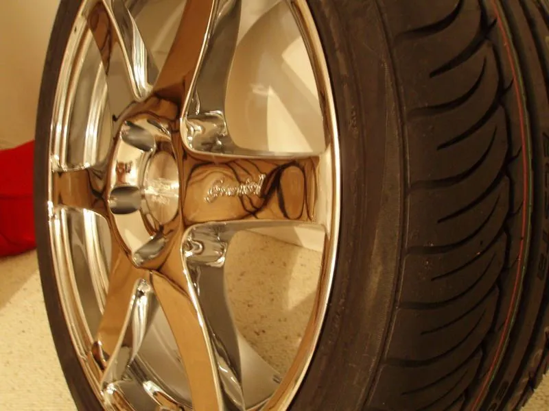

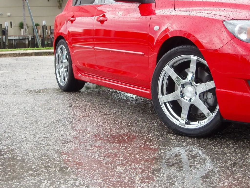

45mm offset
235/40/18-7.5
No drop,no rubbing even with 5 people on board.
How close funkyman? Do you think ~1" drop would make your setup rub? we have same size and offset wheel. Thanks!
1" inch drop would be the limit i think.I only had 5 people in the car once,but a 1" drop on mine would look awsome might rub occasionally with second passanger and stock set up.Again depending on how bumpy the road is.1" drop should be ok from what i can see on a flat surface with 2 passangers and no major bumps.
