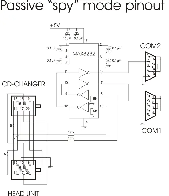

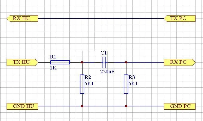

I test hardware like below, I wish can get data at PC when HU power on.
Thanks for your help.
