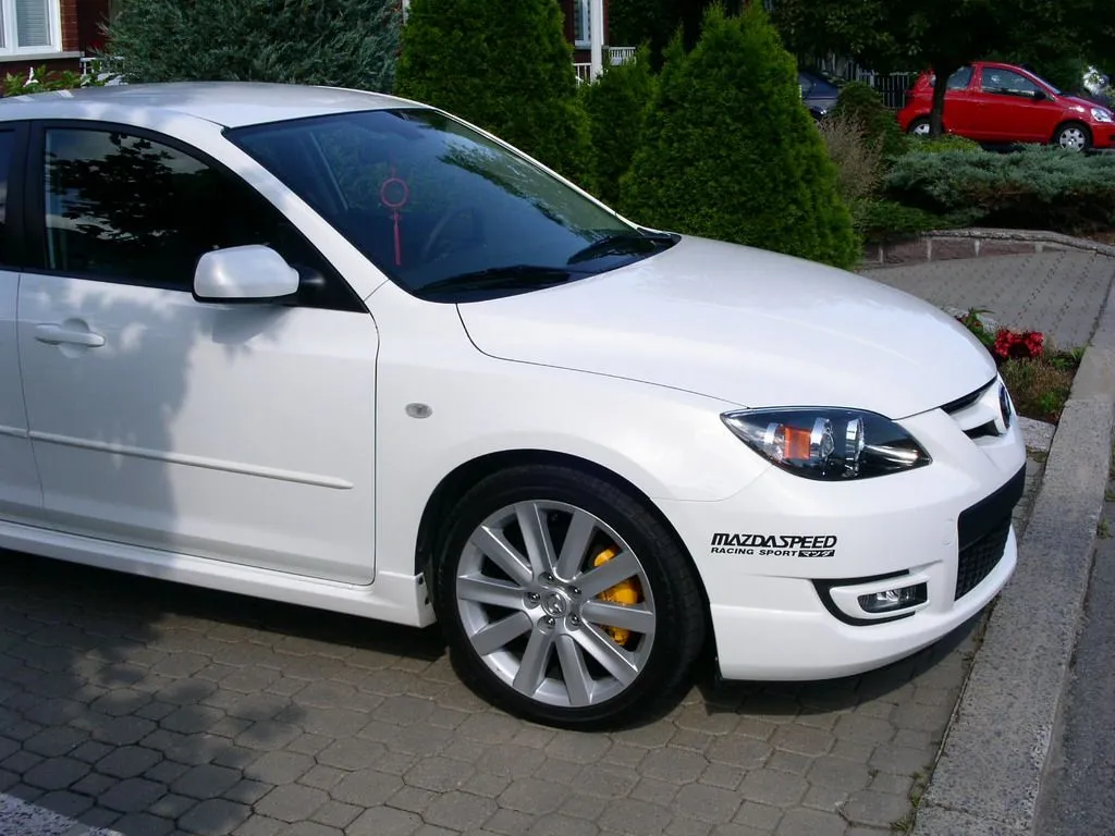

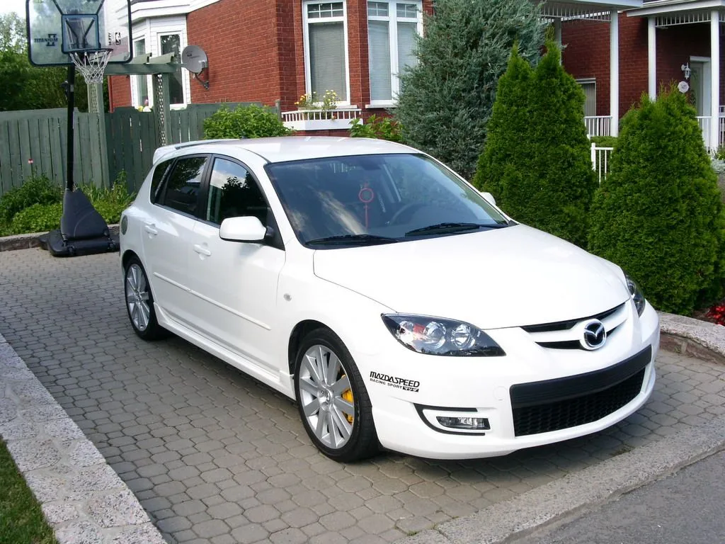

I painted them in yellow and they definitely look better than black imo

i think blue or red looks awesome with a black car...actually i like any color on a black car

no doubt, that thing is way sick. nice work on the calipers too, they look good.
