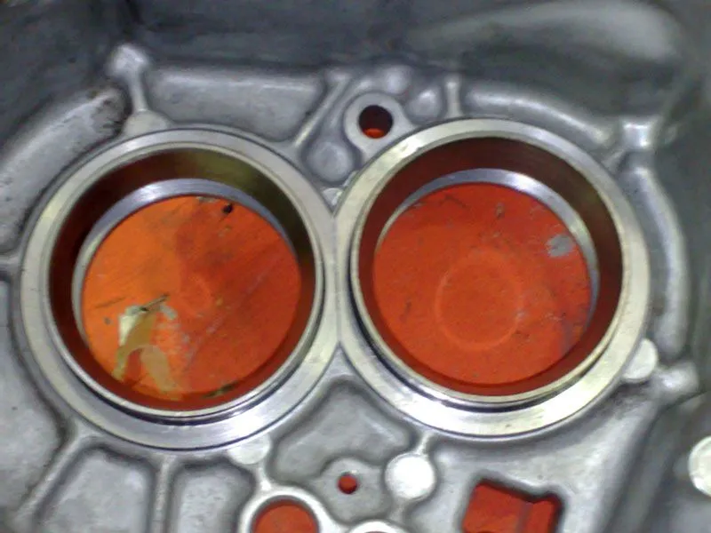

I've attached a picture of the reinforcement kit fitted to a G-Series housing.
Gerard,
Just to clairify, if we do NOT get the reinforcement kit then there is NO machining neccissary on the housing to fit your gear set. Correct?
Getting the strait cut gears should reduce streses on the case enough where we shouldn't need the reinforcment kit, but it would still be good insurace. Correct?

Yes, that is correct.
