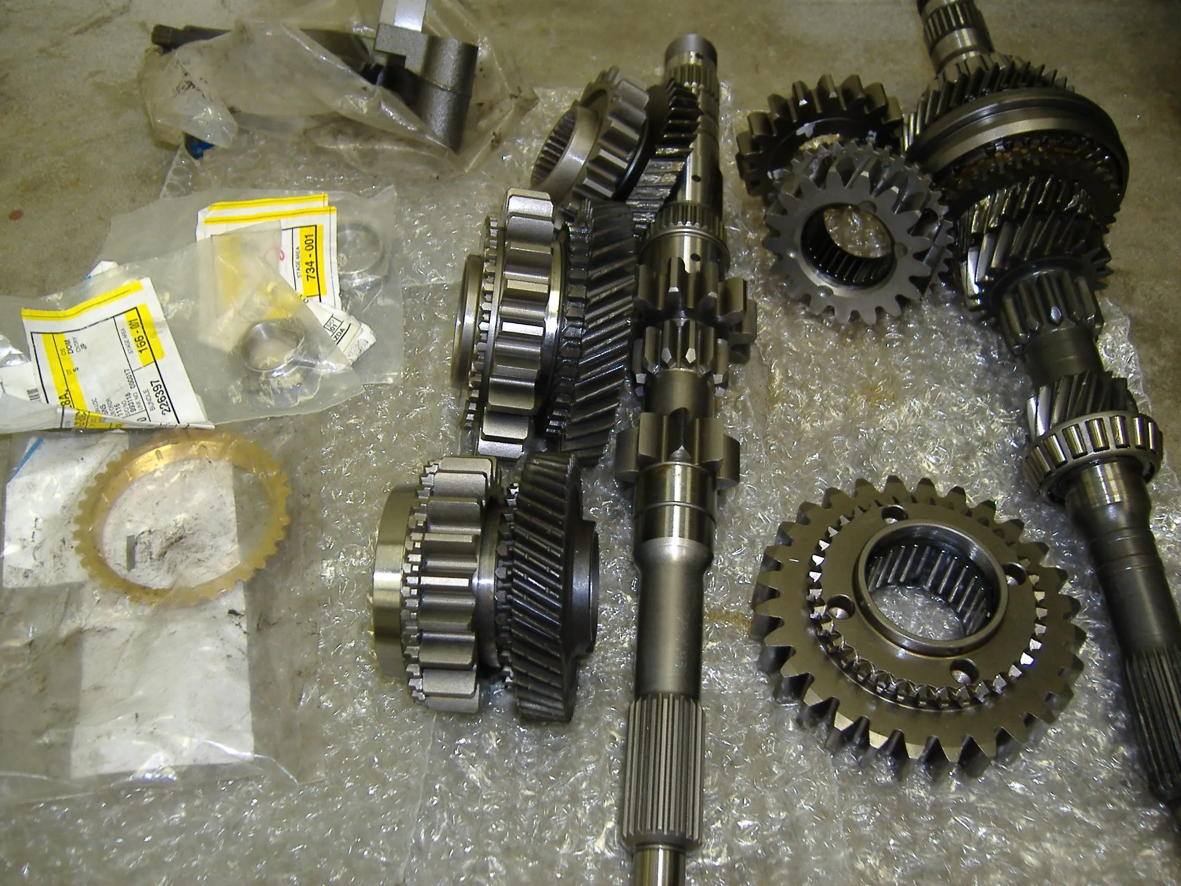

Broken 3rd gear x 3
Here's a pic with some of my old 02 tranny parts for comparison.
Double synchros on 1,2 &3 since they didn't have any 4th in stock so I just did single there and all have needle bearings. Gerard had to order the synchros for me from Japan since when I looked them up through Montgomery Mazda online they crossed over to our OEM synchros as a replacement.
FYI 3 double synchros came out to $340US with the $3240 PAR set along with my bank charged $99 for a currency exchange fee?? So came out to more like $3700 plus I'm waiting for quotes on new bearings and seals and 3/4 shift fork!

This is what they had in stock
