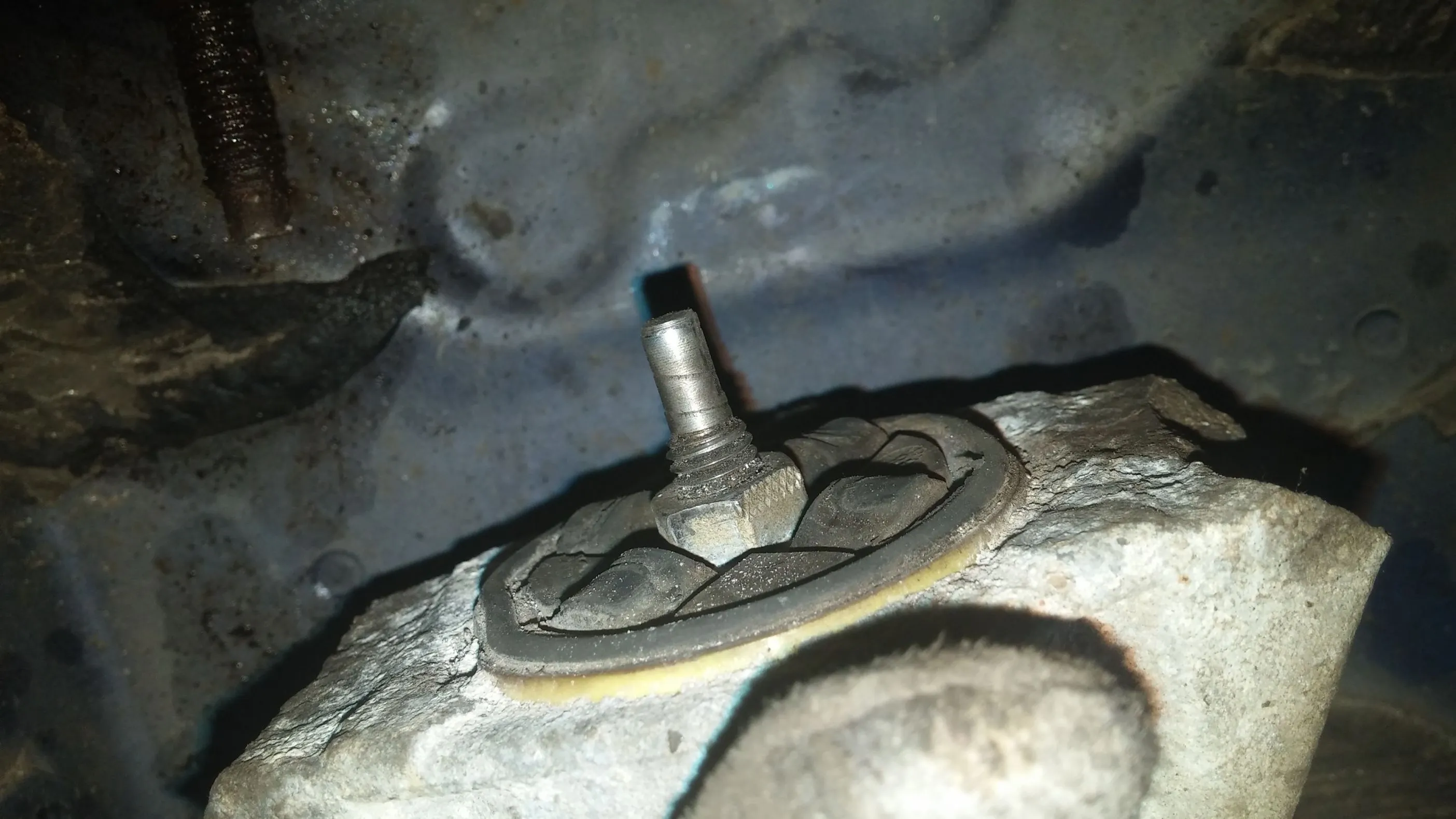

Mine broke this morning. You need a 13mm wrench, 12mm deep socket, breaker bar, ratchet, and vice grips
What was not shown above is the nut on top of the strut that holds it in place that is a pain. That is what you need the wrench and vice grips for. The top of the strut is squared off to allow you to hold the strut rod from spinning
EDIT: New nuts required 13mm deep socket. Torque to 20 ft. lbs.
