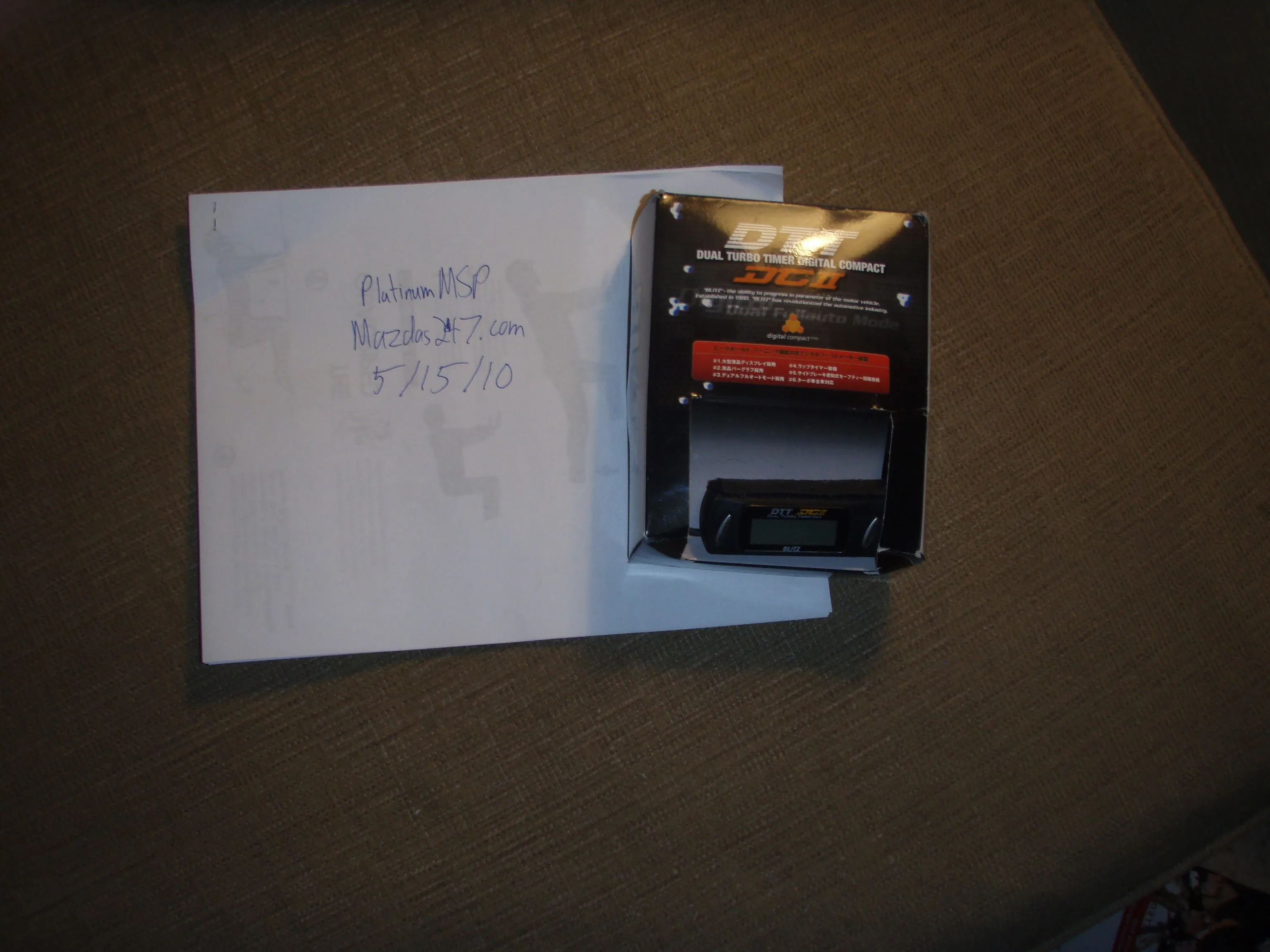

ok well i finished installing my blitz dual turbo timer today but i discovered a huge problem, the cars rpms drop greatly after taking the keys out of the ignition, sometimes the timer catches and brings it back to normal and sometimes the car just shuts off and the timer just counts down with the car off, i'd appreciate any help you guys could give me
i just swapped the blue and green wires and it runs perfect now, check it out, thanks for the awesome how to
So may I know what should be the correct wire orientation?
from the ignition harness to the blitz TT harness???
