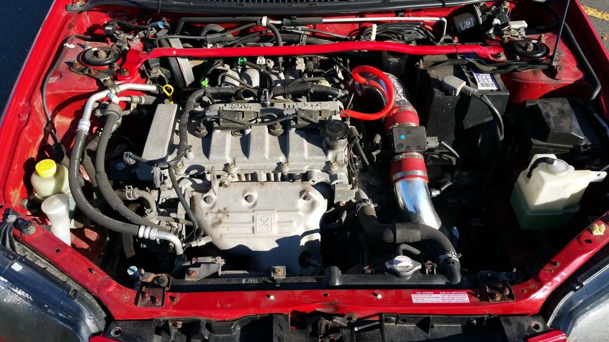

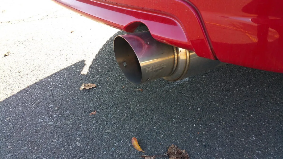

I have a Megan cat-back system with a 4" outlet on the muffler and a cheap short ram air intake on my 02' 5 speed P5. It's quite loud, very deep toned and causes all sorts of harmonic buzzes and rattles inside the cabin. At any RPM between 2000 and 5000 the drone is so annoying I feel compelled to shut off the engine and coast. As well, big systems tend to push horsepower and torque further up in the rev range, making the car weaker at lower revs. This is most noticeable in 3rd-5th gear.
