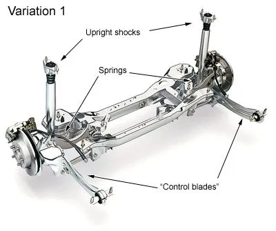

Camber will change slightly, however, when the eccentric toe bolts are adjusted (since camber and toe are inherently linked with the LCA "control blade" suspesion that the MS3 uses).

It only pushes it inward or outward at that particular link (i.e., the rear link), which is one of two lower control arms. The front lower control arm (the one that's shaped like a "dogbone" is unaffected.
As I said before, adjusting that eccentric bolt WILL change the camber (due to the relationship between suspension compression, camber, and toe with the "control blade" suspension), but that is not what that bolt is there for. It's for adjusting toe.
Using that bolt to dial in camber is a really quick way to throw your toe waaaay out of whack and destroy your rear tires.
**EDIT** If the diagram inserted above doesn't show up for you, let me know...I've had trouble linking to it before...
EDIT UPDATE: worked around the broken IMG link by attaching the .jpg...
