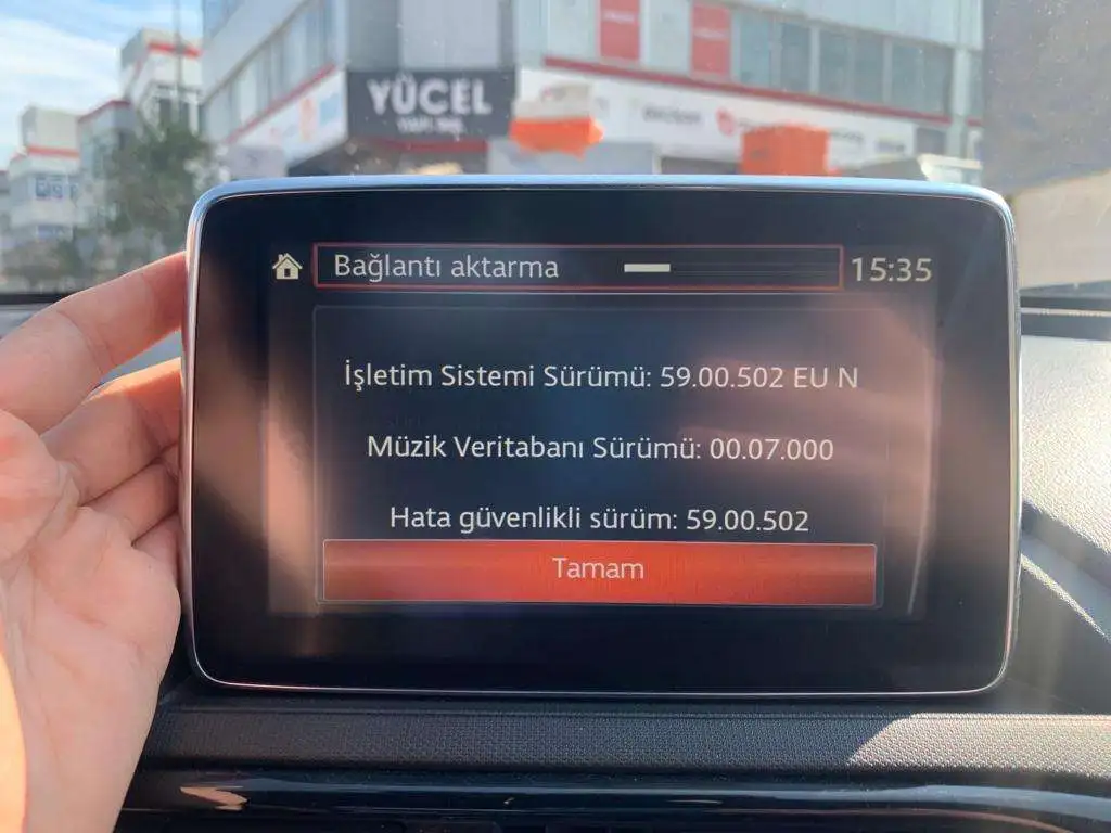

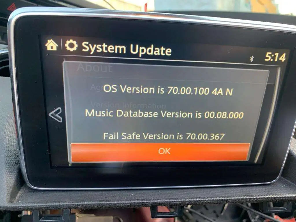

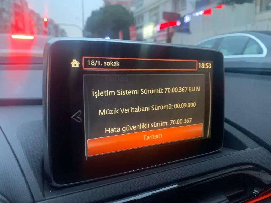

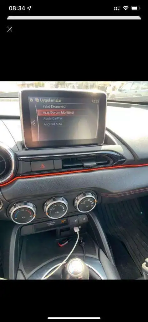

My car did not have carplay, so I ordered from aliex.. I checked and updated the system version. 59.00.502 EU AND TR LANG was the current version. After that installed 70.00.100.4A N because I dont any information for regional location and installed 70.00.367 EU N. Car play is okey but did not work properly through the media on the steering wheel.Mic not work,bluetooth has a problem. After that installed 70.00.100 EU.Everything is okey.All Car media is work but carplay it disappeared.
I tried again.
70.00.100 EU
70.00.335 EU N
70.00.367 EU N
BUT CARPLAY NONE. USB1 working but just for charge.Its not any data transfer.In touch screen nothing any message for usb inserted or removed.
Please help me... now firmware 70.00.367EU N
