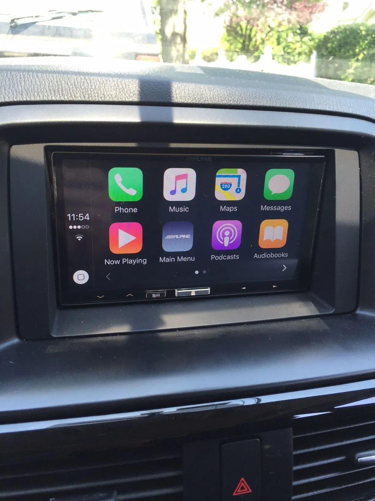

I placed my order for an Alpine iLX-007 unit. Its a simple Carplay centered unit. No bluetooth and no HD radio and no CD player. I am willing to give those up for simple iPhone integration. It comes on Thursday and i will have it installed on Friday. Will let you know how it goes.
CarPlay up and running
So it has been a week with my Alpine iLX-007 stereo with Apple CarPlay and I just got back from a road trip to Pennsylvania. I am so glad I made this move. It was expensive, about $800 all told with purchase and installation. CarPlay integrates flawlessly with iPhone. Navigation looks great on the screen and works well. Music app is easy to use and if you have Apple Music, all your suggestions and playlists are right there. Also used Pandora. Simply connect to the attached Lightening cable and you are up and running. I am already tied into the Apple eco system and use their Maps app and Apple Music. If you use Waze or another navigation system, then I would not recommend this. There is no bluetooth connection but I hated the bluetooth in the stock radio to begin with. And the plus is your phone charges while connected. Any questions, just ask. Attached is a picture of CarPlay

Where did you brought it and did you installed it yourself? I always wants to do something about the head unit, but after all I am not sure again.

That looks great, thanks for posting up a pic. I will give it a couple of more years for the prices to go down before I get a similar unit.
If you use Waze or another navigation system, then I would not recommend this.y
Does that mean that Google Maps does not work at all? That would be the only reason I'd want to do this, so I could have traffic-aware navigation.
What about the car settings you adjust using the oem hu?
At the moment there aren't other navigation apps for CarPlay. I believe Apple is only allowing third-party music apps for now. That will probably change as it becomes more common.
