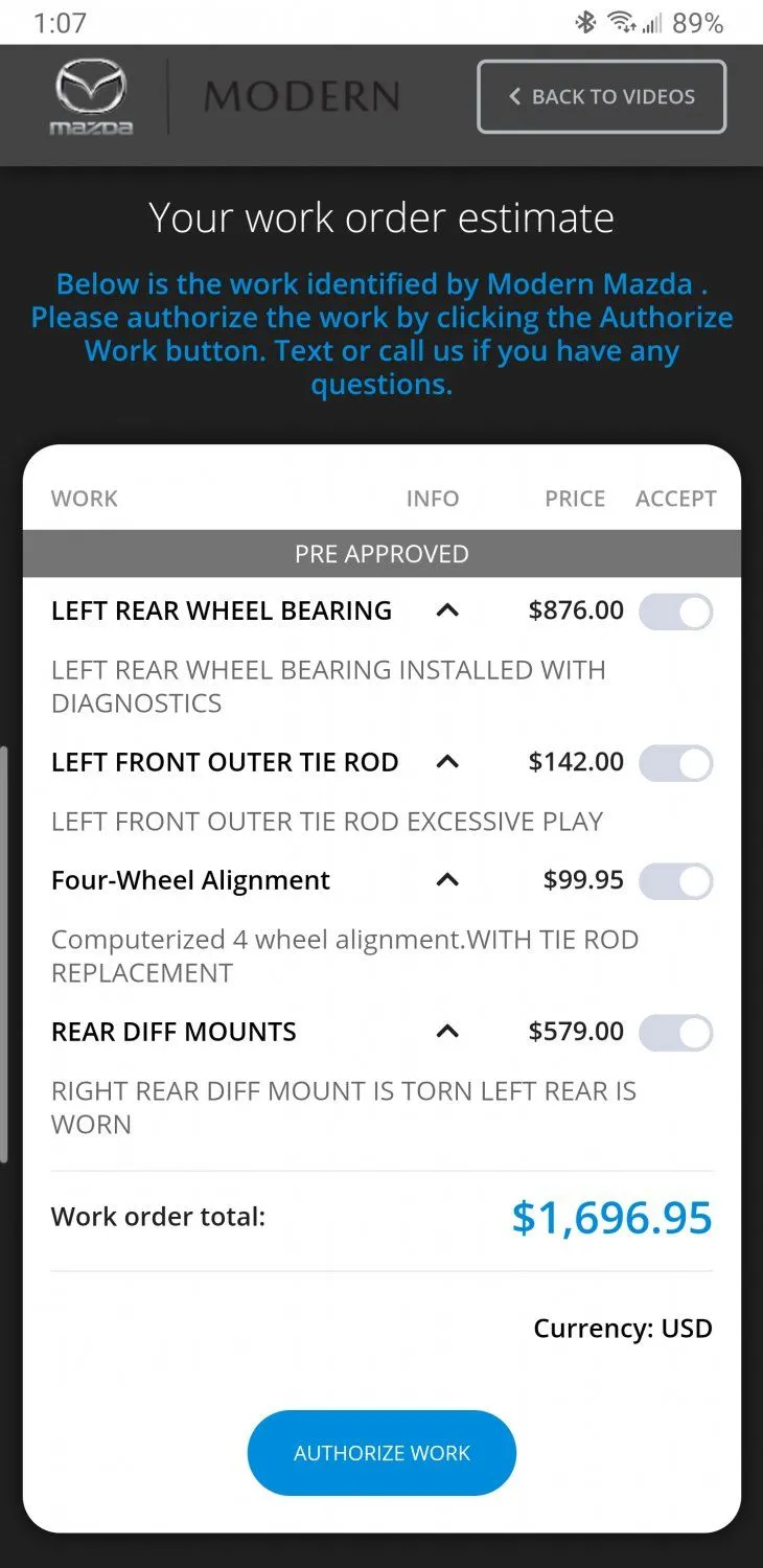

At 114k, getting the third wheel bearing replaced. Does this seem expensive for one rear wheel bearing parts and labor, $876?
they are charging you about 600 for labor. Even though it says diagnostics. It shouldn't take no more than 1 hour diag time. What is their hourly rate. You take their hourly rate and add the cost of the bearing which goes for about 150 on rock auto for the timken with delivery and probably tax and subtract from the total cost. I would say buy the bearing from rock auto and have an indy install for you would be much cheaper. Then have mazda do the rest of the work. I say this because i think that they are the only ones that have the diff mounts in stock.
Yep, would be cheaper to order the bearing myself and take it to a shop, but I do need it done today as I don't have much flexibility in my schedule and am willing to pay for the convenience. Repairs at the dealer are usually more expensive, but thought these seem excessively so.
