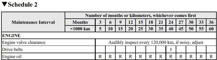

And where does the manual say change the oil at 3-5k again?
I drive 20k per year too with mixed city/highway, replace filter every 5k and oil/filter every 10k using full-synthetic 0W-20. This is in my 15 yo daily driver with 286+k miles, but the 5 follows the same interval less frequently.
Let's not be so selective in what you're commenting on. The 3/5 say 5k-7.5k so we'll keep in context for sanity's sake.
I just don't want people reading something and saying to themselves "Gee, since I drive on a dirt road for 1/2 mile in Florida (I do), then I should either change my oil every 3k miles or switch to the magical AMSOIL and not even think about it for about 5 times longer."
So for sanity's sake, I just wanted to clarify what the manufacturer's actual service intervals are not 3k miles - ANYWHERE.

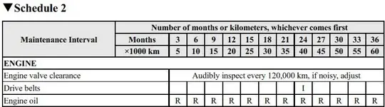

More fuel to the fire: I just checked my user manual and it clearly states, if you drive in the city, change oil every 8000km or 5000 miles.
This is true for the 2012+ Mazda 5, I'm not sure what 2008 has in the manual.

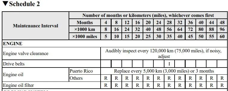

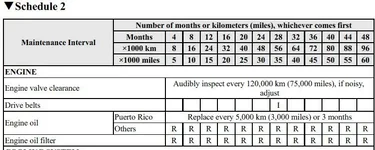

What's really interesting that in Mexico and Puerto Rico you are suppose to do 3000 Miles or 5000 Km.
I wonder if it has to do with the warmer climate and shittier road conditions or what.
