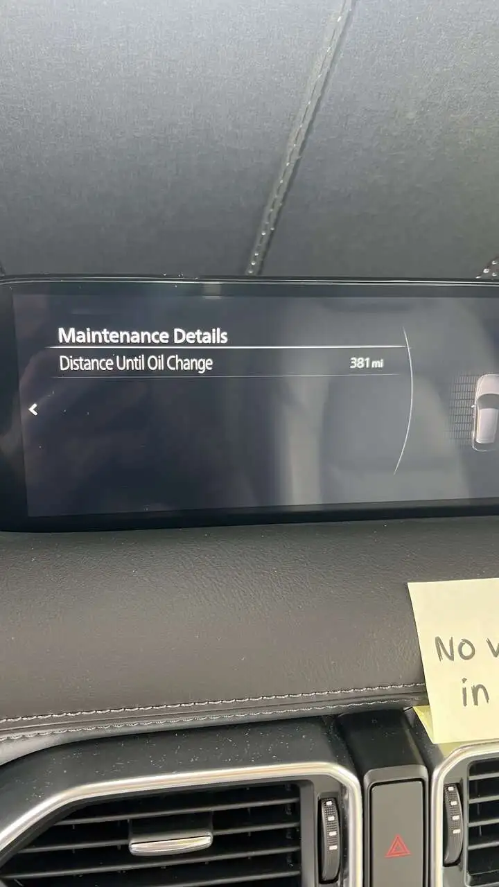

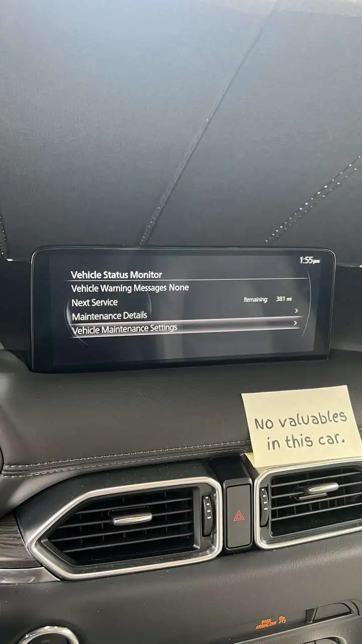

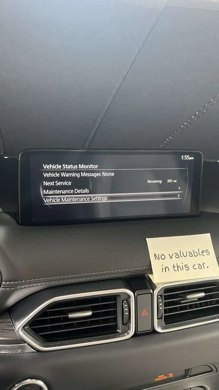

This is my 3rd change at under 10k mi. I dont remember seeing that triangle with number 1 lol.
“Vehicle warning messages” says none. If I click “maintenance details” says only oil change.

So “master warning light” is shown every time there is maintenance/issue but the Multi Info Display (“oil change due” with wrench) actually tells you what the issue is it seems.
But how do you know number 1 is the number of issues like oil change for me?

You can always clear the message by going to Applications -> Vehicle Status Monitor -> Maintenance -> Oil Change (in your case) and increase the Distance. 1 is for one item. If you had tire change due and oil change at the same time, two items, you should see number 2 in the triangle: two items requires your attention.

I cleared the "oil change due" and set it to auto, since it seems auto goes by time + mileage. Last oil change done at 6,900mi 1/2023 w/600mi left, this time 9,941mi 3/2024 w/381mi left.
