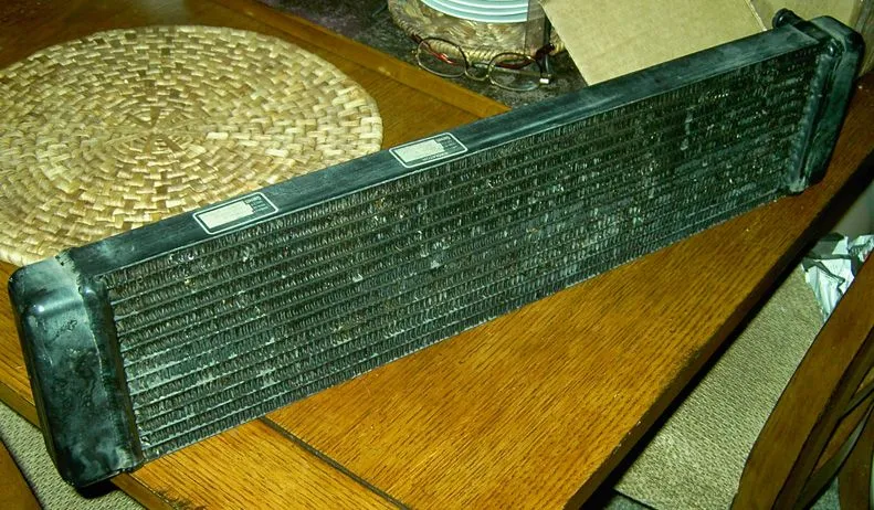

got a new heat exchanger on the way. its 29Lx6Hx2.5" deep. shazaaaam.
new heat exchanger! the other one fell through, apparently customer service isnt what it used to be. I thought money in hand was important but apparently its not so important anymore.
so i got this used one for 50 bucks which is leaps and bounds better than my other one. a lil paint and a power wash and itll be good as new. the flash makes it look worse than it is.

SO I dont get it..YOu run a Air to water...In lieu of a FMIC..but then you put a Heat-X(FMWC) in its place.
