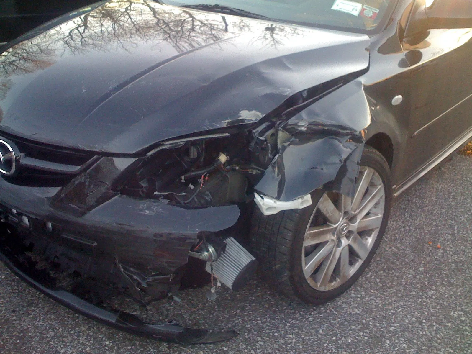

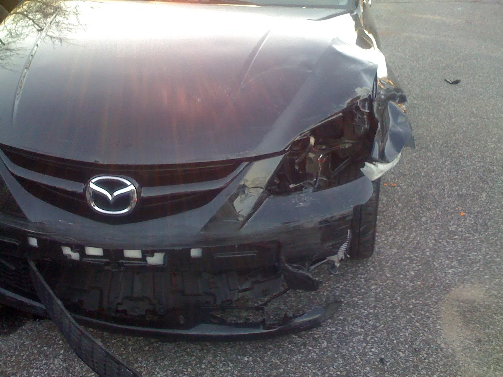

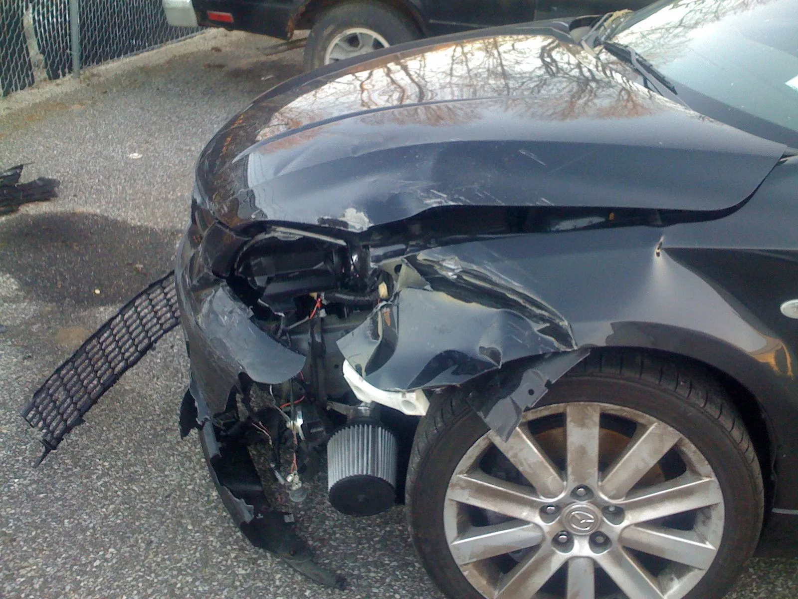

35 mph, unlicensed driver blew stop sign. Thank god for seatbelts. Wondering if anyone knows about any air bag sensor defects? Radiator is mashed up good. Windshield is broken. Oil leaking from somewhere?

Are you wondering why yours didnt go off?
Likely not enough speed involved in the crash by your car.
Car needs to be moving a certain speed I beleive for them to be active to go off in a crash.
My son was in the car so I couldn't do a thing. i was doing 35 didn't even tap the brakes. If I wasn't wearing a seat belt i would have got f..... up. I know it was off set but the main support behind the bumper, it is some sort of metal tubing was flattened.
Offset frontal won't usually hit the bags.
This as well..Not to mention th hit doesnt look to be that hard...From that angle if it didnt get the frame, which from looking at your pics looks to be unscathed.....They wouldn't go off either.
are you saying your air bag didn't deploy? my car doesn't look that much different from yours and mine deployed, and i think mine was at less speed than yours. although i think mine looks slightly more frontal and yours looks a little more off to the side
SOmething was a factor for it not to deploy....The SRS sytems are pretty smart these days.
They are not cheap to replace...so we dont need them going off if they wont help in the type of crash you're being involved in.

The system knows whether you have your seatbelt on your not. The threshold for deploying the bags is lower if you aren't wearing your seatbelt. So no belts may have equaled air bags going off for this exact same crash.
