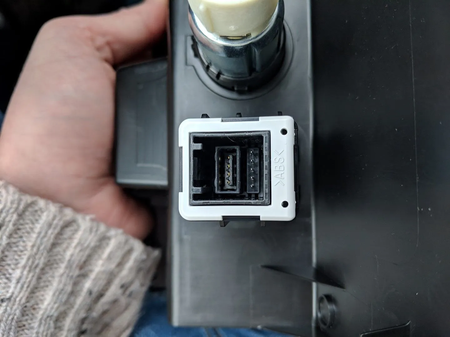

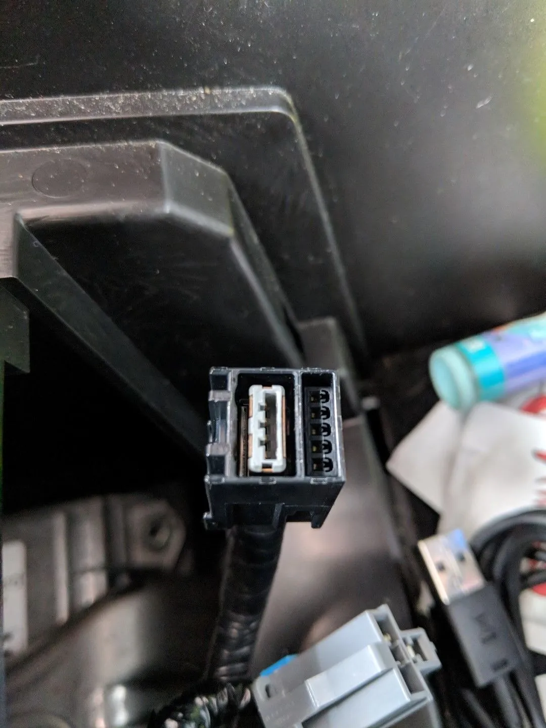

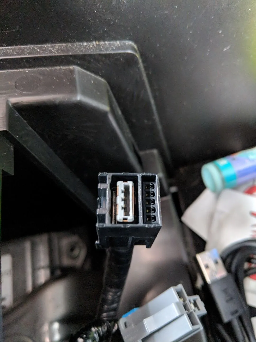

OK, so I started looking into this topic in preparation for my upcoming aftermarket radio. I'd hope to be able to pull off the connector pins at the back of the factory radio, but it turns out you can't :(

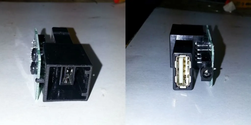

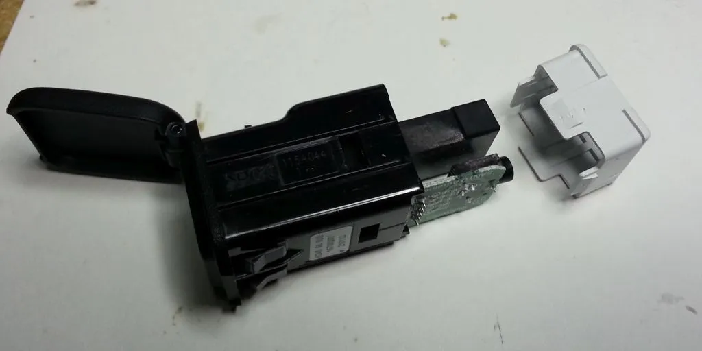

I have the schematics of the wire connections and connectors, but nothing tells you which wire is which function. So I just pulled the Aux/USB box from out of the center console. Remarkably easy by-the-way... 5 mins tops. See the last few photos at: http://www.mazdas247.com/forum/show...t-Shiny-Trim-Head-Unit-and-Center-Floor-Piece - Thanks TreyP!

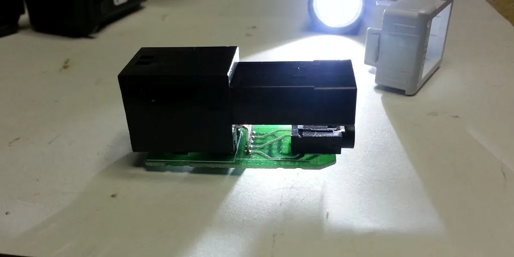

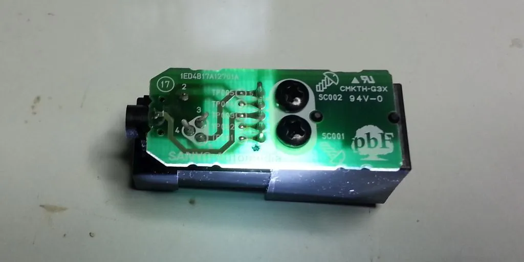

I then proceeded to pull it apart so that I could trace the pins/wires. You just unclip the 'ring' at the rear, and the innards just push out from the front (photos attached). What I found is that although the Aux jack wires *ARE* routed direct to the radio, the USB connector wires go to the Bluetooth module instead (and then presumably are passed-through to the radio as a straight audio signal). But given that BT will be disconnected when the factory radio is removed, it's likely the pass-thru will no longer work. This does explain why some folks have had the Bluetooth unit replaced to cure the notorious USB drive corruption issues, rather than the radio.
So now, I'm working on whether to use the OEM box and either hack into the connector+harness or pins in the box somehow. Or replace the factory USB/Aux box with some other connector setup (and have to doctor the plate inside the console), using something like this:
Here's the photos of the innards. The jack contacts are just routed to male connector pins. The USB is a straight-through to something like a cut-down USB socket at the back. A regular USB plug might fit in the back there with some trimming.
RedBaron, what you decide to do? I’m also considering hacking into the USB/aux wiring to retain the factor box. Otherwise, looks like it could be pretty easy to cut a hole for a new box adjacent to the factory box. (I have a Mazda6, but the setup is identical.)
OK a brief writeup on what I did. Here are some photos and steps, but these are mostly just hints (if you have to ask more, you shouldn't attempt :))

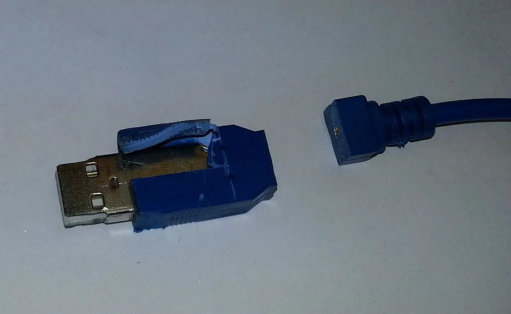

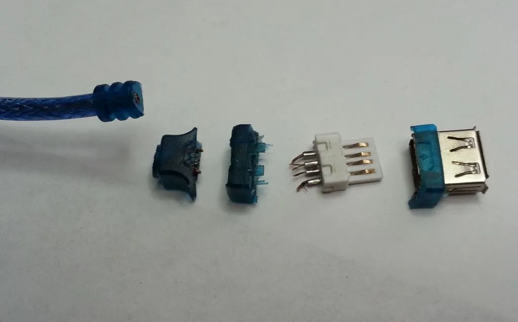

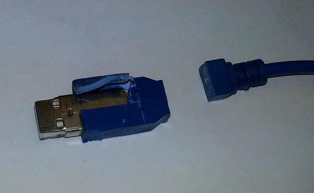

I had a number of different prototypes for this. The final/best way I found was to take a cheap dollar-store male-female USB cable and modify it (heavily) to create an adapter plug that fits into the back of the factory console connector (see bottom left photo above). Plus, then you'll need a SECOND USB cable to solder to the adapter you build from the first cable - that's long enough to reach to the back of your radio.
1. You have to take the both male and female plugs completely apart. This shows the female end, but all you need from this end is the insert piece (white plastic and gold contact pads). You need the female piece because the contacts stand up away from the pad. (The male end contacts are flat and won't touch those in the factory connector).

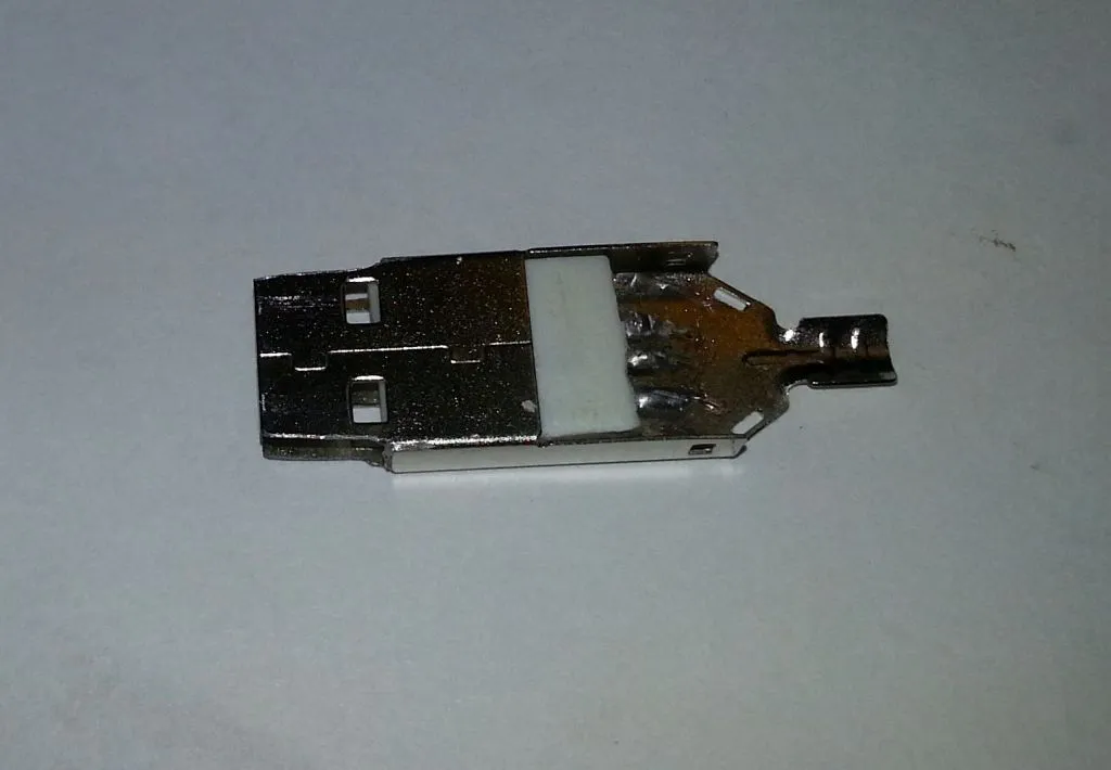

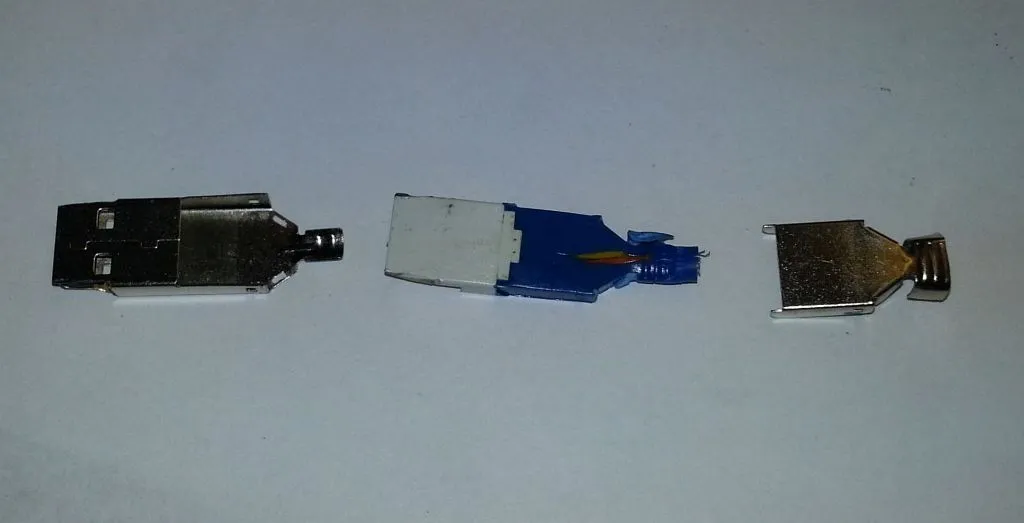

2. Now to the male end. First grind the front sides of the connector down, using a Dremel or grinder (or a metal file if you're careful). You just need to go in enough that the connector will fit into the factory one. Basically, just grind off the metal sides until the edge of the white plastic of the insert is exposed. The metal is soft, so this is pretty easy - be careful not to go too far.
attachment.php
3. Once that's done, cut away the cable, take the shell apart and discard everything except the metal shell pieces (far left and far right, below).
attachment.php
4. Now insert the contact innards from (1) into the shell from (2). Cut off the end of your second USB cable and solder the wires onto the insert piece (normal color code and order for a regular male plug http://image.pinout.net/pinout_USB_files/usb-pinout-diagram.gif).
attachment.php

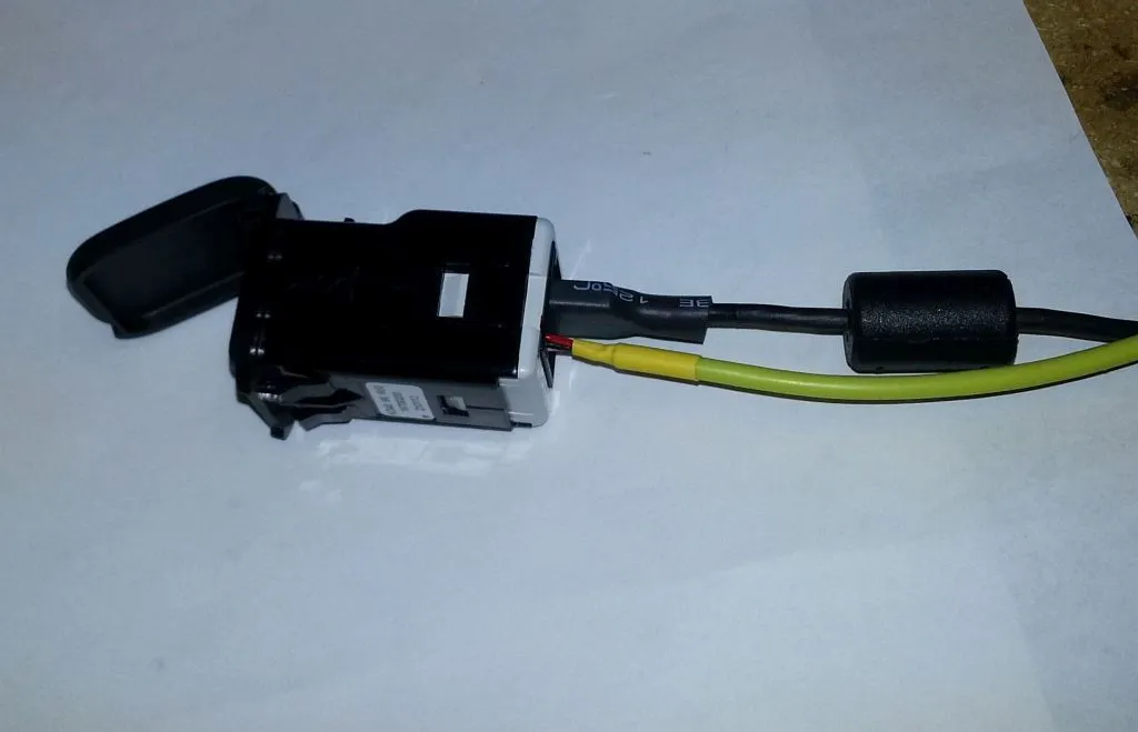

5. Reassemble the shell loosely and insert into the back of the factory connector - be sure to 'buzz' the whole thing out with a meter before you finish it up. It should be "straight-through"... the leftmost pin into the front of the console connector should align with the rightmost pin at the male end of your constructed USB cable (etc.). Then when you're sure, close the shell up properly and solder the cable braid to some convenient point on the shell. Cover the rear half with some heatshrink tube (optional) and you're done.
This is my adapter+cable inserted in the back of the factory console connector (Yellow wire is AUX cable)...
