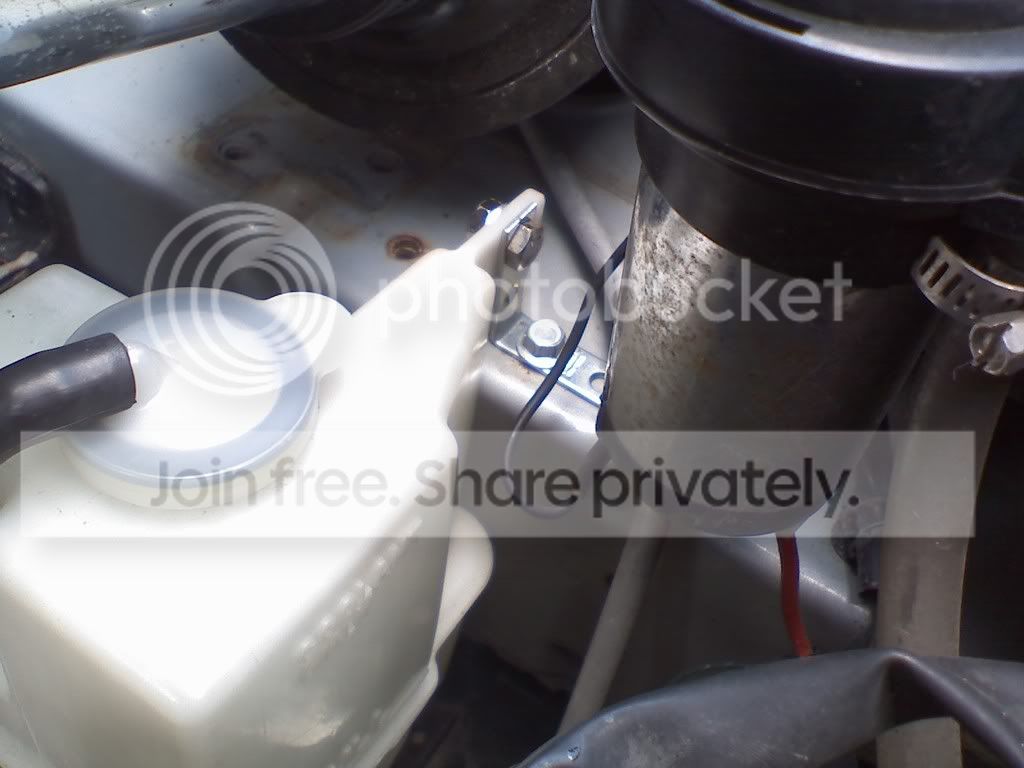

thats why i reversed the piping after the maf where the filter is on the original maf end and the maf is on the original filter end (i hope that makes sense) that way the bracket faces downward
sorry to bump an old thread but i figured i would contribute my 2 cents. i switched my intake around and relocated the overflow right under it using an angle bracket and the tab on the top of the bottle.
idk if anyone already did this but if not then its a good place. bottle dosent move at all

I've got an AEM SRI but I have no idea if it is helping my car or not (I baught the car used from a person that had it baught/installed himself). I'm pretty sure its the standard installation (by the engine). It does seem like having it on the side has cooler air. So, will moving it to the side definatly be useful?
switched my aem sri to the new spot, I have to admit I'm kind of worried about how sturdy it is in its place. Yes the dry flow would probably be quite snug, but my k&n filter, even with my heat shield attached, seems a little wiggly. I moved my coolant resevoir to the whole on the side of of where it used to be mounted, little bit lower, but it works. Other than that, growl is louder, and I believe I can notice a stronger pull. I'm also cleaning my filter as I type this, so we shall see how it really does.
ive had mine like this for about 3 weeks or so now and i deffinately noticed a change. pulls harder in all gears between 3000 and 5000 but most noticably in 2nd and 3rd. i also havent had a problem with it just kind of sitting in its position. i had the hood open and gave it a few good revs and it looked pretty solid.
