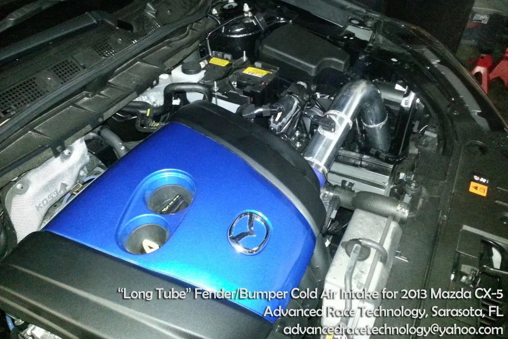

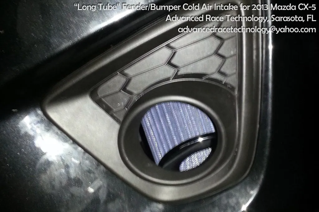

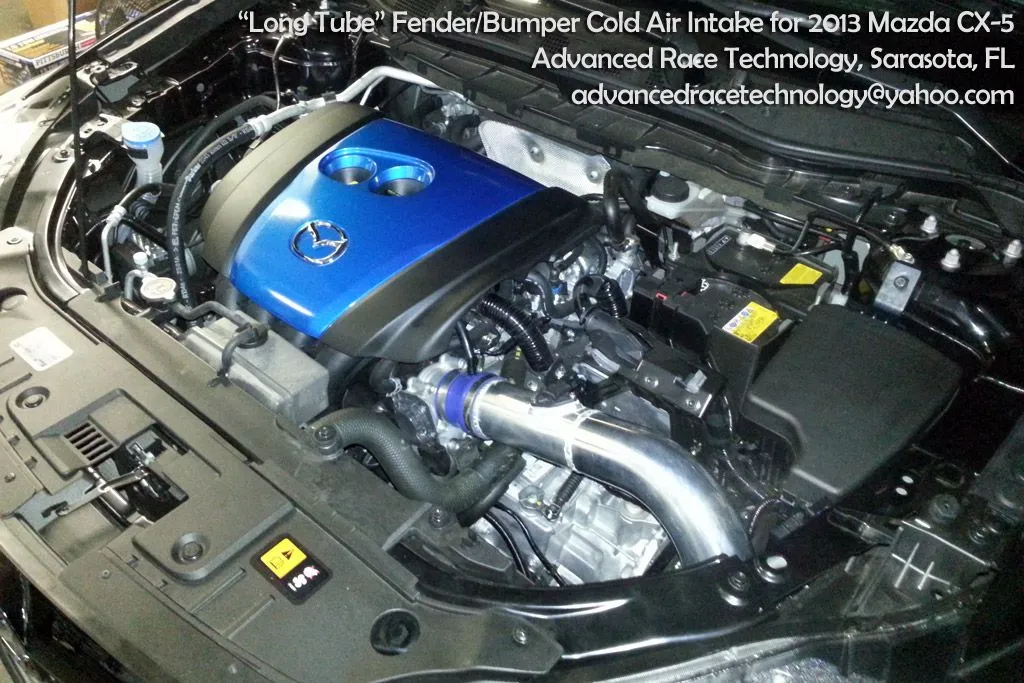

My RX-7 is waiting on a new 20b (3 rotor) to come in, so for the time being I've started to play with my 2013 CX-5 Grand Touring "daily driver"... :D
I just had my friend over at Advanced Race Technology (Sarasota, FL) fab up this custom "long tube" cold air intake for my CX-5 Grand Touring. The filter sits just behind the fog light, so if you wanted, you could remove the fog light for a ram-effect, but I kept the fog light in place since it seems there is still plenty of opening down there for cold air to be pulled from the bumper/fender area (instead of the hot engine bay, as you would have with CorkSport's short intake kit).
Right off the bat, I can tell you there is a definitely change in the sound tone of the car under acceleration. It sounds a bit more "throaty", and it slightly louder. Advanced Race Technology has an in-ground dyno right in house, so we're going to dyno the car with the stock airbox, then dyno it with the longtube intake. For now, I'm trying to see how average gas mileage is affected. He said if there is demand he can make more of these.
Keep in mind this is a quick prototype fab job and not production version quality. The production version would have less welding, and a true billet CNC MAF mounts.
A few pics:

Is that filter boxed in down behind that fog light hole?
The angle on the photo makes it hard to tell exactly where the filter sits. The filter is actually positioned just behind & above the fog light area.
