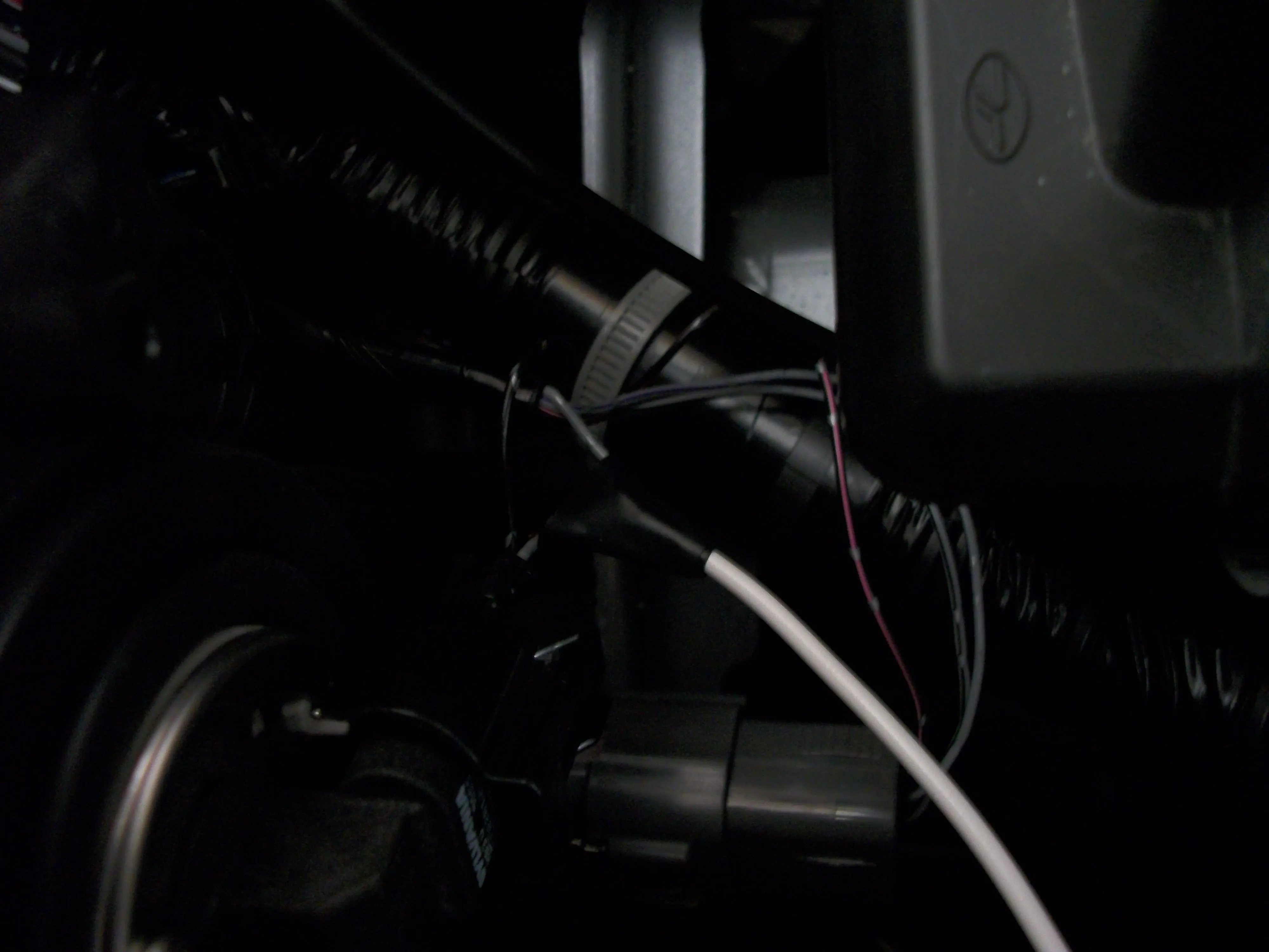

Connect the white wire to the gray wire on the high beam circuit (12V when high beams are on). You can use the wire taps; however, I soldered the connections because I couldn’t really reach in to squeeze the connection shut.
Connect the orange wire to the gray wire on the low beam circuit (12V when low beams are on).

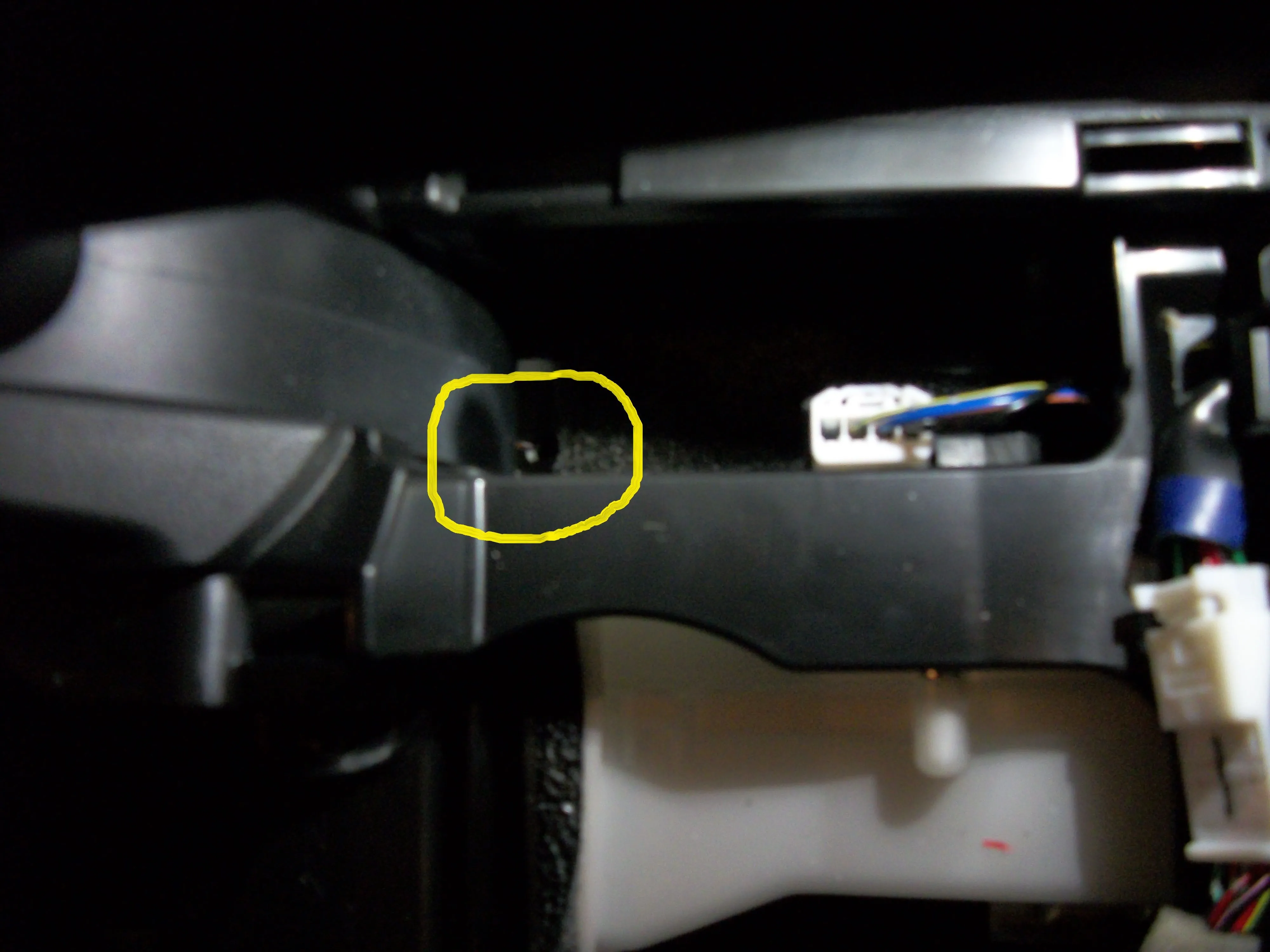

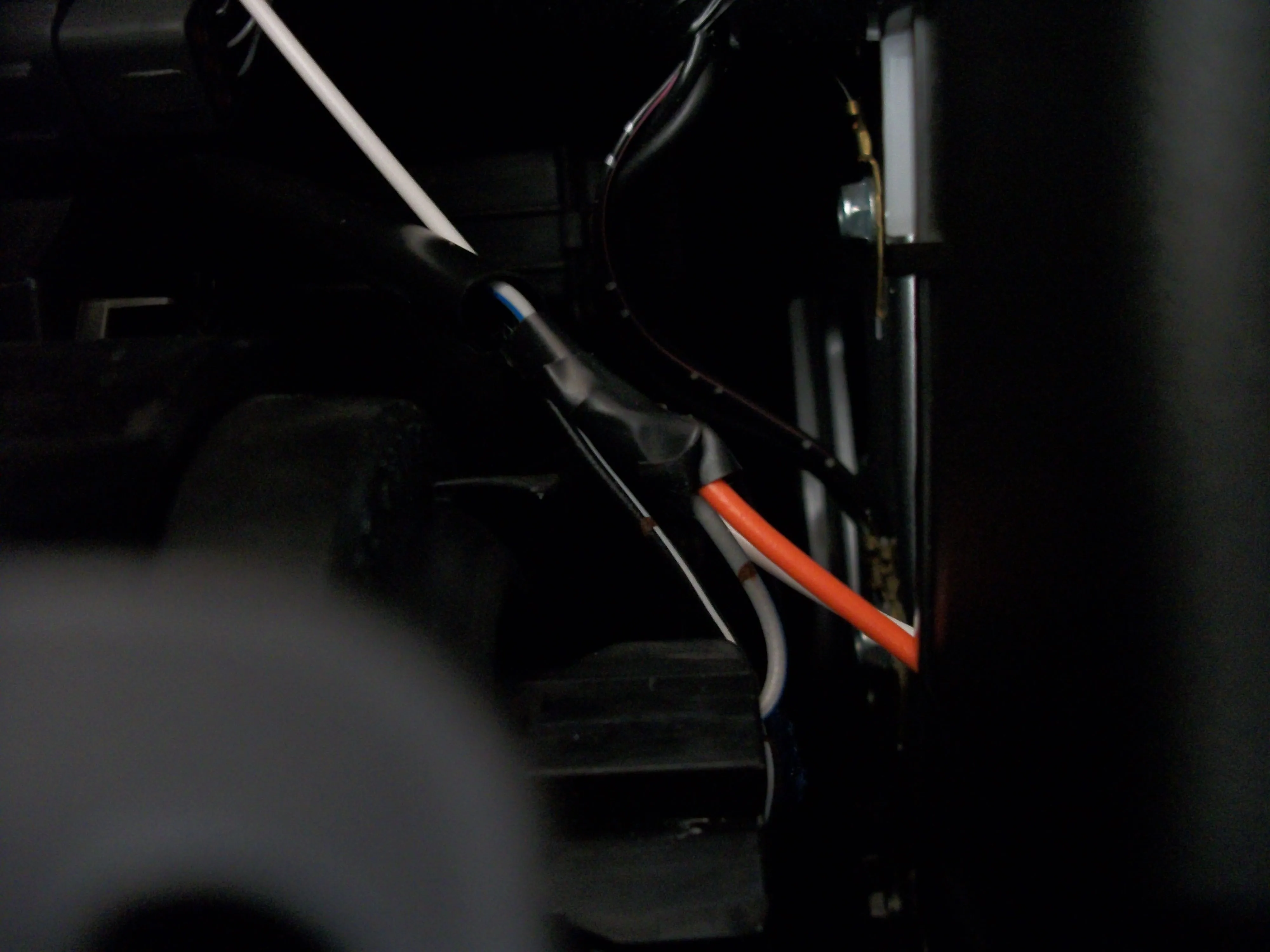

The yellow wire is connected to the brake switch, so the DRLs turn off when the parking brake is on. Connect the yellow wire to the tan/white parking brake switch wire. To reach this wire, pry out the cup holder panel. The parking brake switch wire is located closest to the front of the parking brake. Because this wire is further down in the console, you may need to loosen the two screws at the front of the center console panel to lift it up to reach the parking brake wire.

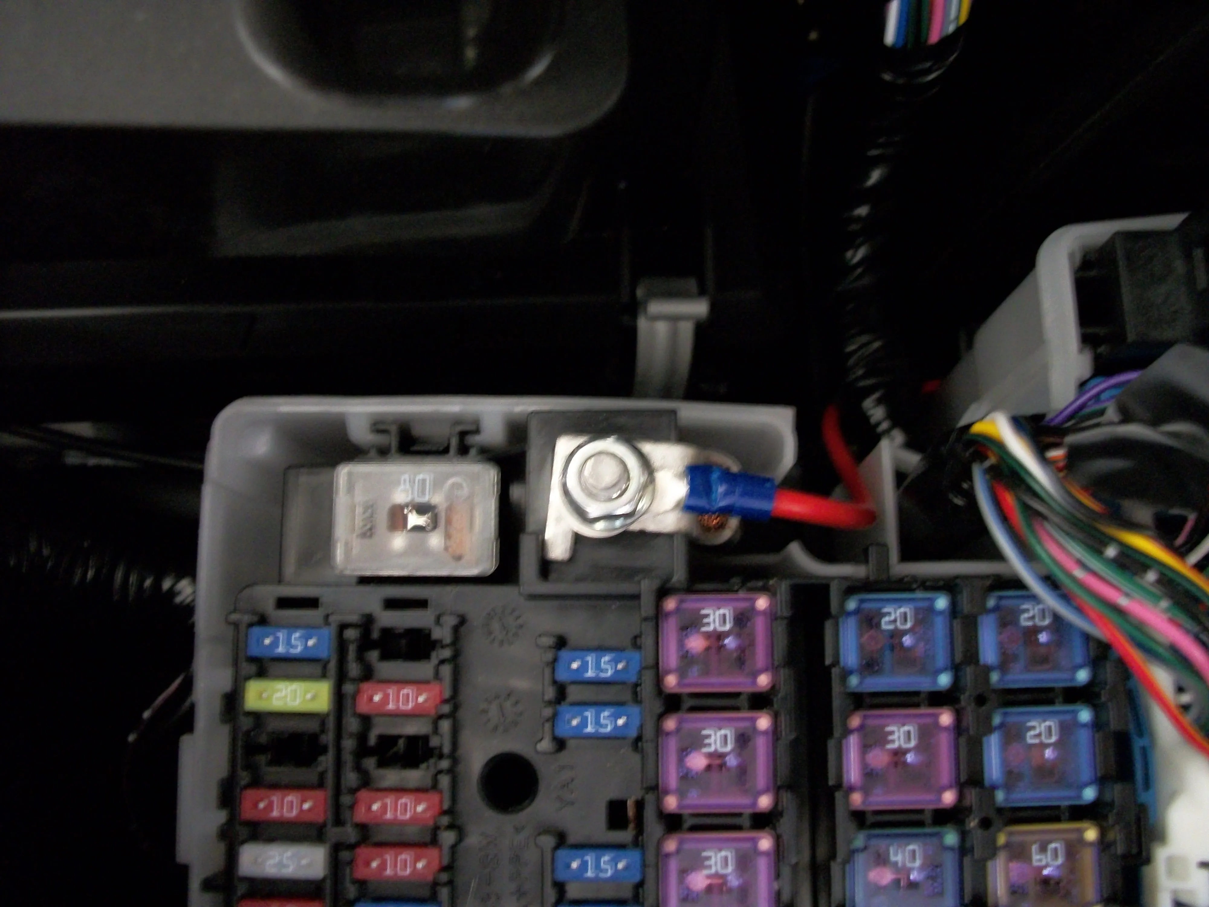

Finally, the red wire is connected to the engine compartment fuse block. Connect to the point where the battery cable connects to the fuse block. Use a 10mm socket to remove and replace.

I had included pictures below, but had to attach them differently, so hopefully they work well. First one is where the red wire attaches. Second is the high beam connection, third is the low beam connection, fourth is where the parking brake is located.
