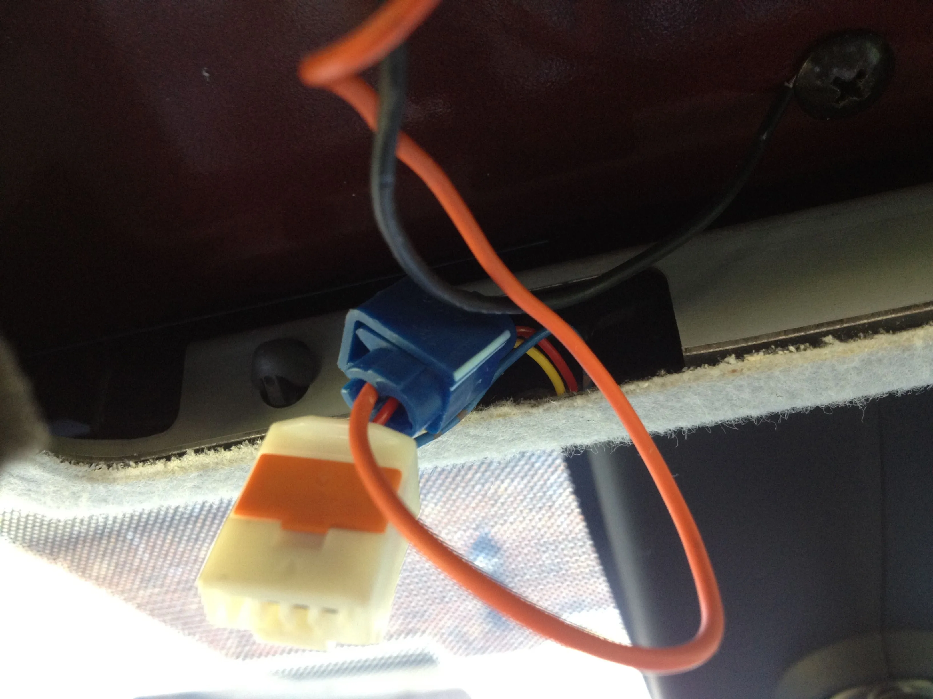

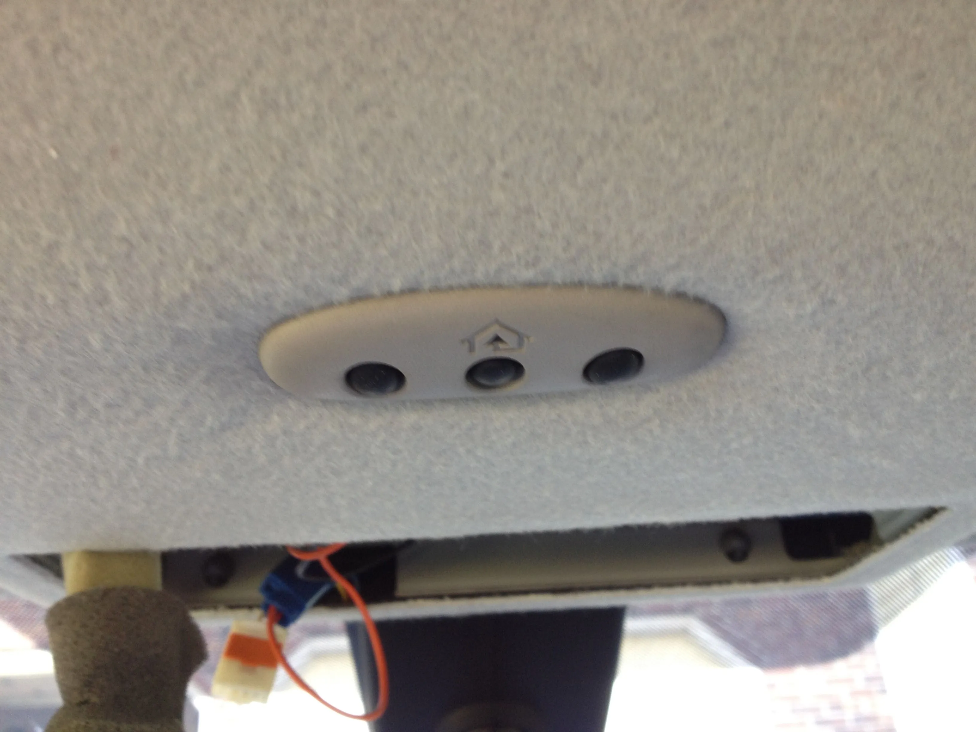

Grabbed a universal Homelink rolling code unit from eBay (normally goes in visor) and did a custom install.
Cut hole in roof, then hard wired it to the hot wire for the overhead lamps. Ground to body with existing hole in frame.

The unit has two wires, power and ground. Just use a test lamp for a constant hot wire, in this case it was the red wire going to the map lamps. Then I ground it to the body using the existing screw hole in the center of the roof frame.
The roof material is a bit thicker than what it is intended, a visor. So I had to cut away as much insulation around the hole as possible. The unit itself is very thin so it doesn't hit the roof. Plus there is a foam square on the other side. It's not flimsy at all, besides, how much pressure is needed to press the small buttons. There is room if you wanted to stuff a Styrofoam block wrapped in felt between the unit and roof for extra rigidity. But it is not necessary.

Just enough for the buttons to clear and the LED lamp. If I had to guess, 1"X2.5" or so.
The oval piece pops off and is held in place by two pegs on either side. So you put the unit in the headliner and push the oval face with the buttons onto the unit through the hole. Again, I'm sure there are easier/better ways to do this. I just did it where there was enough room and I had easy access too (having a sunroof helped big time).
