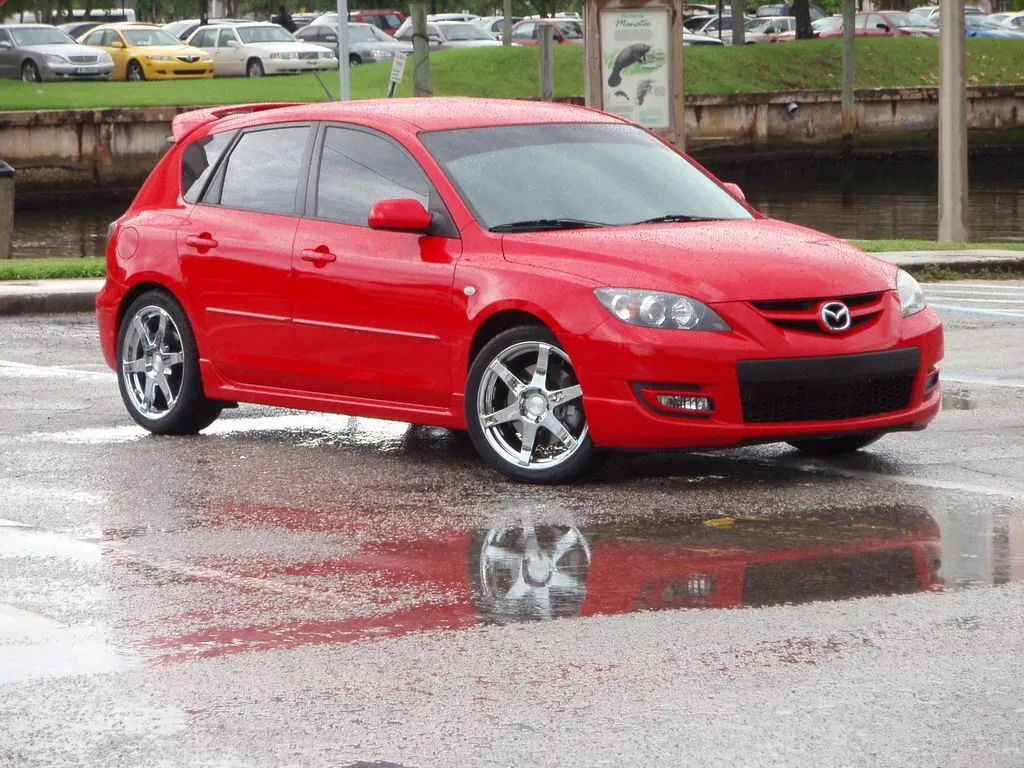

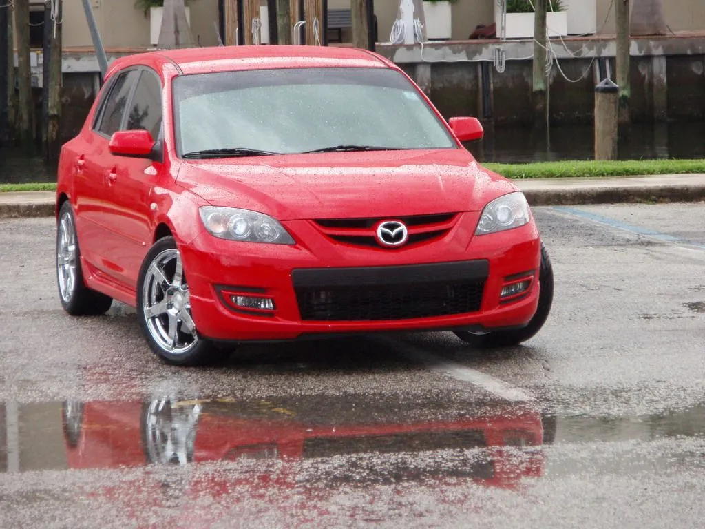

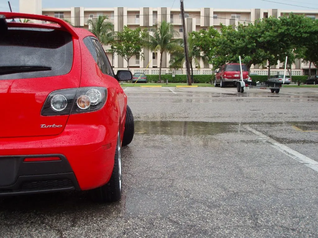

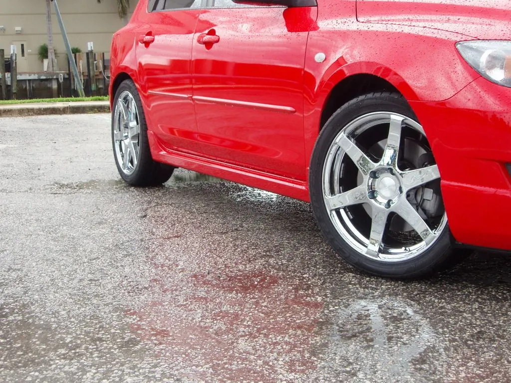

Here is a few photos of what a 235/40 looks like
