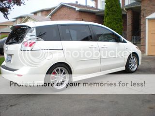

these are the j10's. I had cooper zeons 215/45-17's on but they stuck out to far in the front with the 42 offset.

Those are sharp! Was that "Hyper Silver" or something? I like the finish.
I find it really odd that a +42 with 215s would stick our farther than a 225 with +45. Unless yours were 8" maybe? The DR-42s are 7.5".

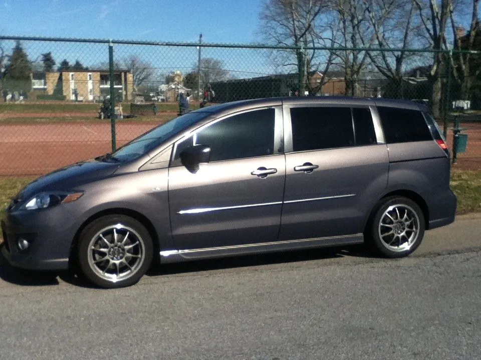

They were 17x7's though the offset was actually 38. Not sure what color to go with though... The websports were rpainted by the preveous owner and are not pretty at this point. the blue stickers are ok though. Lots of hand sanding is in store for this week. Im thinking something similar to yours though a bit darker of i can find the paint. Do you have front and rear shots on hos wide the tires look? Car looks really clean bu the way. (rei)
Still doesn't seem like a 7"@38 should stick out much more. Odd.
I don't envy the work you have ahead, but I'm sure it'll turn out nicely. I like the grey-on-grey with very different greys. The Galaxy is such a light grey that a charcoal really sets it off. I'd rather have the Metro Grey on the 5 and go with either a light or a black rim, but in the used market you take what you can find... Especially when you are looking for manual transmissions. Plus I don't believe Metro was available in '08 if it ever were on the 5 at all.

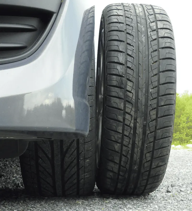

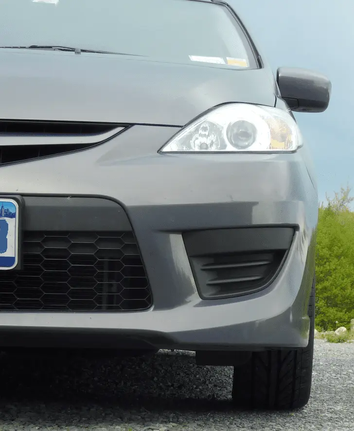

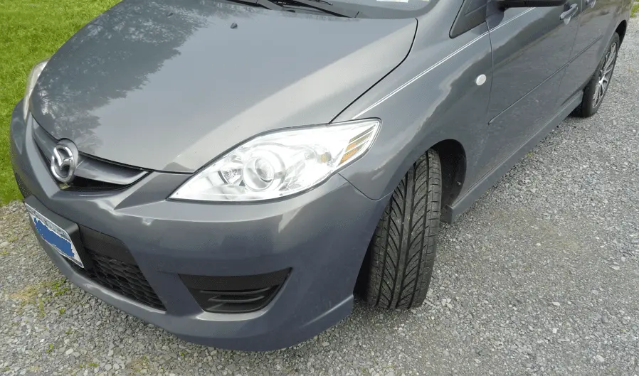

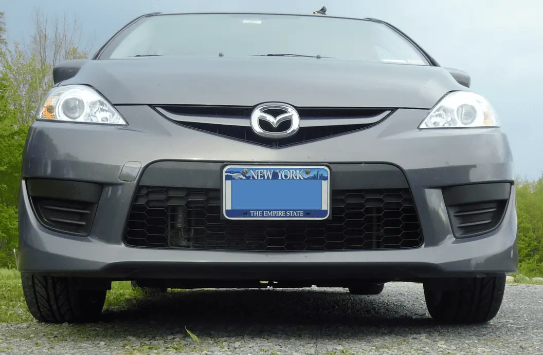

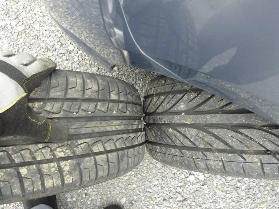

Finally pics of width
I'm only... Oh... A week late. Here are various shots displaying width.
front.webp Simple front-on shot
frontDriver.webp Closer shot of driver's front
frontTireCompare2.webp Next to stock size on stock rim
topTireCompare.webp Top-down shot of stock versus new (easier to see nearly 1" of gain. Also yes that is a slug that apparently is living in the void of the new tire...)
corner.webp pseudo-glamor shot of tire tread :)
Car's dirty, but it's been raining for about a week straight and whenever it stops for a second the pollen comes out and coats everything. Will wash this weekend!
