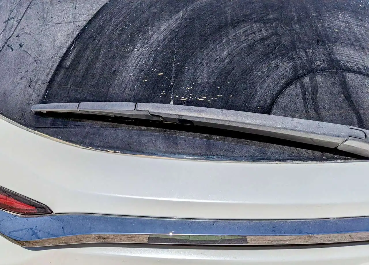

I have a 2019 CX-9 GT with 25K miles on it and this is what my rear wiper looks like in the parked position. Sometimes it is level with the ground but other times it's up a bit as in the photo. I don't' find it to be any big deal. Good luck.

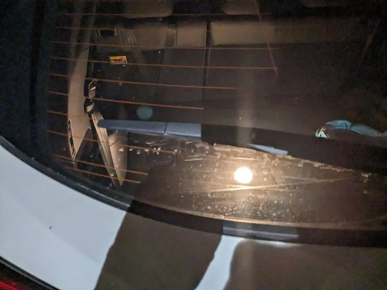

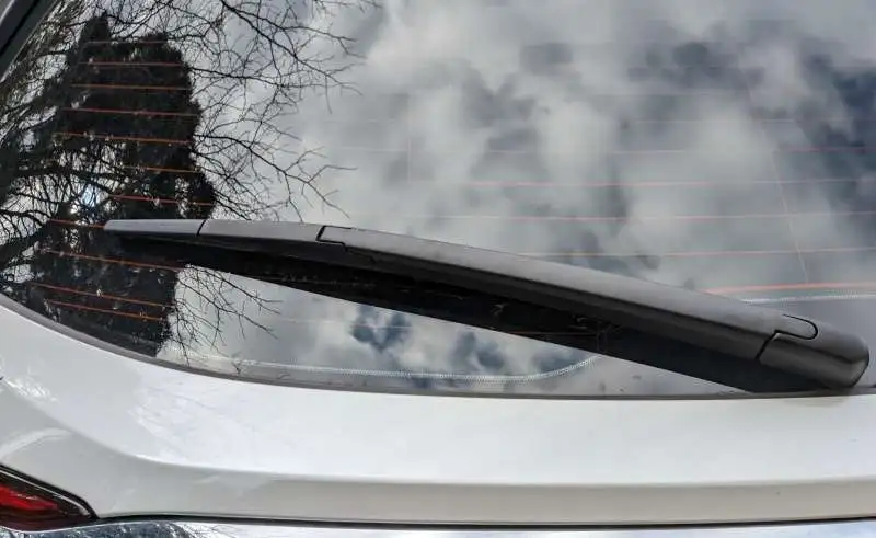

Another dealer said it's normal for the rear wiper to come to a stop so far up the window.
Attached are some photos demonstrating how high up the wiper sits.
Good view of the wiper when looking out the back.

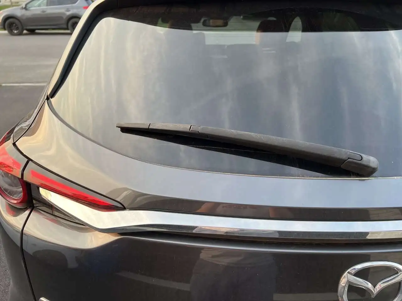

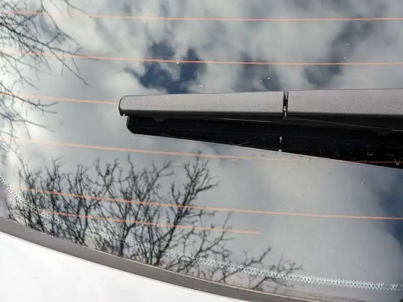

My 2018 does not stop horizontally either. I tried to compare with your heating element lines but they look different from mines. That looks normal to me:
I'll take a pic tomorrow morning when I get to the car, but I think mine isn't horizontal either.
