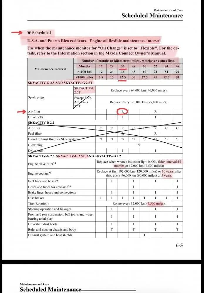

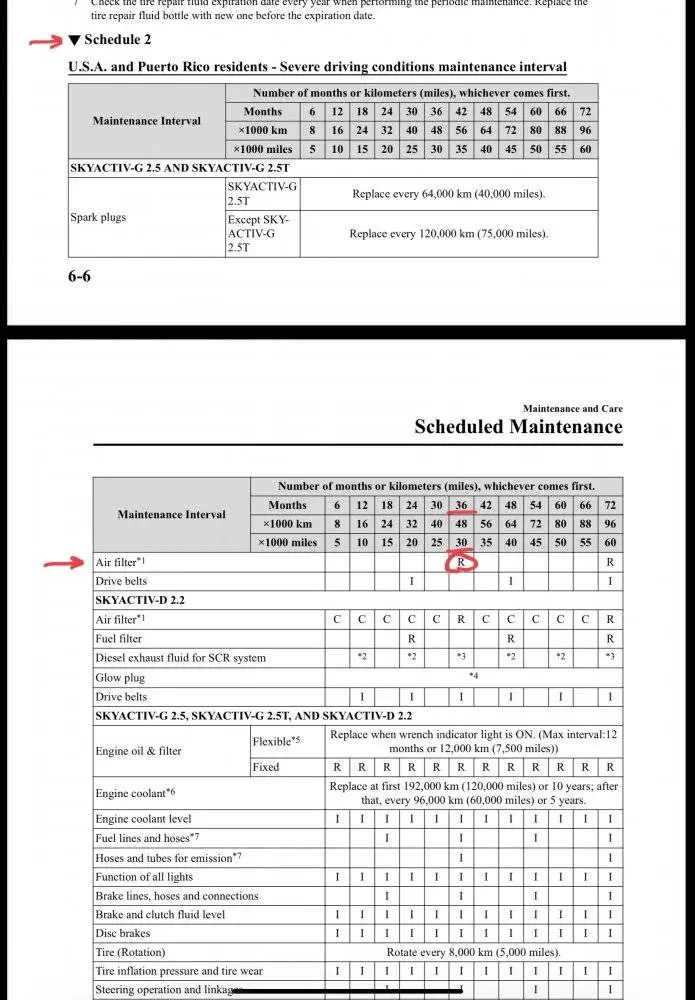

2021 CX-5 Engine Air Filter schedule 1 vs schedule 2 USA with typo?
My owners manual says to replace the engine air filter for schedule 1 at 36 months or 22,500 mi vs schedule 2 (more severe) also at 36 months OR 30,000 miles but that's more mileage lol is this a typo. See photos With red arrow.

Interesting.

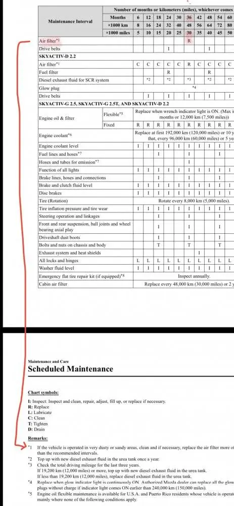

What does the *1 say on the severe schedule?
*1 for Schedule 2 (more severe) says clean or replace. Wow really cleaning it for a severe schedule lol
Funny that statement *1 should be applied to schedule 1 instead of schedule 2 (more severe).
