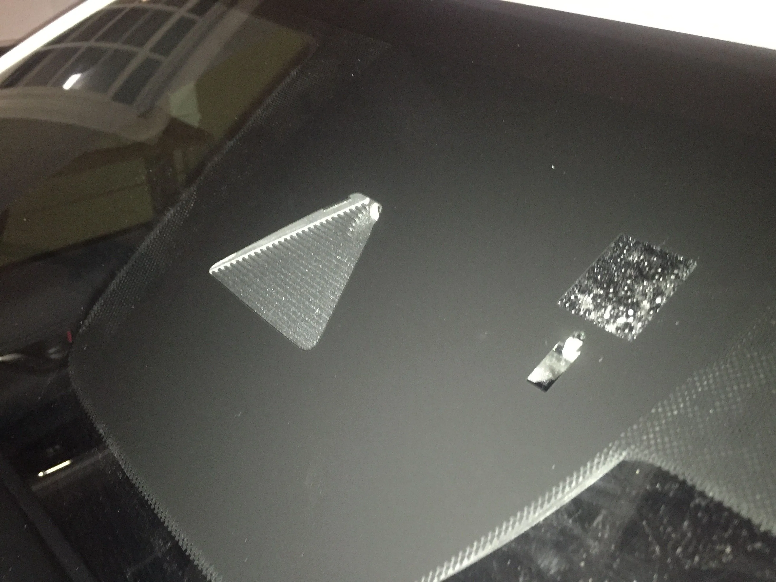

This is a picture of my windshield. Do I have enough sensors.

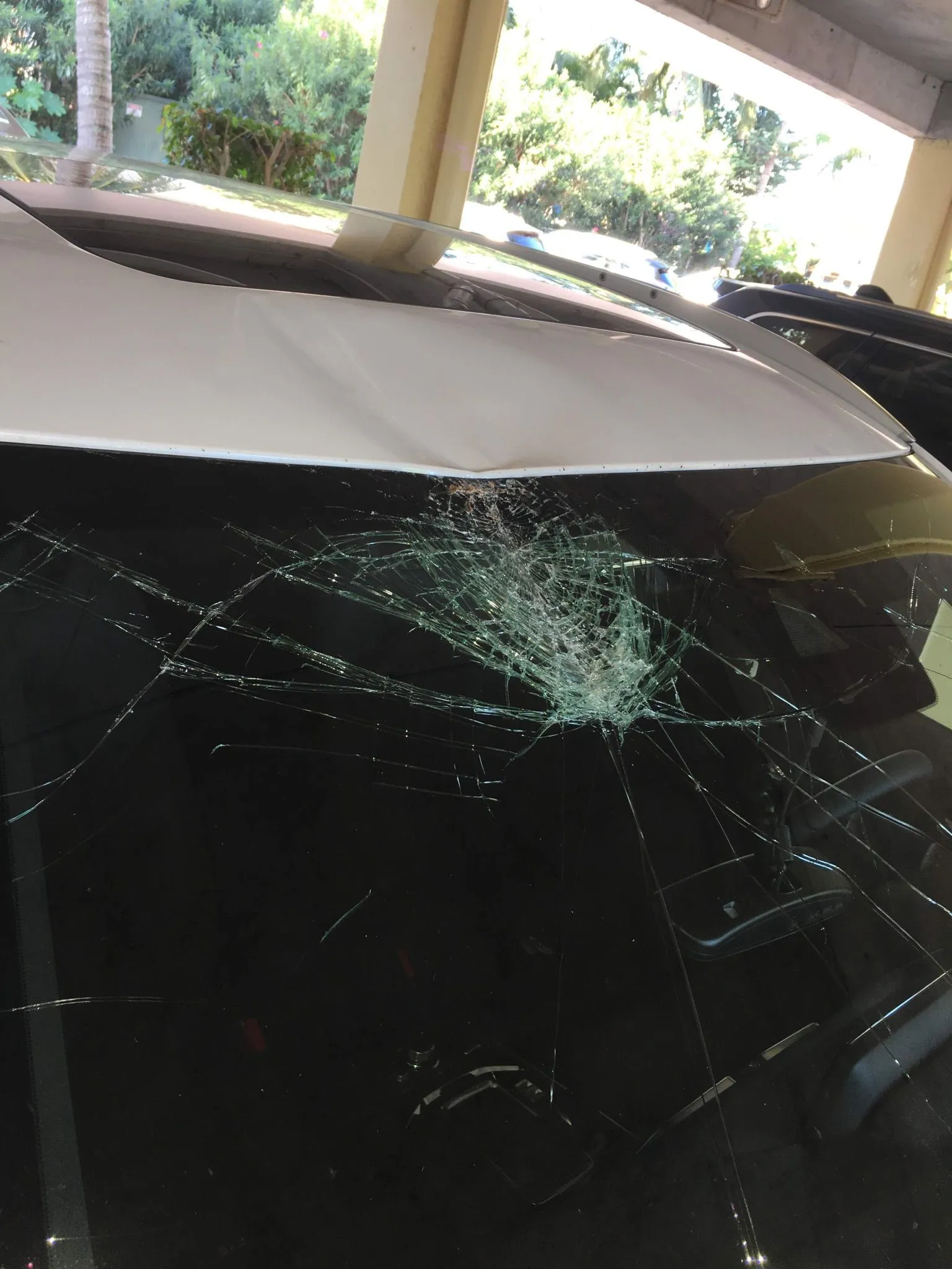

Also on the insurance , I had damage to the roof of the car, along with the windshield. We were driving down a palm tree lined street in Ft Myers Florida on a beautiful sunny day, and a palm tree branch fell and hit the car! Very rare incident , I assume. So far about $2,500 under insurance.
