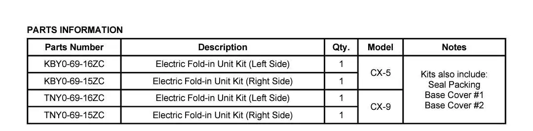

Thanks. Is this a Mazda kit or aftermarket? I'd tackle this repair for $50.
Here ya go!
  • MC-10226894-0001 (4).pdf
