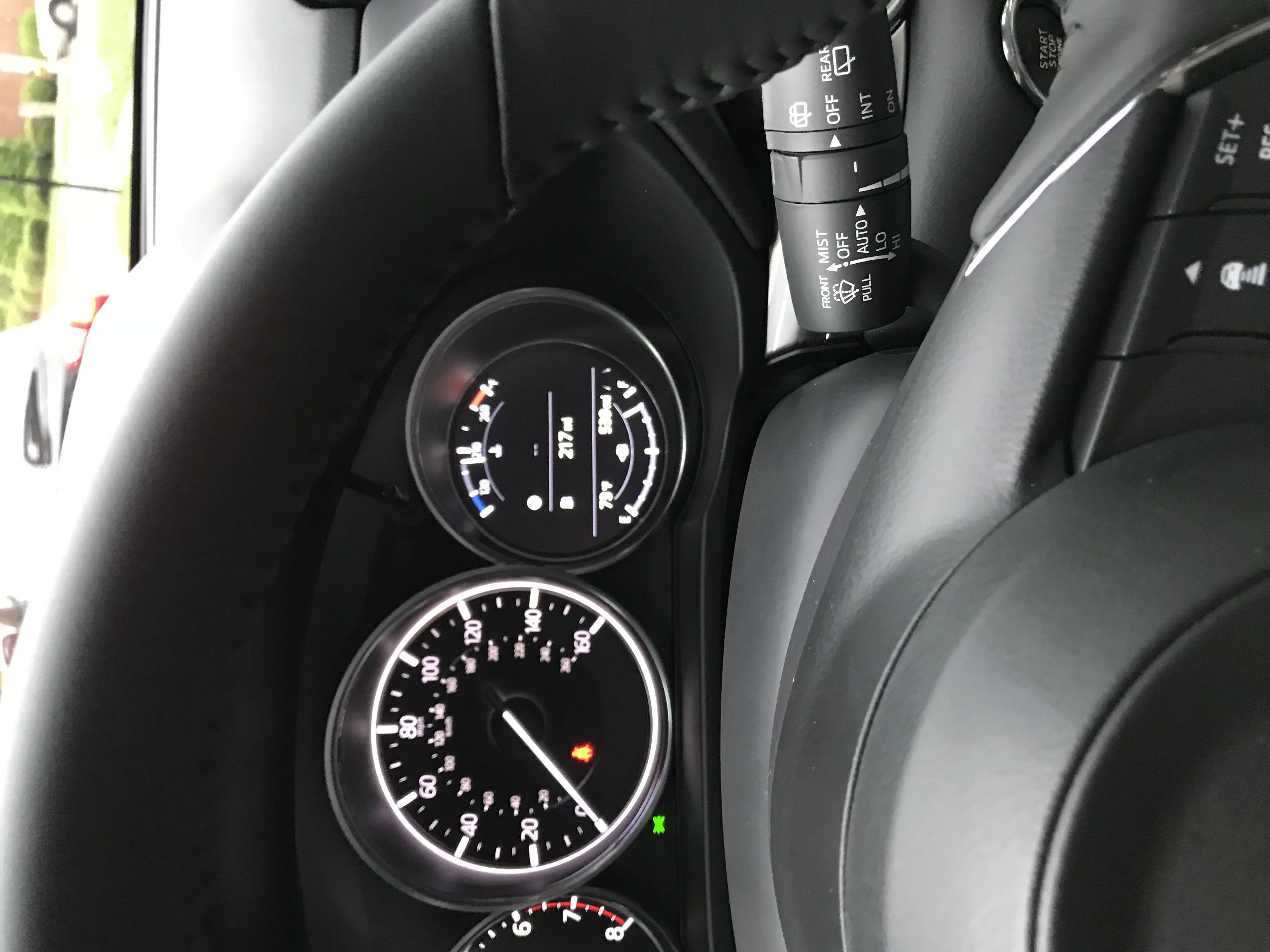

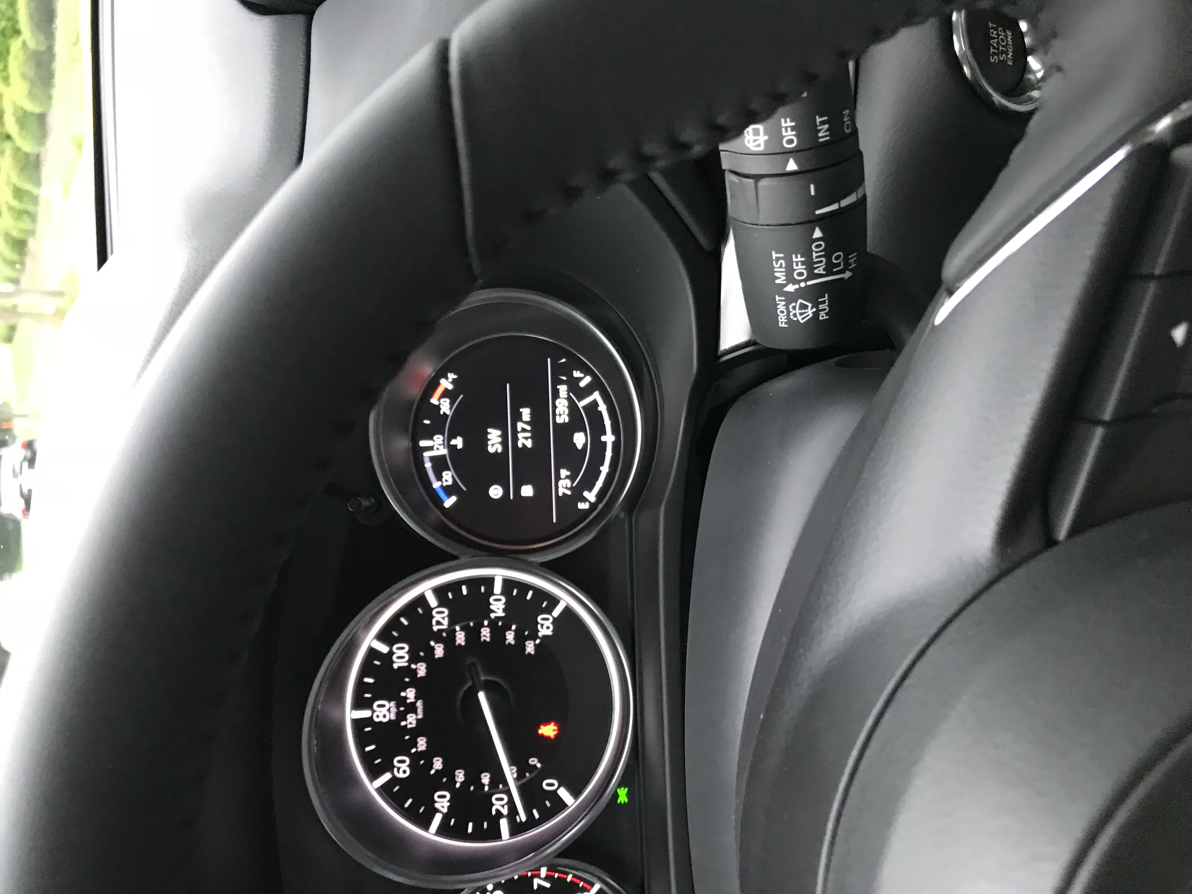

2018 GT - Compass in MFD

I believe the OP is talking about if you've been driving and come to a stop at a light, stop sign, etc. the compass stops showing your direction till you move again. At least this is what happens with me. Not a big deal but if you're going one direction you'd think it would just continue to point that direction till you move or turn off the car.

This is exactly what I'm talking about. Every car I've owned that had a compass (not NAV) would stay on while stopped. That way when you looked at a map you knew what direction to go. Think about it....how many times have you stopped for directions in the past (before NAV) and someone or a map would say go North, South, East or West on a particular road? I want the ability to look down while stopped and it say what direction I'm facing...not have to remember what it said. It's not that big of a deal but annoying none the less. Good to know it's not just me....I hate going in for service! Last time I went they stained my parchment seats and I had to point it out for them to fix.
