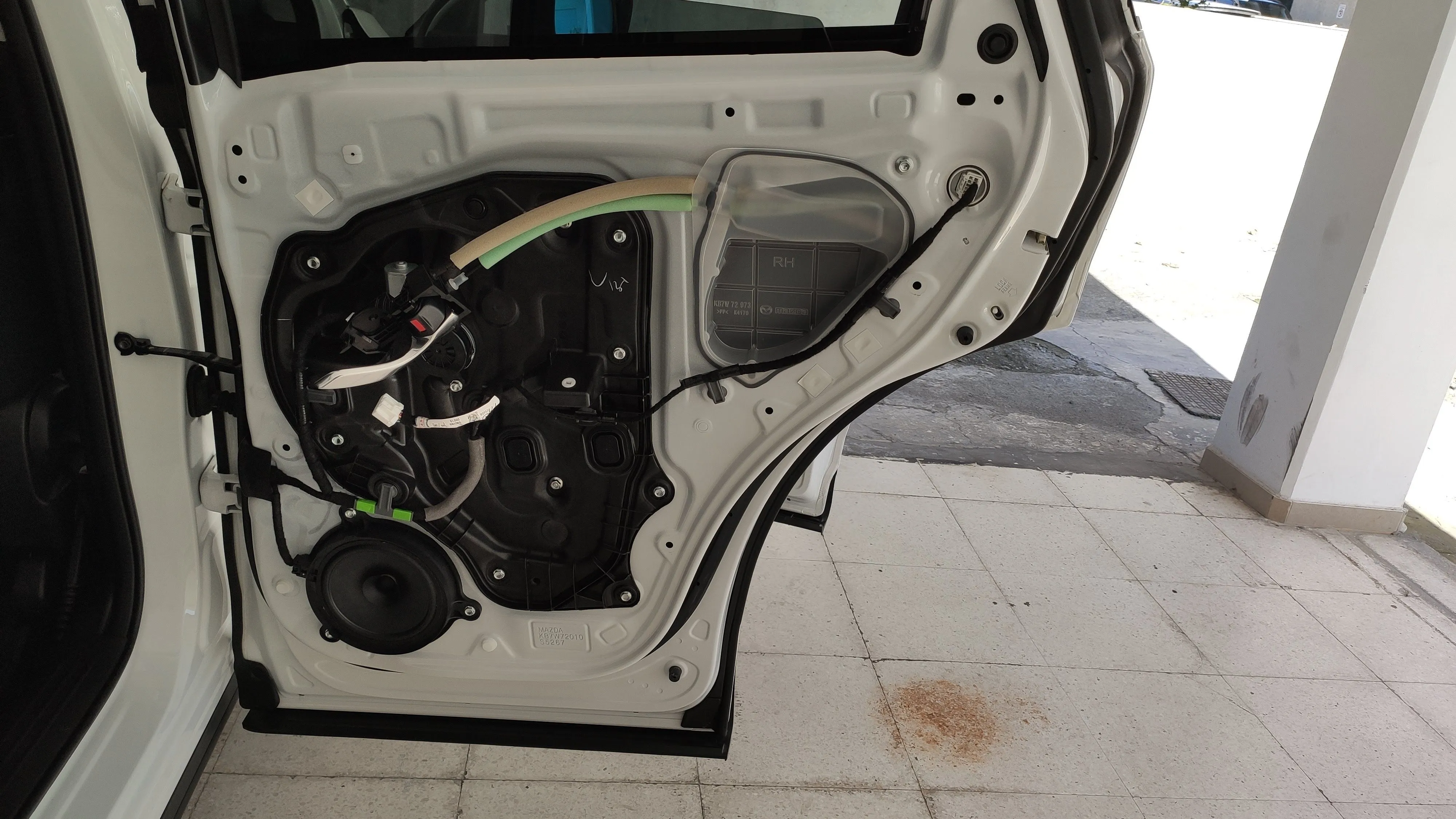

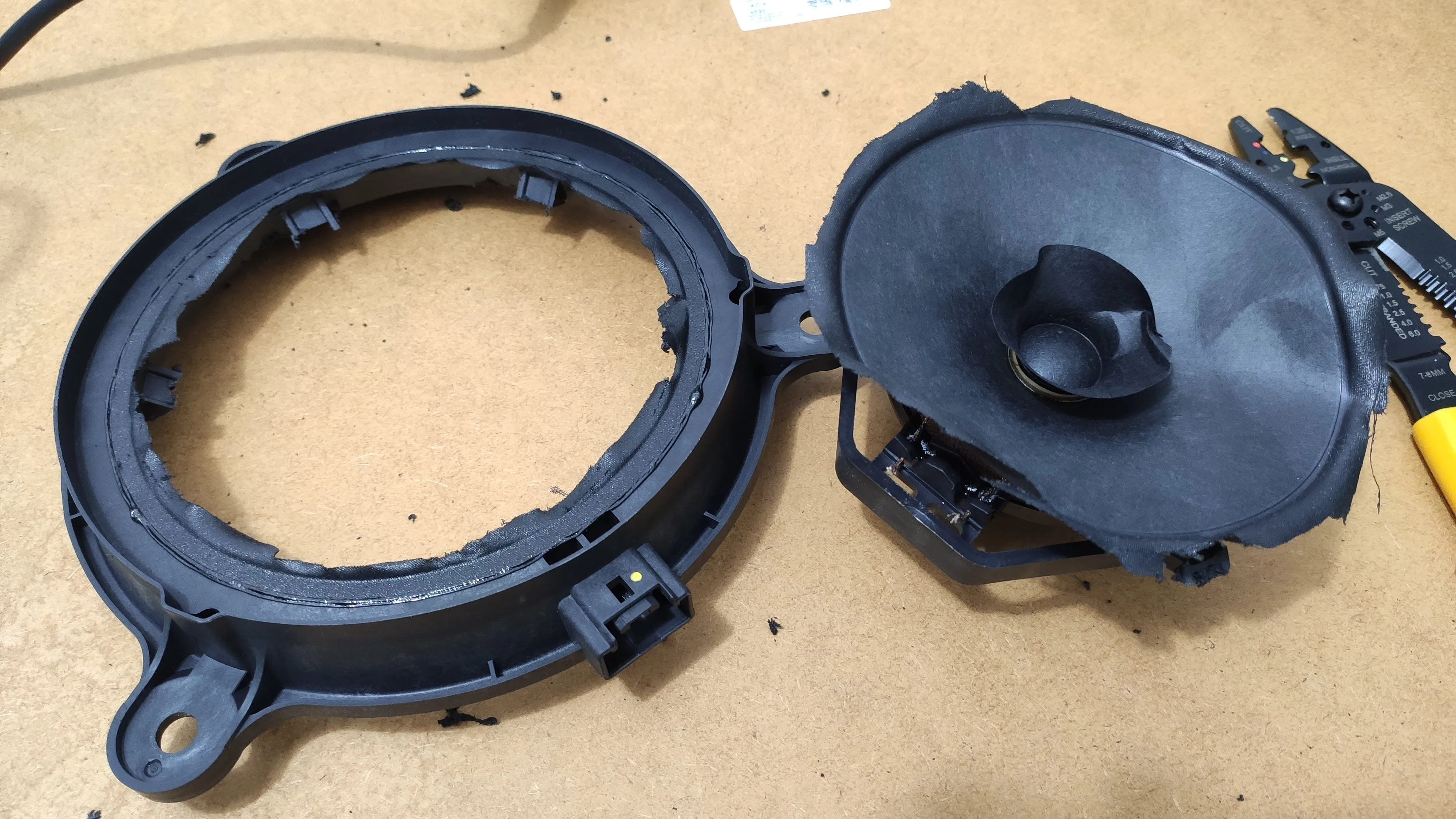

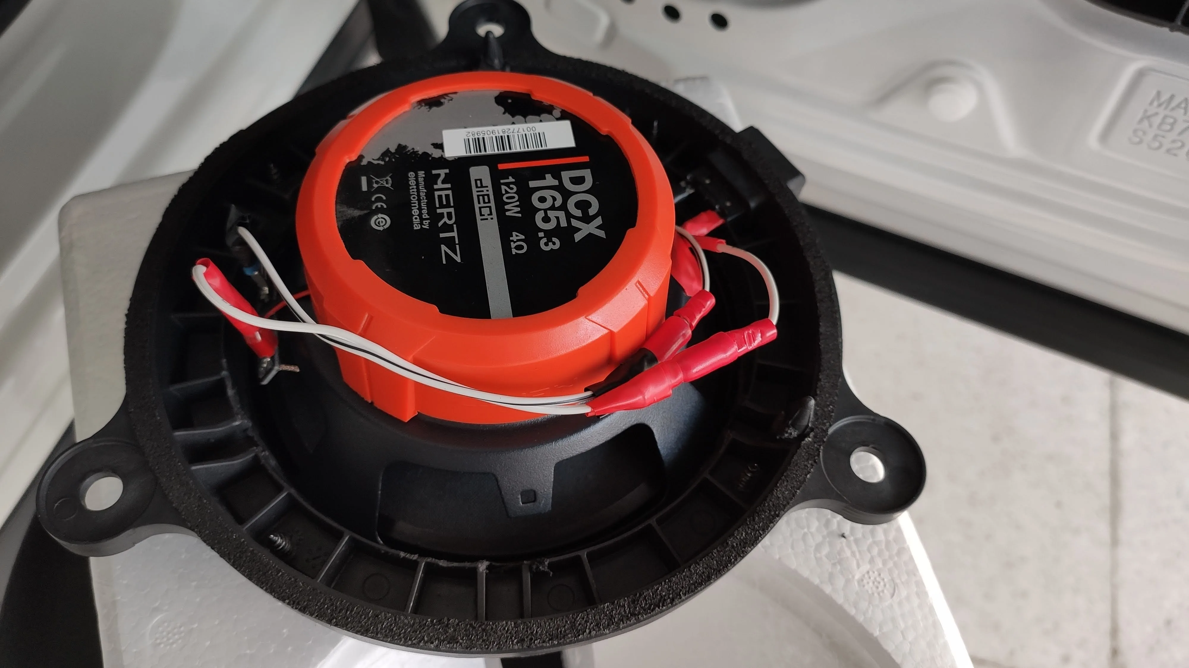

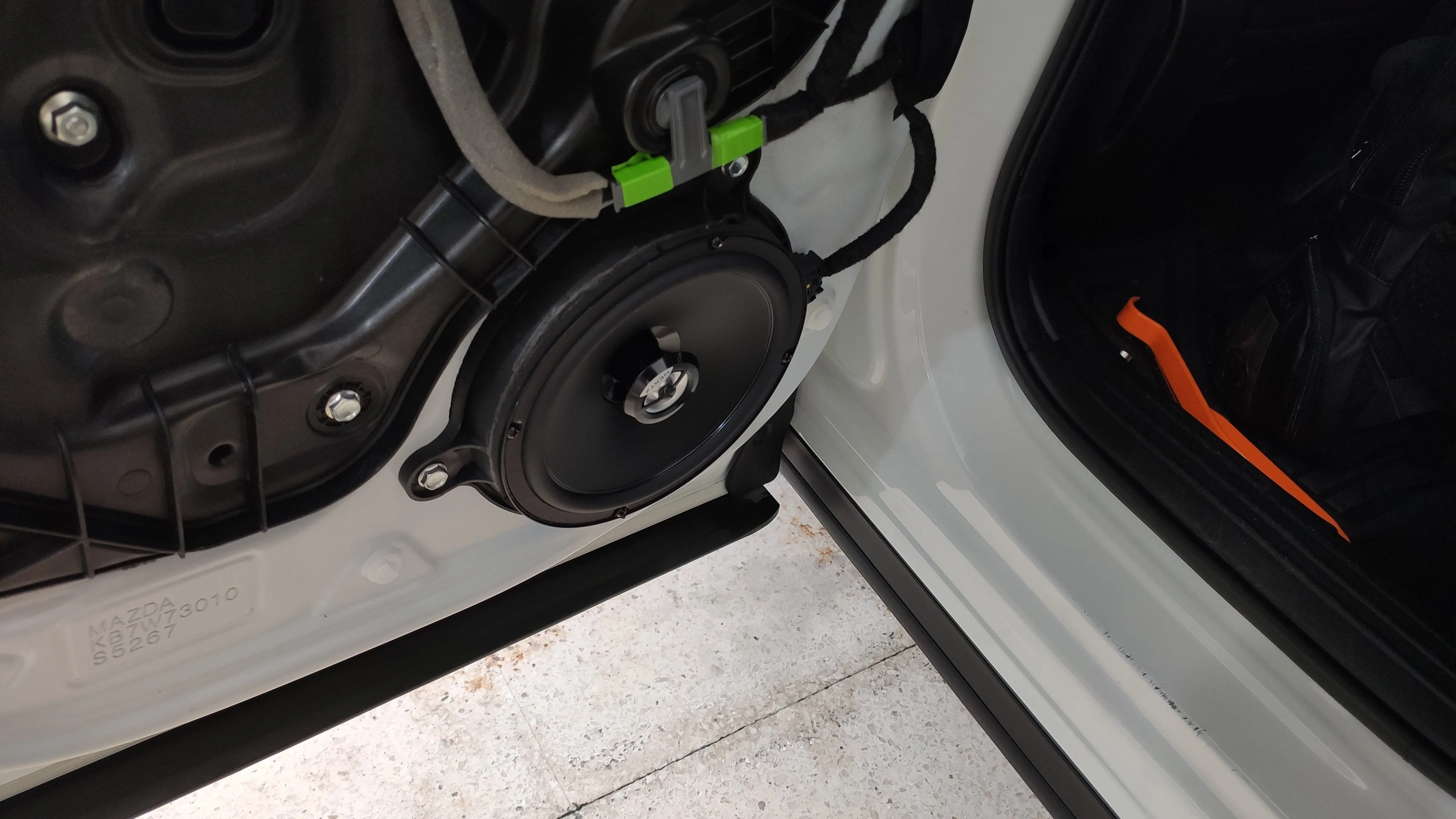

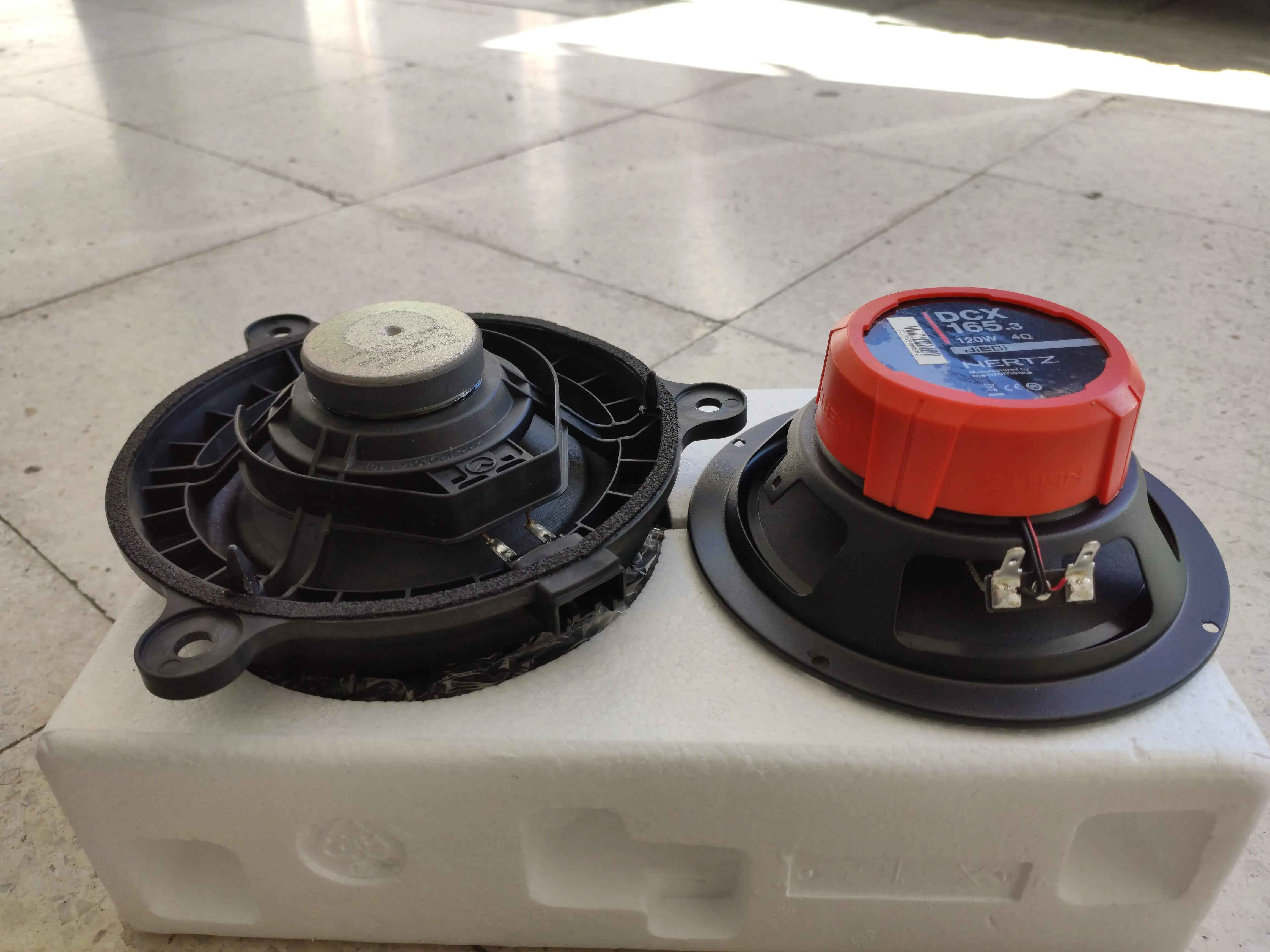

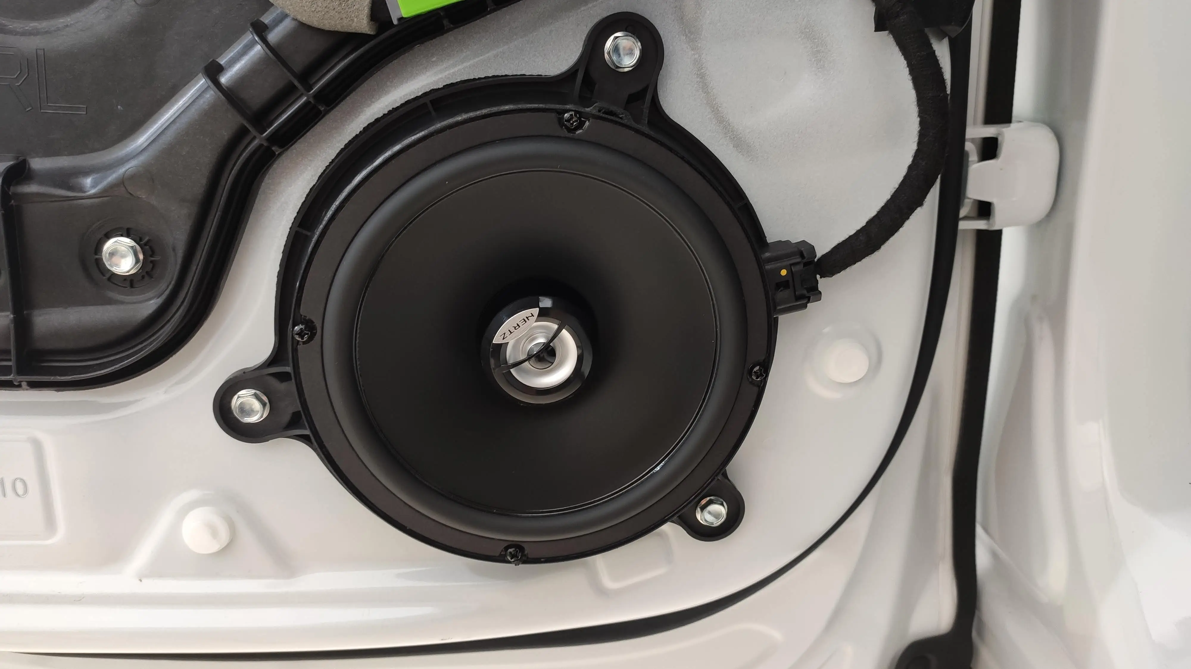

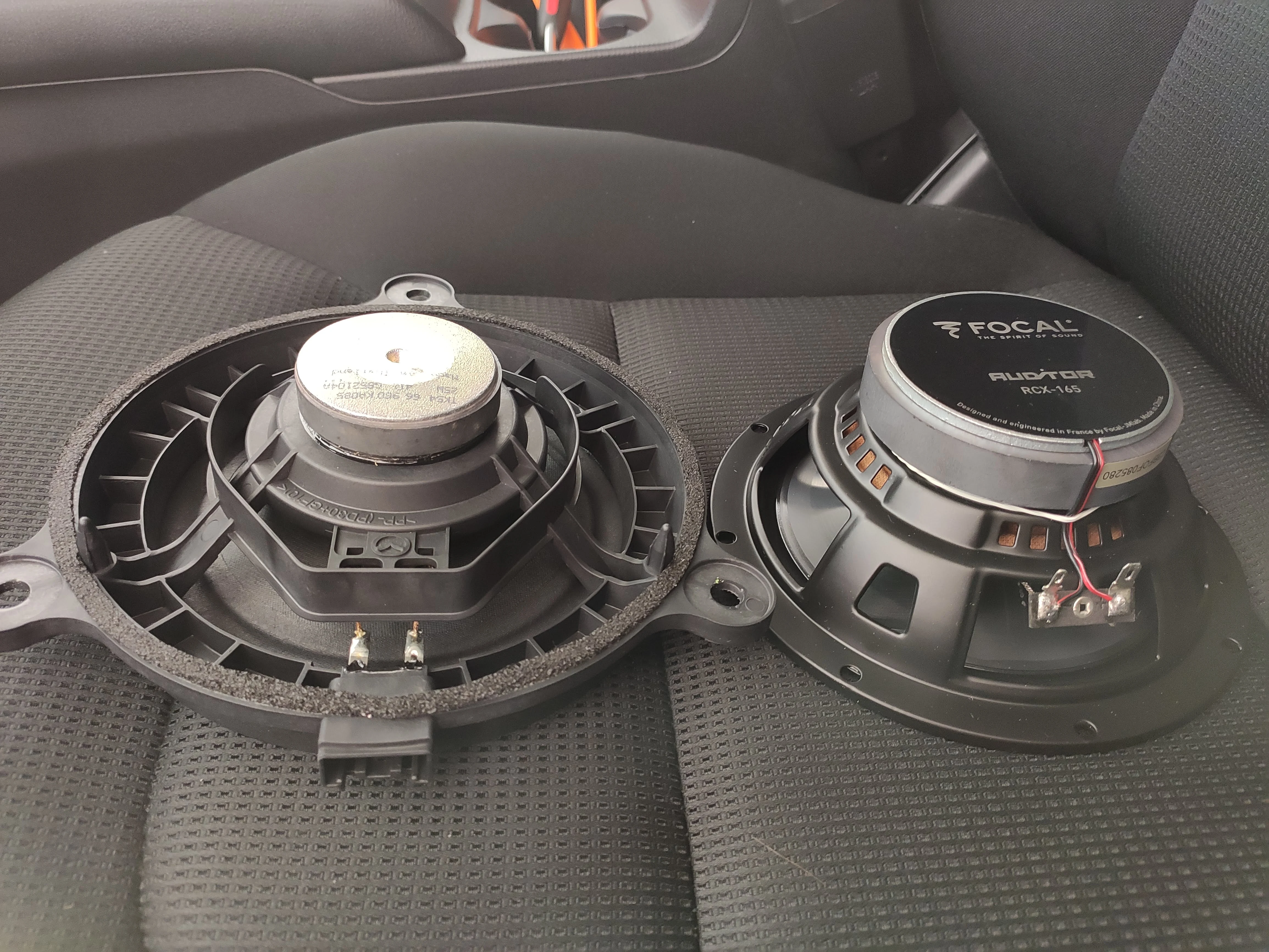

Hey guys,
So i went ahead and bought 2x Focal RCX-165 for the front and 2x Hertz DCX 165.3 for the rear. I know it's not optimal, but i couldn't decide between the 2.

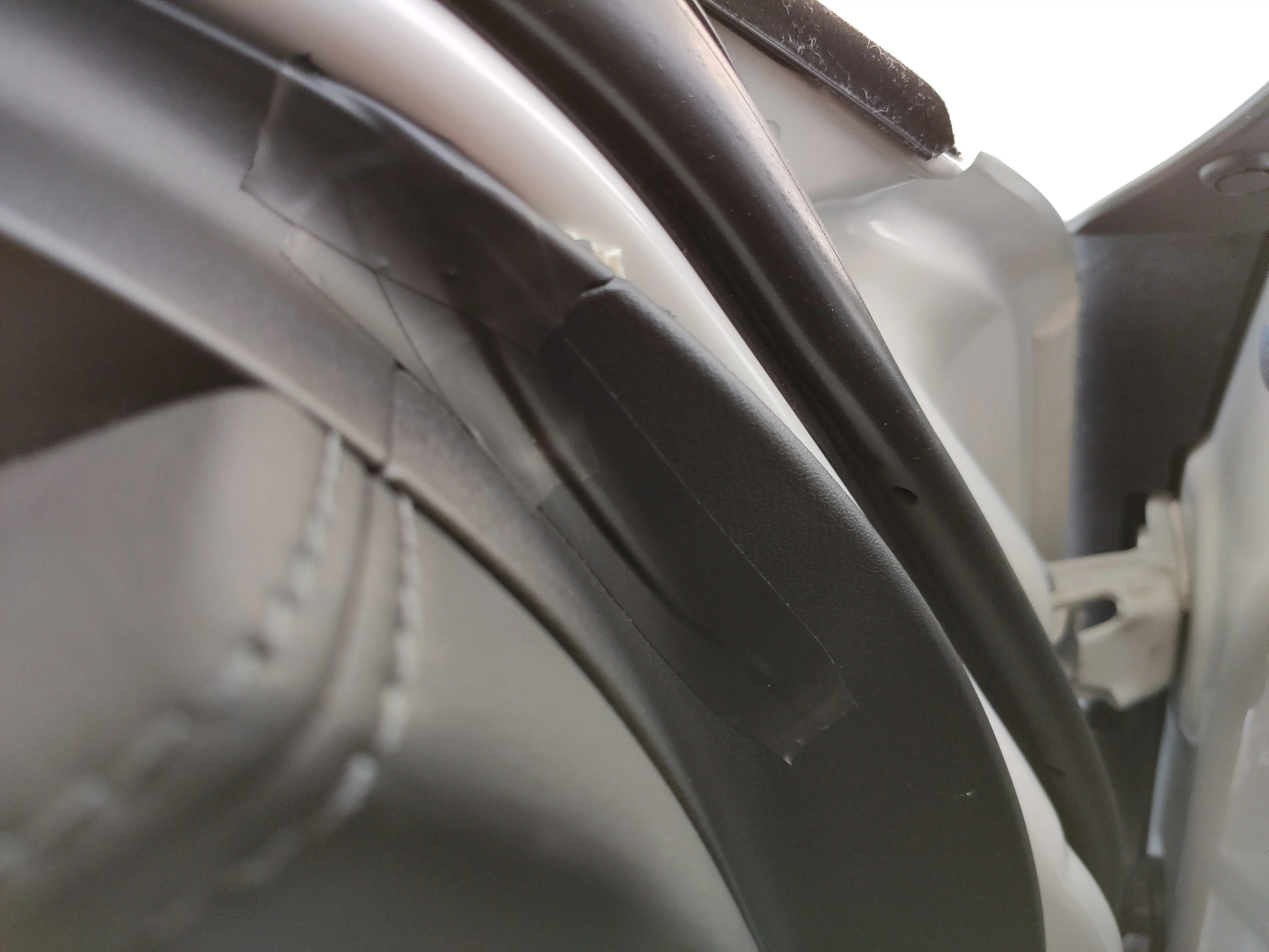

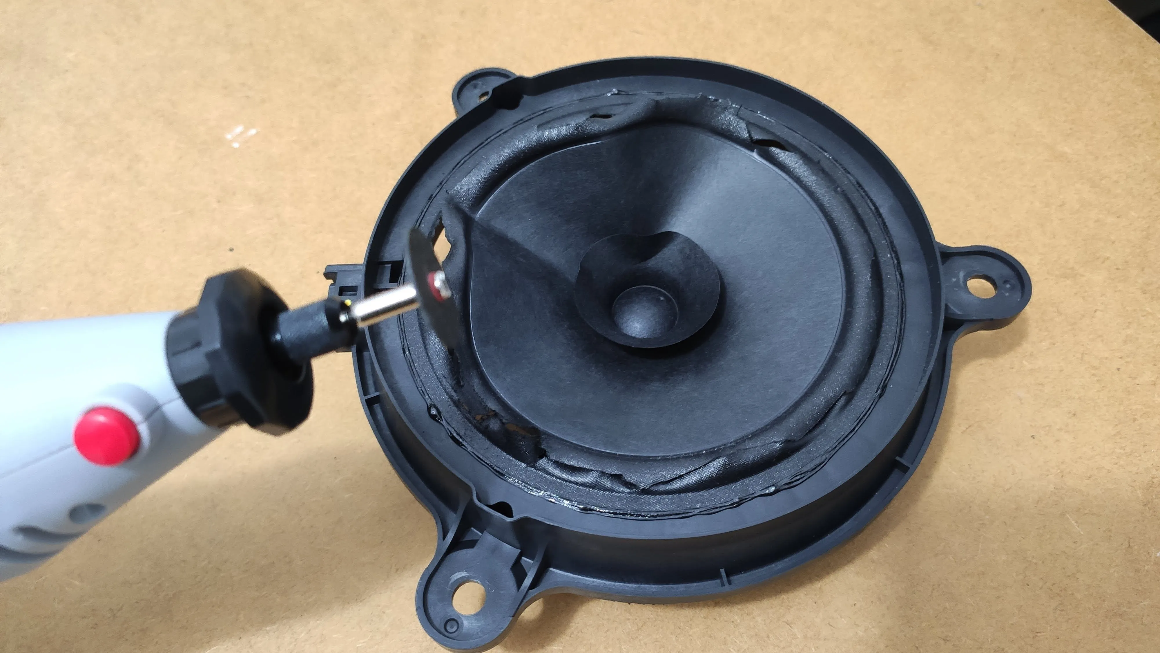

I am crafty enough, so I did dremel the original speakers and used the frame for the new speakers. Everything went almost perfect until the last door, I broke the panel in the inside corner(yeah I'm stupid), you'll see it in the pictures, I put some electrical tape for now until i put some black adhesive.
I also broke a few of the clips but i had extras.

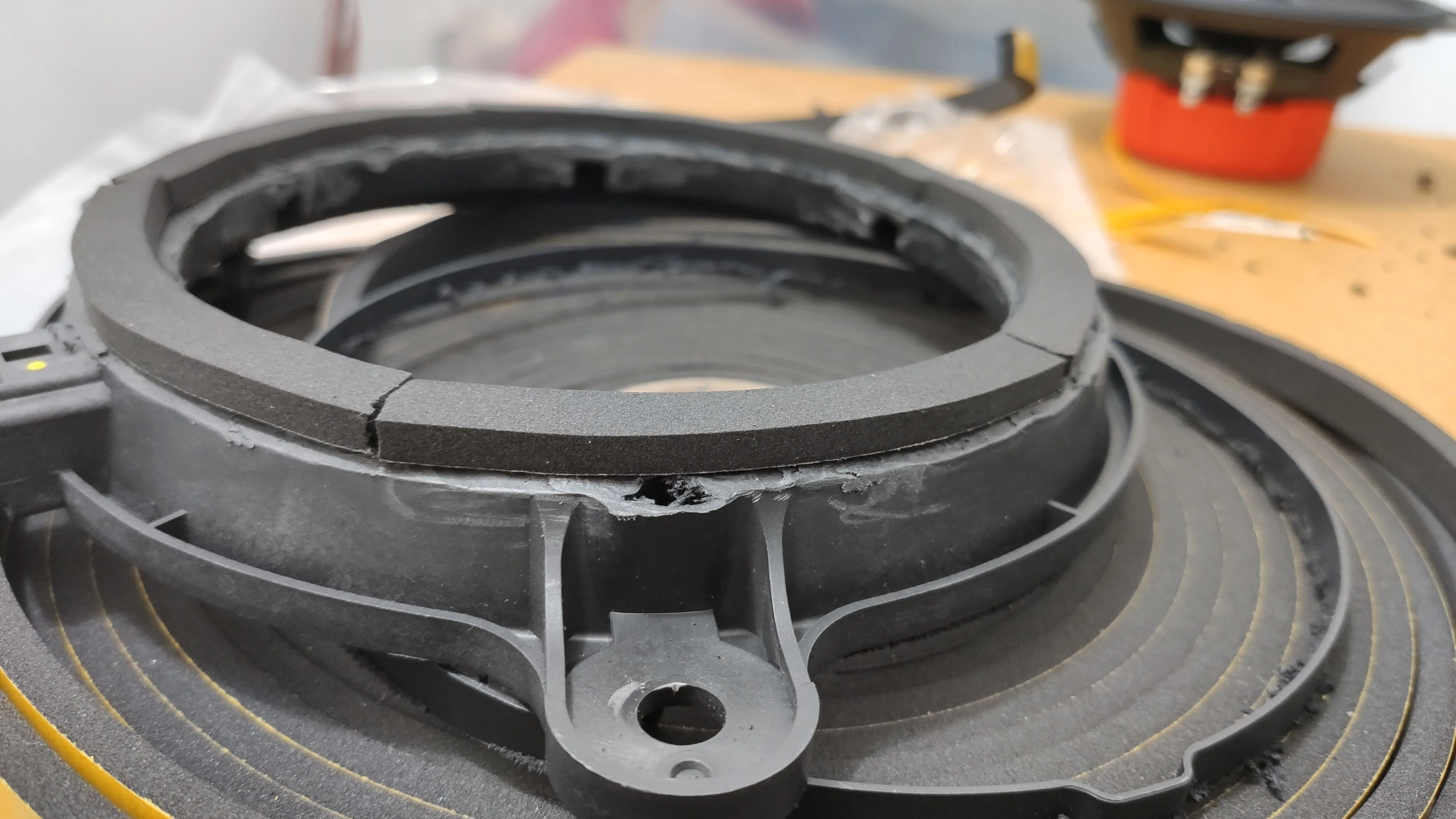

I also added an adhesive foam strip between the speaker and the frame to seal the connection a bit better, instead of putting the speaker straight on the plastic.
Now, the speakers are much better than the factory ones, especially highs and mids, the base even went down a little, but it's much cleaner and punchier, but anyway it was already too much.
In general, the clarity is way better and quality wise you hear the difference.
If anyone has any questions i'll try my best to answer them.

Not sure if combining the two brands is a great idea. Did they have the same dB sensitivity figures. I wonder why you did not get better base. The hertz are great in producing base imho.
Hi raj55,
I edited my post, added the below comment:
"As far as the less bass on the new speakers, I didn't describe it correctly. After I went for a ride now and listened to more music, i realized that the bass is there, but a lot cleaner and punchier, it doesn't "drag" as long as the factory speakers."
Regarding the different brand, I know it's not optimal, the Focal are indeed a little better, even with the lower sensitivity of 91.5 vs 93 of the Hertz. The Hertz where almost half the price though and didn't want to invest that much for now, since I'm sure that at some point I'm going to be upgrading to a full Amp/speakers/subwoofer system.
Thanks for your input though, appreciate it!

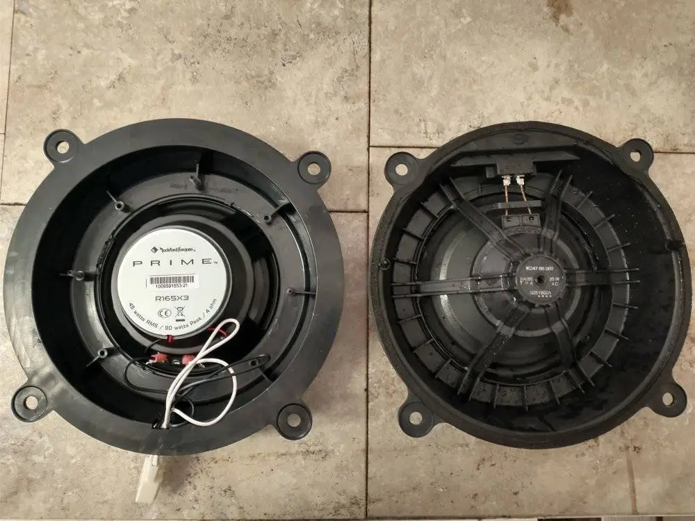

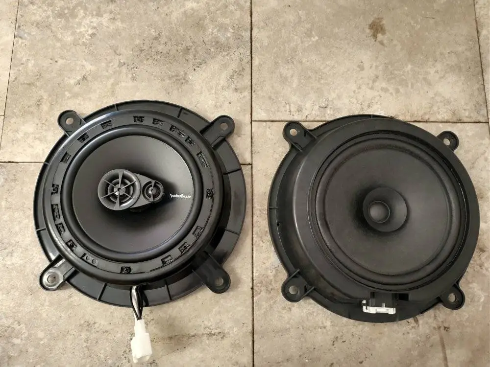

Does anyone know the stock wattage and impedance of the door speakers on non Bose 2018? I’m trying to get louder vocals without installing a second amp (my subwoofers are drowning out the vocals, and I don’t think electrical would like a second amp to power more speakers.
Little to nothing. 20 watts? 30 max? The magnet assemblies are the size of about 3 York Peppermint Patties stacked on top of one another, and I'm not making that up.
Rockford Fosgate Prime 6.5's, which don't have larger magnets at all, as they are $40/pr entry level speakers, vs stock.
Perfect Ty. That shows me exactly what I was looking for. 25w @ 4ohm stock. So figuratively I should be able to double my power by going with a 50w+ 2ohm speaker.
